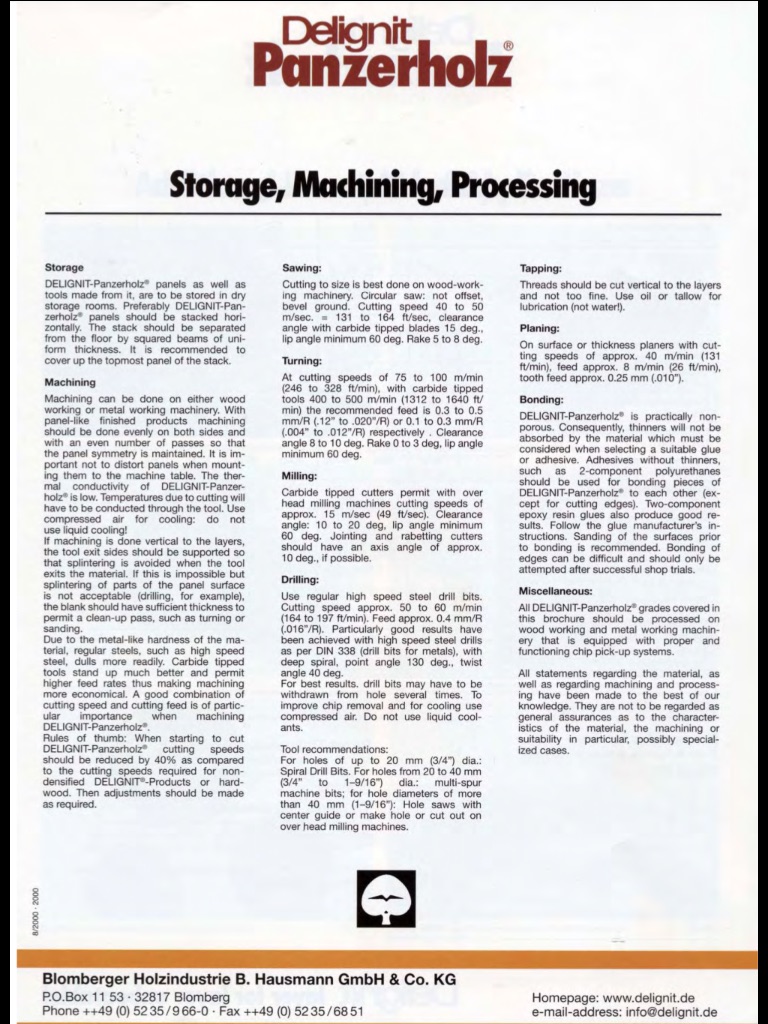

Andrew, the salesman at ltlewis, sent me info on cutting and tooling this morning

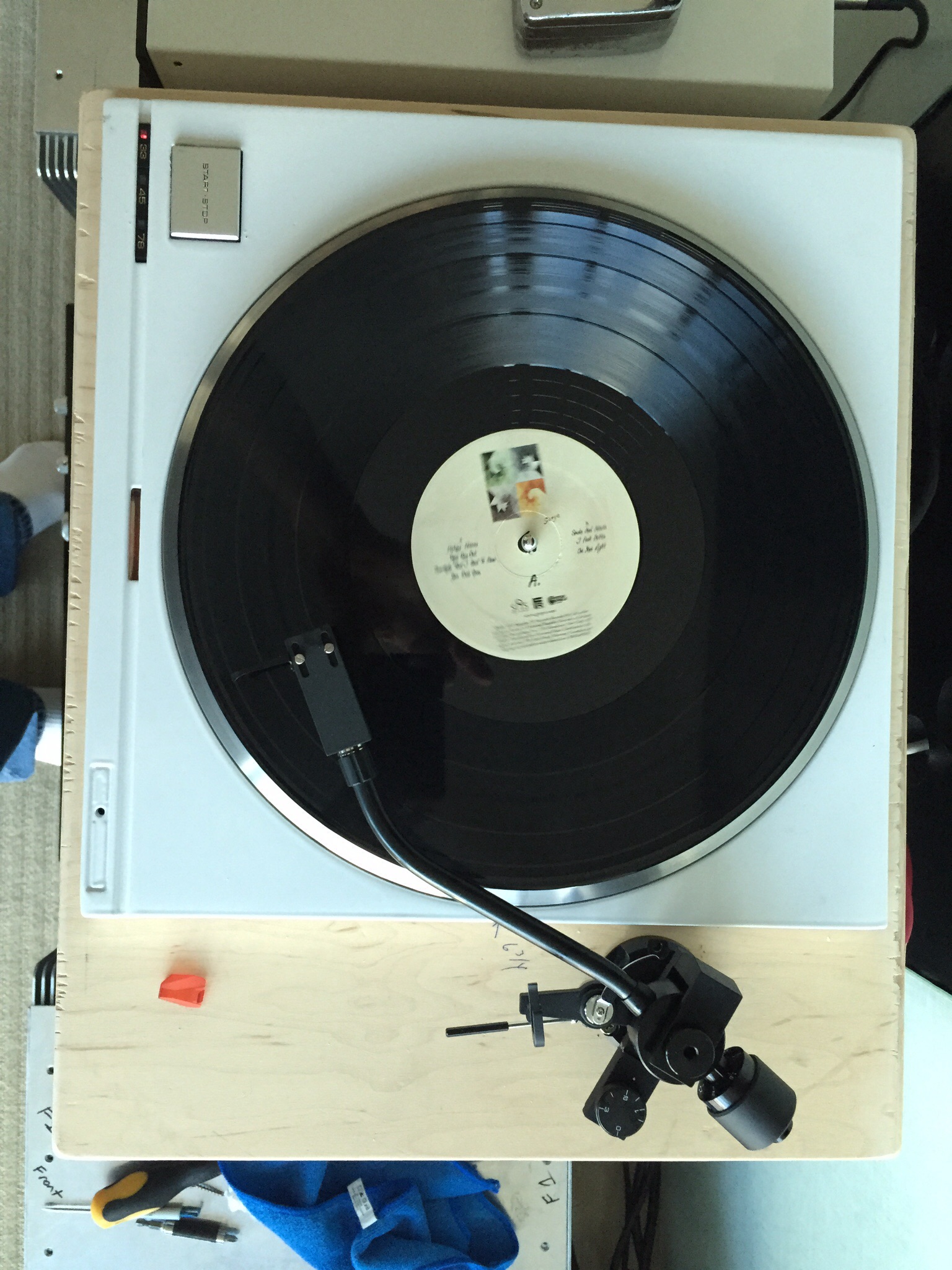

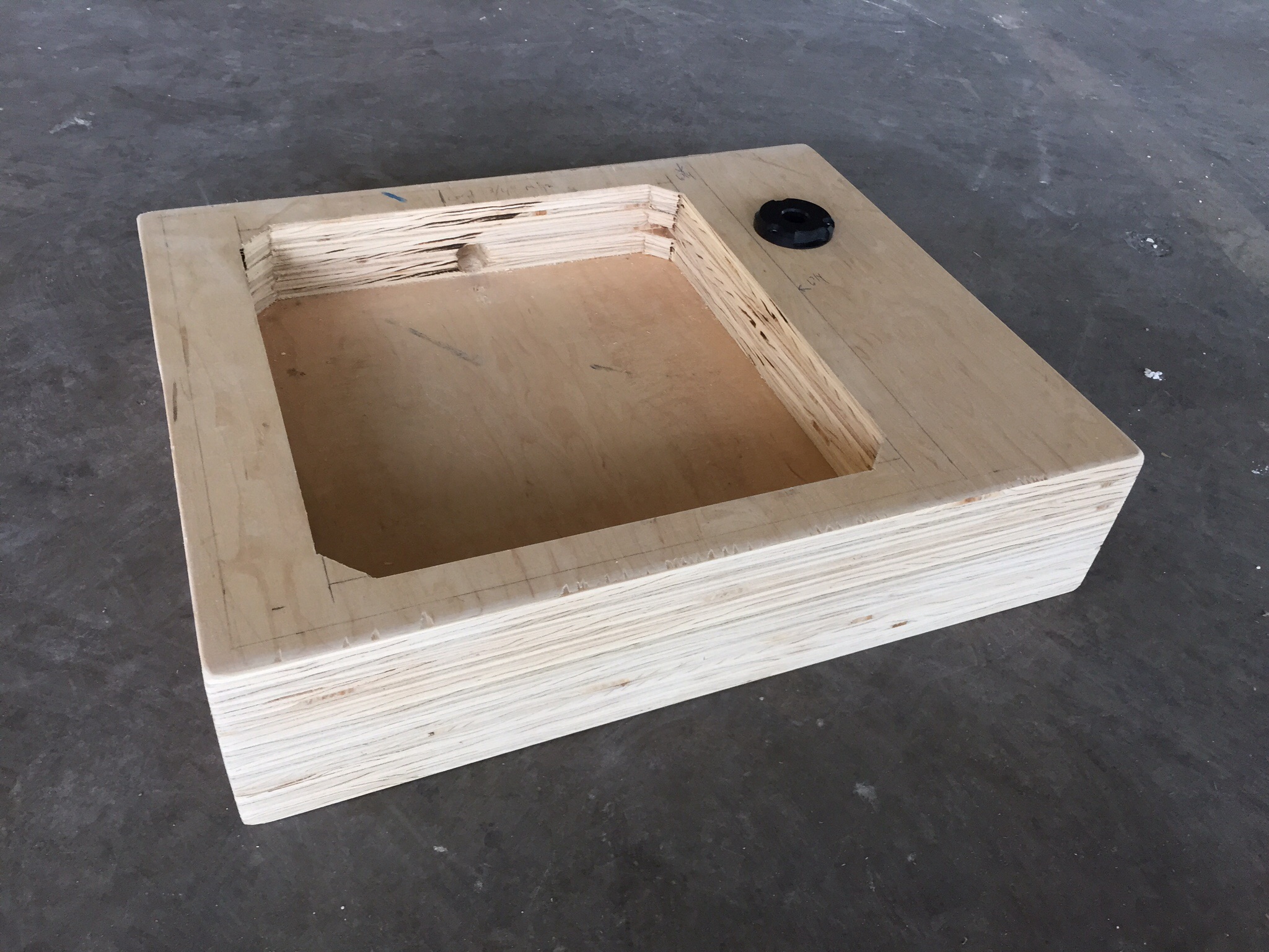

Not much going on at work today so I made a quick 2 hour mule plinth so I can test each phase of the rebuild.
6 layers of 3/4" (19mm) birch ply, 19 1/2" x 15 1/2" (495 x 394mm)
I have a Jelco 750 (9") that I will use for starters. Only 2mm difference in mounting distance different from the 4points Kuzma that I might use eventually.

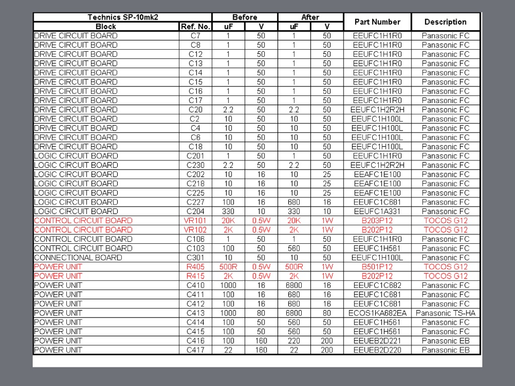

Coast -- if the trim pots aren't sealed units, I'd replace them as the open type often used in the era tend to get flaky over the years. At a minimum, 'exercise' yours by twisting them left/right maybe 20 times. (be sure to return to the original setting, either carefully by eye, or by measurement.).

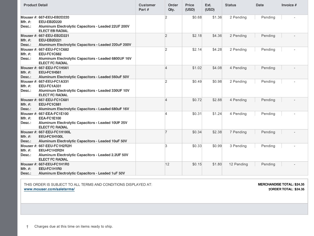

I ordered new caps for the table and power supply (ordered 1 or 2 extra of each)
Ordered a new thrust pad from Steve here on the forum (theanalogdept.com)
And Anderol465 for the bearing. (eBay) ISO Grade 68 synthetic.
