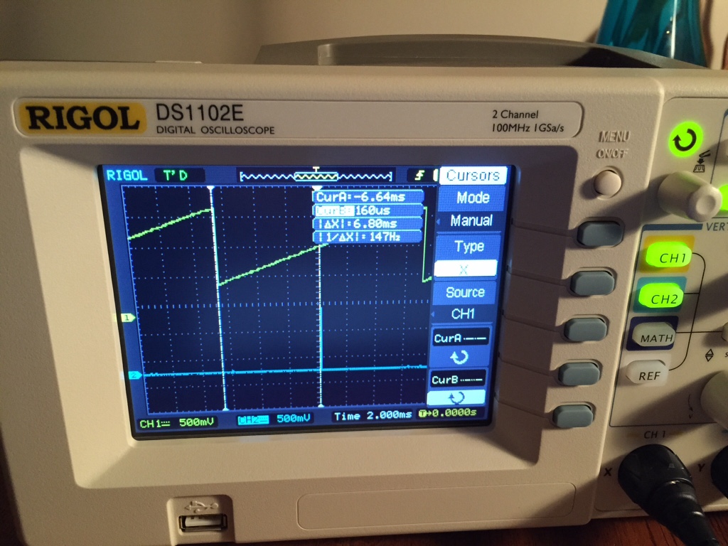

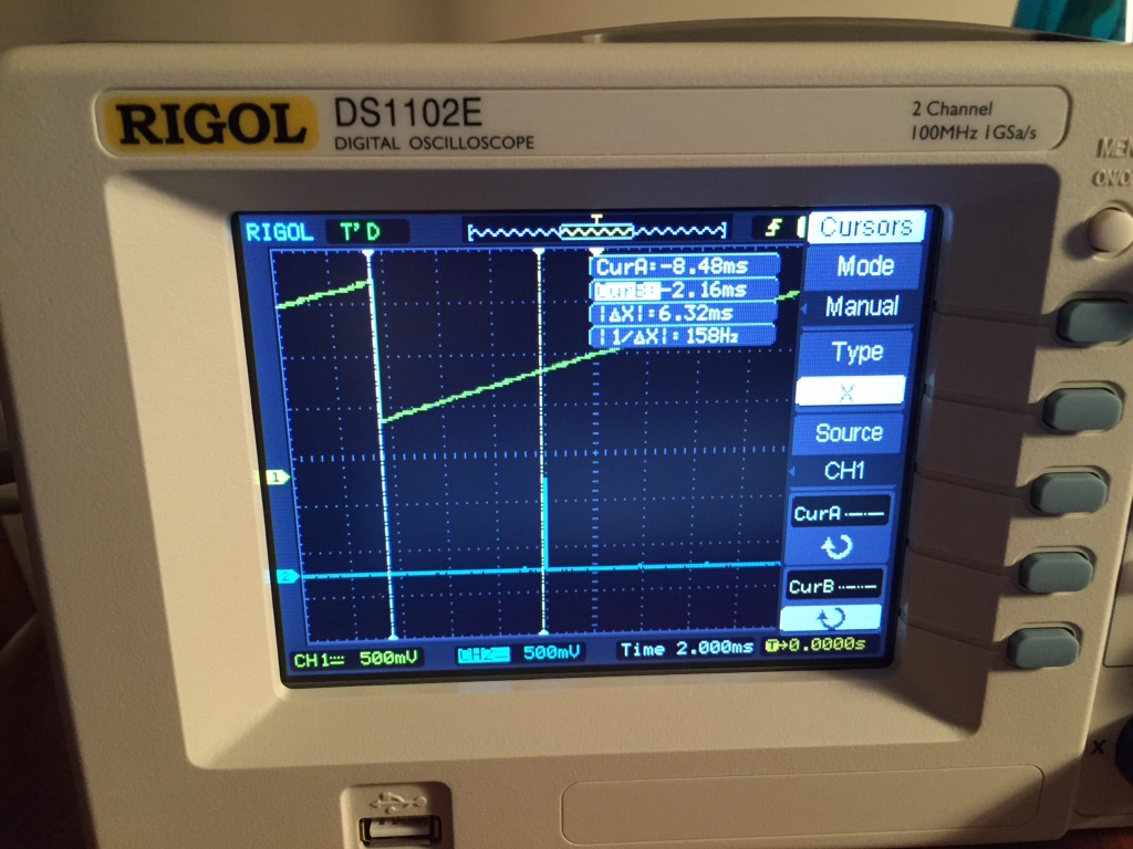

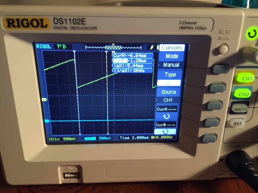

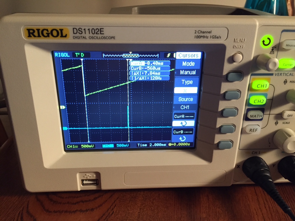

I started with the voltage on the power supply. The 32v supply was 32.79 and the 5v supply was 5.08. Both were easily adjusted to proper voltage.

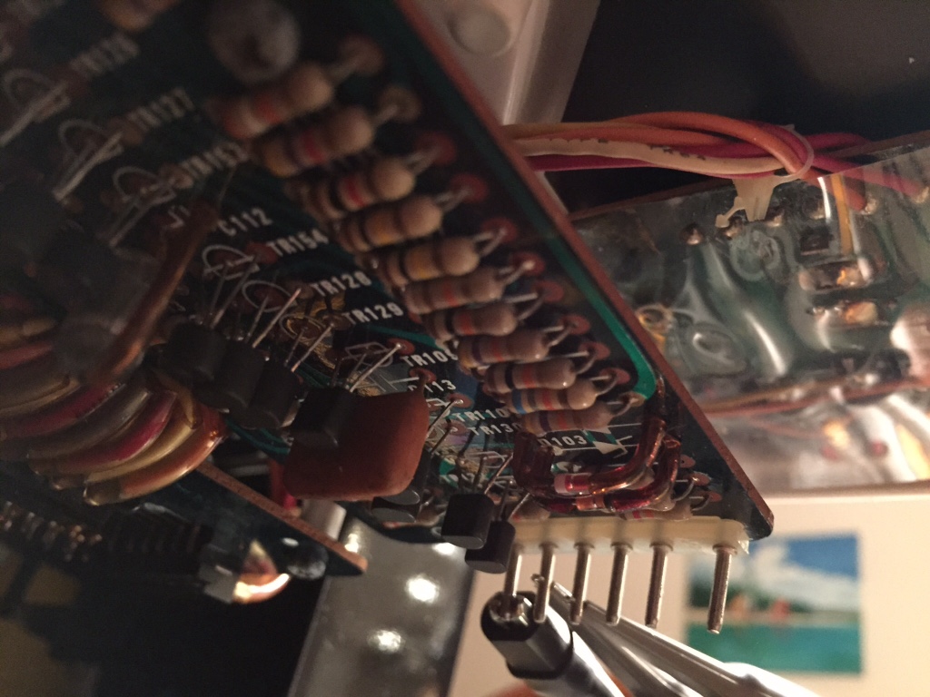

I hooked up the scope as directed, nice set of pins on the boards to attach to
So as usual, I didn't have a clue to what I was to do next. As I mentioned earlier I have never seen an oscilloscope before and not sure what I was actually supposed to measure with it. So for about a half hour or so with the scope on and connected and the table spinning, I kept pushing buttons and twisting knobs. I had the pair of images on the screen that looked like the reference in the SP-10 manual. But I couldn't seem to find any readings that looked what I should be seeing, at least close to. So I gave up to think about it for a while. I only have the manual on my iPad, and as I was studying I zoomed in and saw that I'm supposed to measure the distance between the two points, was not obvious to me before zooming in.

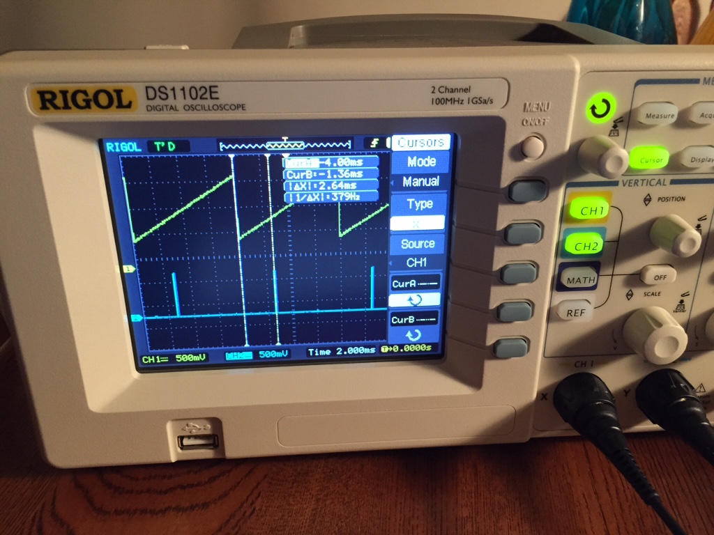

So after turning a few more knobs and pushing buttons I figured out how to move the measuring markers (don't know right work) to hit the points in the service manual. The screen even does the math to give the reading.
So if I have done this correctly this is what I had/have.
On 33rpm I had 7.84, should be 6.3 (+/- .2), adjusted to 6.32
On 45rpm I had 6.80, should be 4.7 (+/- 1.3), after adjusting for 33 it came down to 5.44
On 78rpm I had 2.64, should be 2.7 (+/- .1), so I didn't adjust it.
So to the experts, did I do this right?
That looks good, well done ! Have a look at the motor drive on A1, A2, A3 and post an image, lok for 5Hz'ish and about 2 volts Pk-Pk

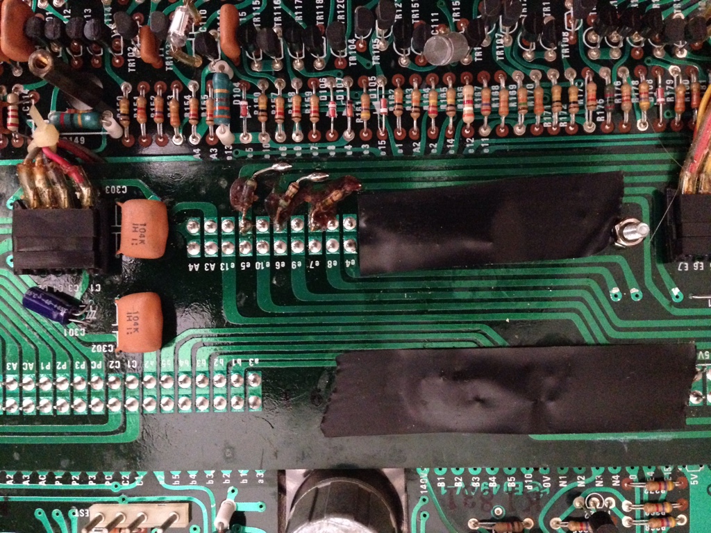

That's how it looks:
Does this look like original layout or some aftermarket mod?
These go to photo diode LN22.

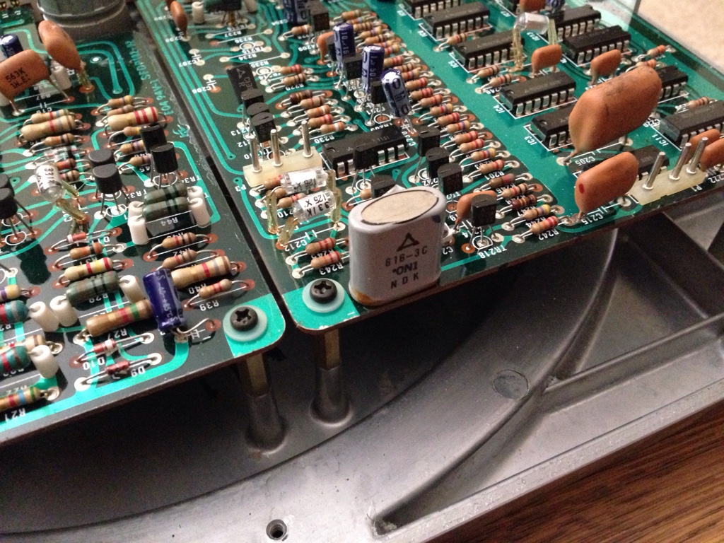

Replace with 105deg Panasonic caps of same value. FC or FM series.
X1 is the quartz crustal I think... I wouldn't replace it unless you are sure you can get the same value. I looked, and it's an oddball today.
Do you have a digital scope? Measure it, I suspect it's dead on. Mine are.

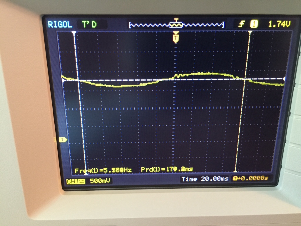

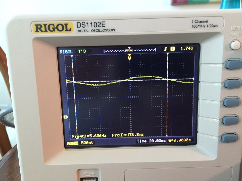

Dave
Dave thanks.

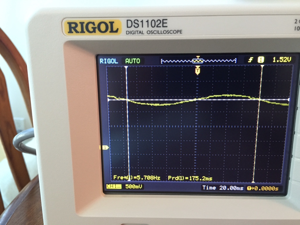

Here are some screen shots, in order, A, B, C
Is this what you asked for? Looks a little off, or is this in the ballpark?
Now that I have a baseline and know how to readjust later, time to swap caps.
