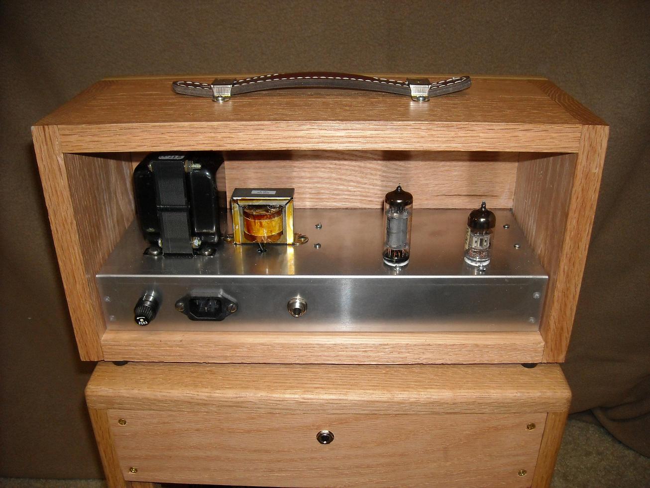

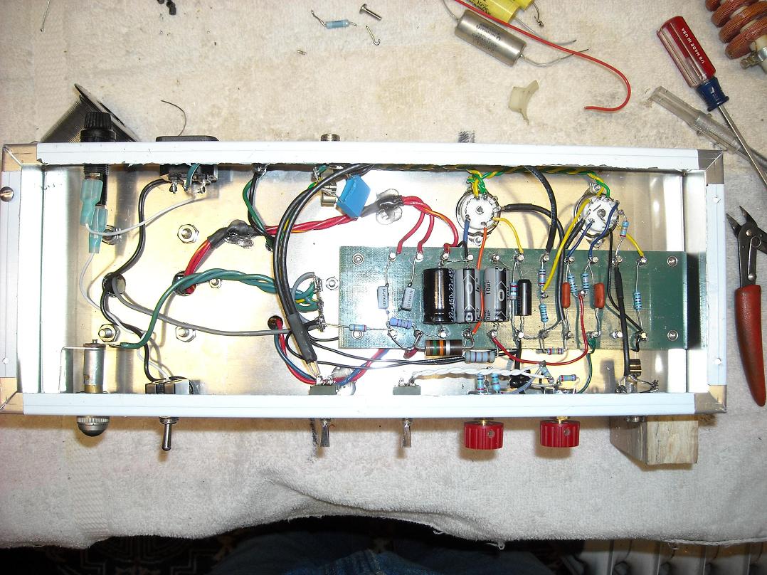

I just priced out the components, including transformers, tubes, sockets, resistors, capacitors, jacks, switch, volume pot, power jack, fuse holder, etc. to build a copy of the Fender 5F1 circuit.
If you build it the way Fender did in the 50's it will cost $$$$. If you use a 6AU6 driving a 6AQ5, use a N-68X, a cheap filament transformer, and a $13 OPT you can build it well under the $100 limit. With some creative re-engineering I can make a "Champ" for about $60 not counting cabinet or speaker. The little Champ transformer from Triode isn't to great either, its not much bigger than a 12AX7. It will saturate and force deviation from class A though, especially when you stuff a KT88 in a Champ. Don't do that with the stock Champ. You WILL smoke the power transformer.
and no it wasn't a theoretical amp only in a spreadsheet.
I didn't say copy, I said derivative.
B+ is close to 325V which is close enough to 340V which is what I've seen on 5F1 schematics.
I counted $7 for each tube which is close to what you can get JJ 6BQ5 and 12AX7 for.
So, the price is reasonable for what I've state.

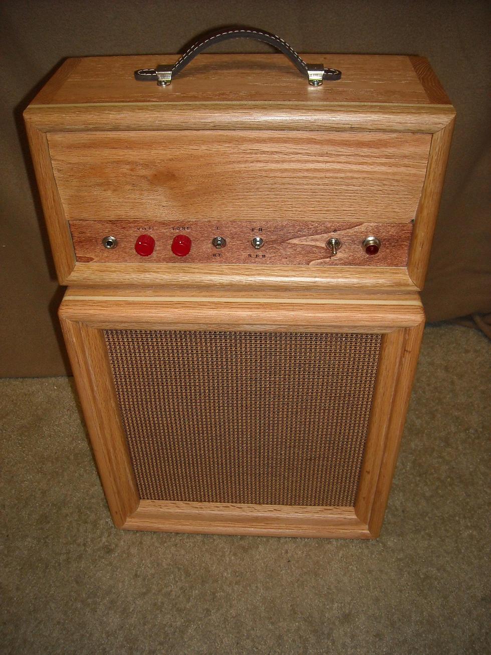

Here is the front with a matching speaker cab.
In addition I added switches to use/bypass the tonestack, and for optional feedback or no feedback.
It is interesting to hear the differences in tone in different modes.
