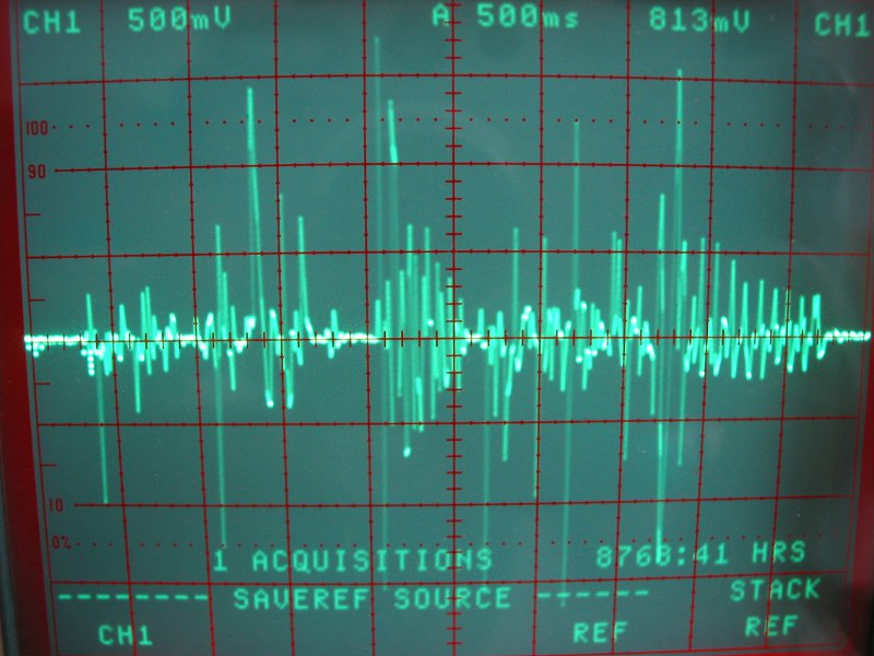

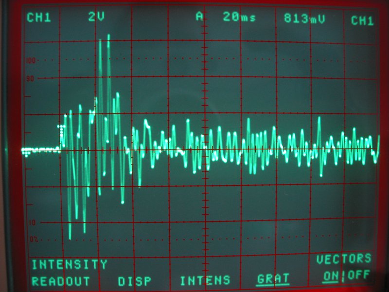

Guitar pickup output voltage
Here is a measurement.
First shot is the biggest signal I can make, which is over 6 volts peak crest. This is playing a fat 'G' bar chord on the 3rd fret with about as much bite as I can muster.
The next trace is 2 bars of riff from "Funk 49" (with the chord in the middle and the vibrato at the end...) played rather aggressively. This hits about 1.7 volts peak crest. Interestingly, the chord only peaks slightly higher than the hottest individual notes.
These are using the hot treble pickup on my Les Paul Studio into 10M impedance. The pickups are about 5K source impedance so the normal loads don't make much difference in the level. Switching in both pickups results in lower peak level.

Here is a measurement....
This confirms what I've read for years, that guitars are mostly at about 1 volt but can go to 2V and much higher in some cases. I think the 6V spike on the "G" chord is because for one or two cycles the waves all added constructively. All three "G"s plus harmonics of the other notes must have been in phase at two points in time. The dynamic range is huge. I think this is why live music sounds different. Anyone, and you don't need to have "golden" ears, can hear in a minute the difference between a live electric guitar and a recording. And it's not just the volume level. If I play a few notes on a low powered amp that is turned way down it still is easy to know it is a live guitar sound.
The osciloscope photos also show why the sugestion to record some ruff and shared then so we can hear the sound of the amp with the same input will not work. First how many of us have playback equipment that to make a 6 volt peak output. and if so does you playback equipment of the same source impedance as a guitar?

The 50 to 400 mV numbers that I quoted were RMS numbers made after the initial note attack. I used the best instrument that I had back then an old HP331A distortion analyzer that reads RMS on a perfect sine wave, and something close to RMS as the distortion goes up. I used an opamp buffer to provide a very high impedance. The 331A was calibrated with the buffer in place. I worked in a cal lab then.
When you pluck a guitar string you move the string a few MM off center than let it go. There will be a huge low frequency transient as the string flies by the pole piece on the pickup and then settles down into a decaying wave form. The transient is far larger on the neck pickup because the string displacement is larger. The bridge pickup has a smaller transient unless the strings are picked right over the pickup.
The signal from the neck pickup is nearly a sine wave after the initial whack, while the bridge pickup has many harmonics throughout the entire note. Of course the type of pickups, the adjustment of the pole pieces (if they are adjustable) and the spacing of the pickup to the strings affect things a lot.
The huge transient that the flying guitar string makes will blow speakers and saturate OPT's if you have excessive low frequency response. I learned this back in high school with a home made solid state guitar amp. I blew a lot of speakers before I figured out that guitar amps have smaller coupling caps than HiFi amps for a reason.

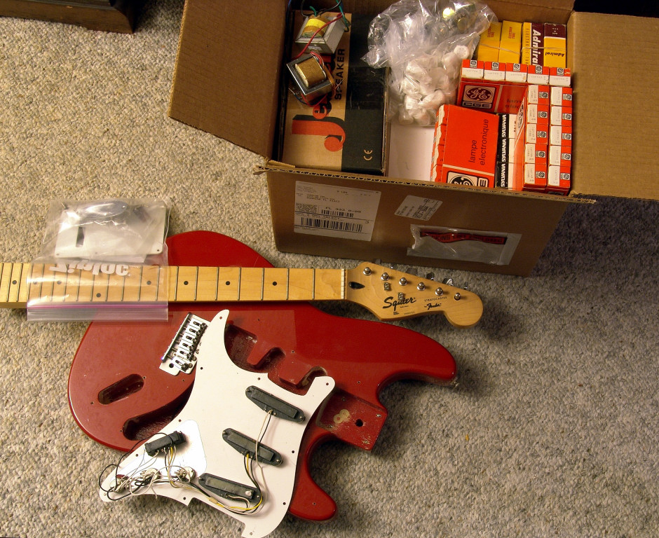

I unpacked 4 boxes of parts, and put them all in one box. There is $350 worth of parts and $60 worth of shipping in that box. I also put my guitar next to the box and took a picture. Obviously I have a bit of work to do even before I can measure the guitar. I took it apart over 2 years ago to make some measurements, because I am making a guitar too, but that is another project. I'm still ahead of the guys that don't have guitars.
