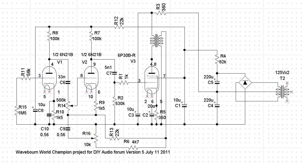

Toying yesterday with super-dirty overdrive of a single ended output I decided to "improve" it in this particular regard. Additions included EQ in preamp to attenuate fundamentals of mostly low frequency strings, and to add an overdrive tone control. Here is the schematic attached. It sounds less nasty when overdriven, but did I loose some bottom end on clean sound, as the result? I don't know yet, because instead of a speaker box I use a small baffle with 12" driver from GE console.
You pretty much end up with a thinner clean sound if you EQ it for overdrive. Just the nature of the beast. Now if you had a dual pot and you reduced the bass as you increased the gain... ... not suggesting anything, just saying.
I was thinking about it, but I don't have a dual pot with different values of gangs. What I come with, you see on schematic: connecting the gain pot to the same point where feedback capacitor goes I made depth of boost of highs dependent on volume control. I will put the result on youtube.

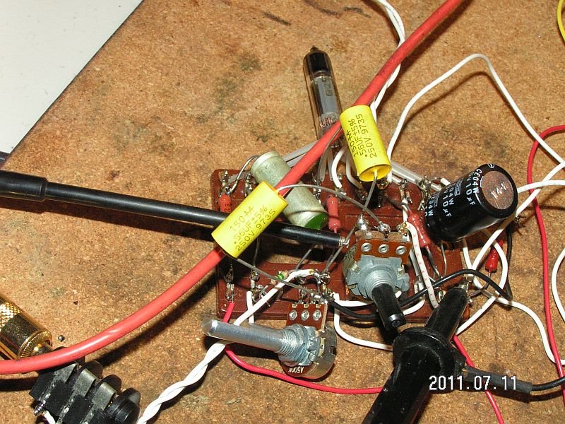

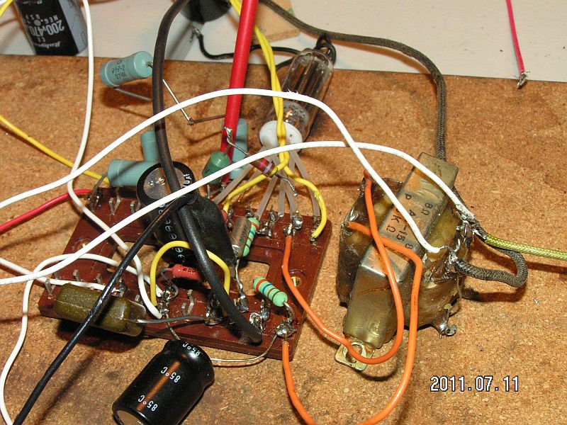

Here are pictures of my current breadboard: preamp and power stage, using sub-miniature tubes. 6N21B tube can be replaced by 6N2P or 12AX7, 6P30B can be replaced by 6P1P or 6V6.
Your project is interesting and the sounds of your amp is not bad either. Keep improving it as I am looking forward to see the final version. I would especially like to hear it with a 6V6.
