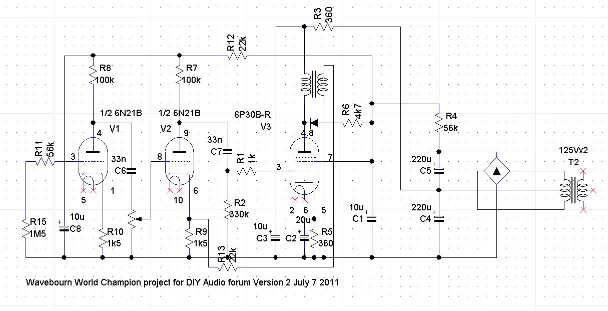

Here is corrected schematic, how it is now.
Is the first .022uF off the first plate there to allow you to use lower voltage caps in the tone stack? It is not needed if all the caps meet the voltage spec, otherwise yes one HV cap there with say a 1 Meg bleed to gound would allow lower voltage caps in the tone stack. Also, the .022uF is in effect in series with the .1 uF and .47 uF in the tone stack at mid and low frequencies and it will dominate the reactance being of much smaller value. Fender often used .022 or .047 uF in the tone stack, did you really intend to use those big values?
Oops it was late, was not paying attention to the numbers too much, you are right about the tone stack. The first 0.022uF I had in place in another design which could switch the tone stack before and after the first triode. I left it in as it allows the option to do it with this board. I never considered the 1Meg though.

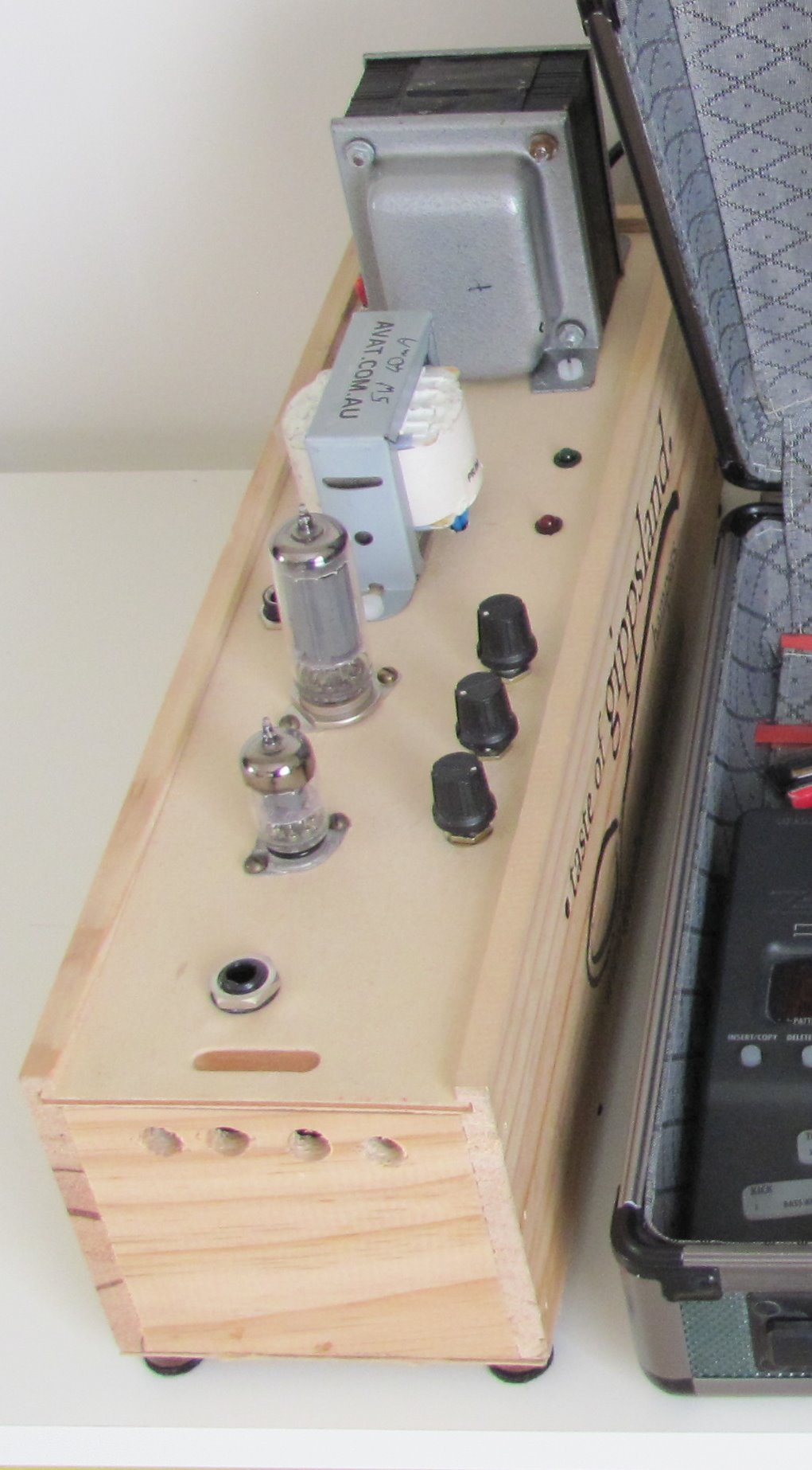

1st attempt
6AK5, 6CL6, 38volt tfmr thro flash cap voltage sextupler, wine box (empty now), output tfmr (7500:8) blew the budget. Will have to try the fender 6G15source (thanks Chris A).
Sounds:
Volume - clean from 8 o'clock to 12 o'clock.
grid current clipping from 12 to 3 o'clock
grid current and cut off limiting from 3 -4 o'clock
Tone - good enough not to bother with tone stack
Loudness - bedroom level if nobody else at home ;)
