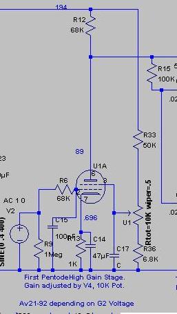

Now that I finally (hopefully) have the oscillation under wraps I've gone back to playing with this circuit.
By varying the screen voltage on the first stage I can shift the operating point and thus the distortion level.
changing the G2 voltage also changes the gain of the stage over an Av= 21-92 range. To compensate I've switched to a gang pot (not in simulation) with one section acting as a volume control which is wired inversely to the G2 bias pot to compensate for gain change. It tracks within a couple of dB and I think I can get it down to 1dB or less.
Right now it varies the anode voltage from mid bias to almost cutoff. I thought about increasing the adjustment range to allow operation anywhere from saturation to cutoff, but the gain swing is non-linear and I can't compensate easily with a gang pot.
Your project is interesting and the sounds of your amp is not bad either. Keep improving it as I am looking forward to see the final version. I would especially like to hear it with a 6V6.
You can try it with 6V6, but I will keep 6P30B-R in mine. Sub-miniature tubes are dirt cheap, don't require sockets, and are very reliable, being manufactured for space and military equipment.
