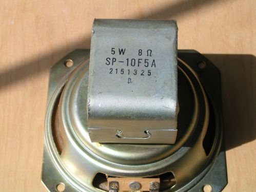

I have a pair of the alnico SP-10F5A (Sony?) FE103As coming in the mail and I'm wondering if the Frugal Horn would be a good fit for these?
Pictures?
i have found a significant potential for variation on the spec on this class of driver, Typically these have even higher Q than an FE127e, but that is only on average -- it will depend on your specific age. Alnico is suseptable to losing its magnetic strength over time, or is knocked which will change its parameters (it would be nice if someone started offering a recharging service)
Sony didn't make there own drivers, but the Sony's i have had have been either a 120mm class Foster or the holey basket Coral. I have measured holey basket Corals that should work, i haven't measued the Foster (but i do have a single in a drawer somewhere). Both sound quite special.
dave

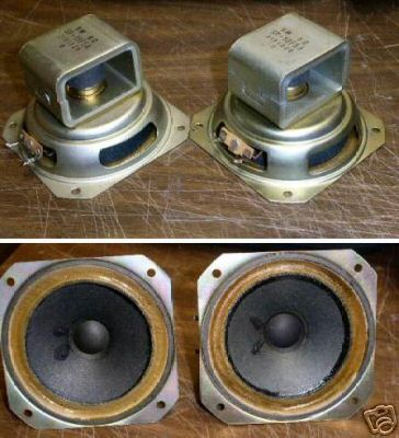

Note: I don't have these in hand, this is the picture from the auction:
Tom.
Was there any other data in the auction?
I've not seen this variant before. From the basket & the surround i'd suggest Coral OEM. The picture is tiny, but there is indication that these may be suffering from "Stiff Surround Syndrome". You will know pretty quick once you get them in your hand and push the cone in and out. If that is the case then these are mid-tweeters unless you can fix the surrounds. So far i have had no luck, but a client gave up a technic he found worked (and it sounds like it could). He says it can tend to get messy thou. Once it warms up i will give it a try (i have 30 or so drivers that have SSS and are dispensible before i get into the ones that would be really worthwhile saving.
dave
frugal-phile™
Joined 2001
That the surround is not stiff is a good thing... if we knew how to interpret them that last number would probably tell us exactly who made them. My best guess is that these are a Coral (or National variant, but the bezel shape also suggests Atomix (not one of their hi-end ones thou, those would have tell-tale ribs on the cone.
Can you measure them?
dave

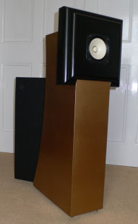

latest photo's
Hi all, see the photo's of my recently completed Frugelhorn build, it's a fairly straightforward version based upon the full build, only real difference is the suprabaffle which is made using two stepped runs of 20mm quadrant, (Dave's version using the table saw would have been quicker but I had the quadrant lying around!) I've also bunged the voids up with expanding foam so the sides are solid. The wedgie did make the build easier!
Fe126e's are part run in, as you can see from above I just need to sort the compression chamber and away we go.
Photo no1.
