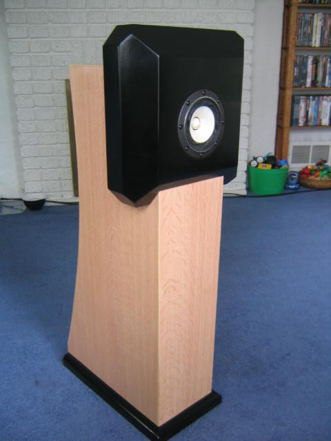

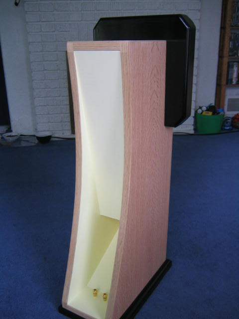

They are finally done! They were a lot of fun to build. I learned a lot. I feel they turned out very well considering this was my first build of this design. Now that I'm aware of all the pitfalls in building these, I have plans for another pair, using higher quality materials and technique throughout.
They sound quite nice. Sweet, warm, and inviting. Tight bass down to the upper-50's. I could only find one recording I have where they couldn't play a very low, soft kickdrum. Other than that, I can hear everything. I did use a notch filter to knock off up to 2 dB between 2k and 10k. That warmed the sound up nicely and really brought out the vocals. If you want a sharper, cleaner sound, the filter can be left out. I may experiment a bit with that later myself.
Construction details:
Build version: Wedgie
Driver: Fostex FE108ES
Wire: one Cat 5e, four strands each side (although I understand one 24g sold core would be better).
Notch filter: C=5.1 uF; R=2 Ohm; L=0.15 mH. This knocks off 1-2 dB between about 1200 Hz and 10k Hz. It removes the "hissiness" from these drivers.
Finish: Wood: Sanded to 600 grit followed by clear paste wax only. Suprabaffle and base: Black lacquer, 4 to 6 coats, sanded between coats. (and no, it's not perfect
The cabinets are absolutely DEAD! I put in lots of extra bracing and filled all voids with cat litter (yes, I have plenty of that). After building the carcass in 3/4 inch (external) and 1/2 inch (internal) plywood, I wrapped them with some beautiful 1/8 inch quartersawn oak plywood with solid oak corners and edges. I used contact cement to glue the plywood as I wanted that extra damping effect.
Stuffing/Damping: Just a little bit in the line immediately after the throat. I found that putting stuffing or damping anywhere else in the line did not help. I can still access this little bit by removing the driver, so I may experiement with this in the future.
The CC (compression/coupling chamber) required a lot of tweaking. I had to make changes a number of times during construction, so in the end I estimate its size to be about 1.7 liters or 107 cubic inches. Anything over 1.8 liters, to me, made the vocals sound fuzzy. If you go much lower (i.e., 95 inches, or 1.4 liters, you lose bass.
The suprabaffles started out 13 inches square x 3.5 inches thick. They are slightly asymmetric (meaning the driver is not perfectly centered; it's off by over 1/4 inch). I attached them to the cabinets with silicone caulking, hoping to get more decoupling from the cabinets. The driver is mounted flush to the surface, i.e., it's set in about 3/16 inch. After trimming, etc., the final width of the suprabaffle is 12 5/8 inches.
Doug

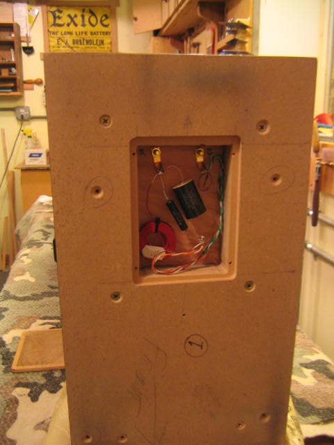

Rear view. I like where the binding posts ended up. I originally had the posts at the top, behind the CC, but I did not like the wires hanging down and where do you put the notch filter and still have access to it? The paint is simple yellow paint I had lying around.
