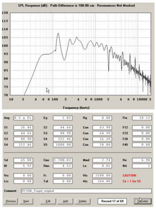

1. When modeling the Frugelhorn in McBean's Hornresp I get some strong irregularities in the 100Hz to 400Hz range, and a particularly troubling looking peak @ 135Hz. This peak is about the same for a wide range of back chamber and mouth dimensions (e.g.: actual effective mouth of about 450cc, approximate mouth with curved back about 1000cc, and mouth with reflector about 2000cc). This peak does not change much with chamber resonances masked or unmasked. Could this be an artifact of the transmission line nature of this cabinet?
2. Does anybody have some real life experience as to how Hornresp results translate into measured results?
3. This may be really dumb given how much time you must be putting into this already, but I'm wondering, planet10: Have you given any thought to a bipole version of this cabinet. Lowther has used something like that in some of theirs. It would still be a "tiny" speaker.

johninCR: Yes, I added the nominal distance as well as trying all kinds of other distances as you would encounter in a corner installation. In general the big peak in the 135Hz range remained, even though the response curves were quite different. I'll try to attach an image of the combined response (used 100cm in this one) and the input page, maybe you can find if/where I made a mistake. Mainly, I found it a point of interest. What the in-room response with reflective corners and side walls would look like I don't even want to try to imagine; that's why I too believe in lots of listening when building a speaker (and a room).
planet10: The bipole should be another interesting version, looking forward to your design.
planet10: Thanks for that note, so my use of Hornresp is not completetly off the wall. Hopefully someone like Ron Clarke or Martin King can throw some light on this subject. It may just be the normal effect of a short horn and a small mouth. I'm just trying to get a feel for how to use Hornresp, still have not found a cheap version of MathCad to get to know Martin's worksheets.
johninCR: As long as the overall length has not changed, and the mouth is not smaller than 400cm^2, I think the Tombstone will model just like the Frugelhorn. Particularly as Hornresp allows for only 4 sections, so that makes it necessarry to pick some points along the flare, and use those to model to. Not to talk about modeling the corners. Thanks for looking at it.
GM: Thanks for reminding me. I have downloaded the free version of MathCad8 and the sample worksheet. It all certainly looks very impressive and interesting. The worksheets I downloaded in 2005 will not open, wrong version of MathCad, and naturally the free version of MathCad does not allow saving. I'll wait until I can find a copy of MathCad at ebay (and some extra time). Meanwhile I'll try to get the hang of Hornresp.
