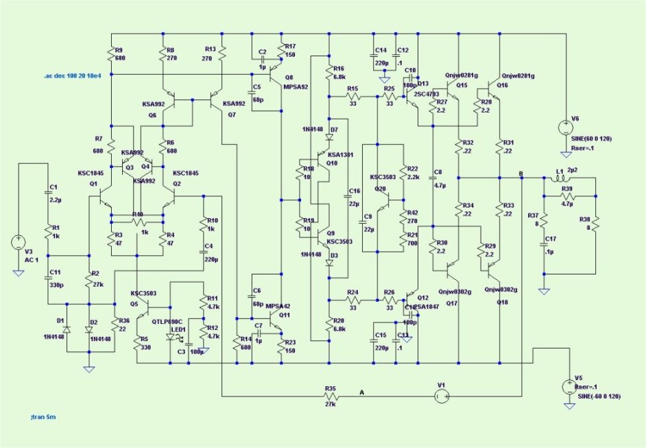

I'm confused - is this not the Krill O/P stage on one of your built prototypes? Taken from here: http://www.diyaudio.com/forums/showthread.php?postid=1717427#post1717427
What has me confused is this post a page back from Os http://www.diyaudio.com/forums/showthread.php?postid=1711801#post1711801
where I interpreted what he says to mean that he has a sliding bias compensating scheme.Q10/9 and the diodes give
you the 4 Vbe's (2.3-2.4v), which is too much(200ma bias per
device) ,Q20 shunts the extra .1 to.2v giving thermal compensation as well (it is mounted on one of the OP devices).
I might use the krill compensation but that would force
me to use 2 trannies and 3-4 diodes to achieve comparable
results.
Another good thing about this is if the Vbe fails, the worst
that can happen is overbiased outputs.
OS

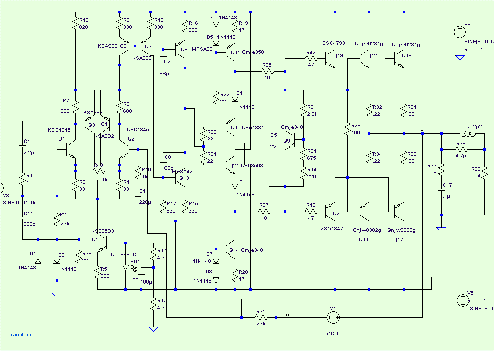

By Jkeny - Is the schematic above posted by you the FA3K schematic?
That is the "K" . it is truly conceptual at the moment as I have
only run its VAS and input stage in the real world.
It has the diamond of the crown 300DC amp, the CCS's of the
krill and the Vbe of the frugalamp. A "patchwork" of sort.
The reason I did not go all the way and use the krill's Vbe
as well is 1. It's diode array and 2 trannies do not track
frequency and amplitude changes as well as the MJE340/bd139,
2. it is easier to implement a single device 3. didn't want to
"rip" Mr. Dunlops circuit.
The actual Crown amp does not use the diamond as t-comp
but instead uses a couple of thermal resistors. Another
Diamond amp, the nakamitchi 620 ,uses a 4 transistor
emitter follower diamond on the main HS as the thermal
compensation .
One errata I do notice with the Diamond buffer is that ,
at high frequency and output,
and without enough current (under 7ma),
small transients will appear at the diamond's
base and emitter. 8 to 10 mA of CCS current solves this, but
this means that the diamond/ CCS array would need a
larger heatsink .
OS
does your amp have sliding biasing, like the Krill
No , you can induce X-over on mine. But after simulating the
krill, by lowering the value of the resistor he has across his
2 diodes , it , too can be made to produce X-over distortion.
In the krill ,if something goes wrong with the diode string
...Deep class A and popped fuses. in mine if the MJE
failed ,200ma per device would result.
Both biasing schemes seem to work in a similar way, and,
if properly adjusted, not one iota of X-over dist..
If you want to call that sliding
OS

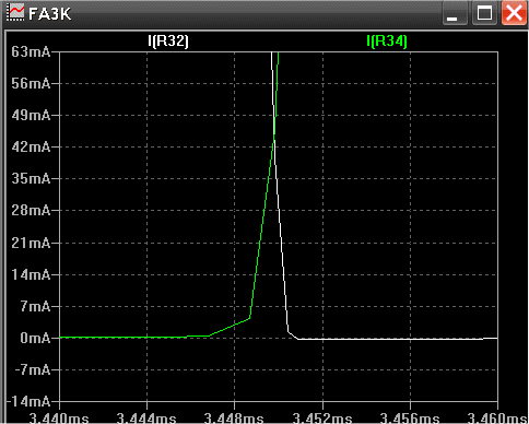

By jkeny -The krill actively prevents the turn-off of the undriven channel during music reproduction, does yours have some similar mechanism or is it relying on a high bias to prevent class B operation?
I don't think the krill works that way, In simulation it works the same as any other class AB amp, one side of the OPS WILL shut off, but only AFTER the other one turns ON.
In true class A both P/N's would pass AMP'S you would
never get 100w+ , as most of the current is used for heat
(tranny + Re) If you grossly overbias mine or the krill ,
true class A will happen at low to moderate OP swing, but
with a lot of dissipation.
Attached I have the .ASC (LT) files for both. If you simulate them,
you will see that my words are true.
OS
I don't mean to put the two of you at loggerheads but my understanding of Steve's circuit comes from his explanation: Here's Steve's quote for how the biasing scheme works & it seems to me like it's sliding biasing
The base current in the bias pair is equal in both transistors at all times. I is not, however constant. Changes in the emitter current cause changes in the base current. When one transistor conducts less, the other conducts less. If for example Q8 conducts less because the voltage on the emitter of Q7 goes more positive (causing more current to flow in the base of Q13) then Q11 conducts less causing a greater voltage drop from emitter to collector. This makes more current available to the base of Q15 causing greater conduction to maintain an on state.
ostripper said:
I don't think the krill works that way, In simulation it works the same as any other class AB amp, one side of the OPS WILL shut off, but only AFTER the other one turns on.
OS
I don't doubt what your simulation shows you. My simulations show differently and so have some other peoples. I have also discussed this design in great detail with a number of very good electrical engineers and they agree that it works as I say. The final proof, to me at least, is the building and measuring of several amps at different power levels.
One interesting aspect of this design is that for a given voltage output, reducing the load will automatically raise the bias.
And no, I have not taken any offense at your findings.
I really doesn't matter to me what it is called. It works and more importainly, it sounds good, is stable and reliable.
I am a unimformed jerk.. you are right..
(i did not zoom in enough)
the krill's "off side" stays at 3-4 mA ..real class A
neither side goes fully off..
OS
