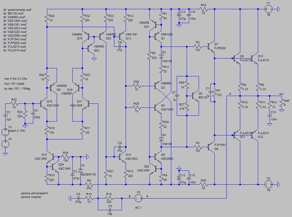

ostripper said:
I didn't mean to point out a problem , but I don't want to be
a contributer to burning amps .
I've tried both including or omitting the diamond current
stage in the NFB loop with little effect other than ,with the
isolated current stage, no change with load. (As you pointed out.)
Another interesting note is that by degenerating the darlington
(470r - 2.2k) like a standard EF type 2, "tames" a little
bump at 5MHz (I think that is where this thing "likes" to oscillate)
and sets the phase margin.
I already did the carlos thing and no fire , so I know it works. I tested what would happen if my vbias died and it
is the safest I could imagine.. just 300ma (severely overbiased).
Idiot proof, much better than a typical amp. A total short at
the output would just burn the basestopper resistors.

BTW..., yours(krill) is most like the Nakamitchi 620, except they use an EF'ed diamond which is the thermal compensation .
(attached)

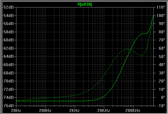

Anything that contributes to the stability of the amp is welcome. I certainly have no issue with you pointing it out.
I haven't seen the bump at 5 Meg in the open loop design.

Hi OS,
Looks good on the sim to me
A few points though...
1) MPSA42/92 ? They're a bit slow, only 50MHz fT. OnSemi also do the MPSW42/92 which are extended TO-92 packages that do 1W - might be better.
2) For Q11/Q12 - check out the dissipation on them, hardly any. I switched to KSA992/KSC1845 here.
3) The R-C-R filter in the current source for the LTP produces a hell of a turnon thump by the look of it - the output goes nearly full +VE rail until the current source turns on. I nicked an idea from the Cambridge A3i amp on this score.
There is also quite a difference on the sim between taking feedback from the output, and feedback from the VAS - it's a lot worse from the VAS, with a lot higher THD figure and much more prominent H2/H3/H4. I'm debating trying the "split feedback" system that's in the Leach Amp.

which components achieve the quiet turn on?jaycee said:3) The R-C-R filter in the current source for the LTP produces a hell of a turnon thump by the look of it - the output goes nearly full +VE rail until the current source turns on. I nicked an idea from the Cambridge A3i amp on this score.
build it , man!!!by JC - Looks good on the sim to me
Now that is strange, I kept the same CCS from FA1 and 2,
with 4 in the house now..NO Thump. In fact , I was surprised
when first turned on the first FA1.. I thought I would have
hum and/or a little thump like I read about from other threads,
but no..nothing.
Of the 3 frugalamps , the 3-x series, even through it appears
unbalanced LTP wise, balances within .01mA (even better
than FA2) in the 2 tails Ic wise.
the only anomily is when you shut down the FA1/2 ,you hear a
little bit of crackle (distortion) as the rails collapse in the last
1/2 second..
If you build the FA3k (diamond) first, being untested, and like
it, I will build it ,too and make the board for it. But if you don't,
I going to make a pair of FA3's as I already have protoyped the
LPT/VAS/CCS and it rocks.
OS
ostripper said:
build it , man!!!
I know - what's putting me off is that I still don't have a 'scope, nor the funds to splash out for one
ostripper said:
Now that is strange, I kept the same CCS from FA1 and 2, with 4 in the house now..NO Thump. In fact , I was surprised when first turned on the first FA1.. I thought I would have hum and/or a little thump like I read about from other threads, but no..nothing.
It only seems to do it with the diamond - look at the first 5ms or so of the sim, using ".tran 0 10 0 startup uic" which simulates poweron. With the cascoded FA3, it doesnt happen - the output stays at 0 until the current source starts.
ostripper said:
Of the 3 frugalamps , the 3-x series, even through it appears unbalanced LTP wise, balances within .01mA (even better than FA2) in the 2 tails Ic wise.
I really like the Holman arrangement here. A very elegant solution for the VAS
Personally though I still like the "symasym" style "differential" VAS.
ostripper said:
the only anomily is when you shut down the FA1/2 ,you hear a little bit of crackle (distortion) as the rails collapse in the last 1/2 second..
Same with pretty much any power amp.
ostripper said:
If you build the FA3k (diamond) first, being untested, and like it, I will build it ,too and make the board for it. But if you don't, I going to make a pair of FA3's as I already have protoyped the LPT/VAS/CCS and it rocks.
We will see... I've got two heatsinks, 2x15000uF 80V, and a 2x35V 500VA toroid waiting to go... as well as most of the transistors... just wish i hada scope!
