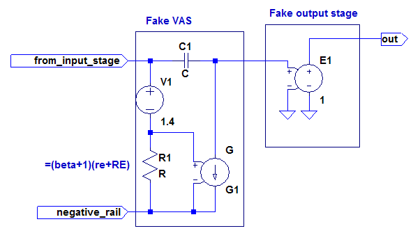

homemodder said:
Input stage has cfp yes, so its a common problem. Does it show up with real circuit too or is it simm problem?? I have no equipment to do real testing with me now till my container comes from my previous home which was 14 000 km from where Im now.
I don't know whether it goes away in the real world, as I avoided the technique because it behaved poorly in the sim.
A messy technique for stabilizing it which you might be able to simplify was presented in this thread. I haven't tried it in the sim or real life.
One thing I did find with experiments in the sim was that the common-mode input stage distortion dominated over difference-mode, by more than an order of magnitude. I did this by modeling the VAS as an idealized transconductance (VCCS) with a Miller cap, and the output stage an ideal VCVS. See pic below. So I think the reduction of simulated distortion by using CFPs in the input stage is to a large extent a quirk of how they handle common-mode effects. The bootstrapped cascode with ordinary input diff pair does surprisingly well, as long as the degeneration resistors aren't tiny.
Disabled Account
Joined 2006
Thanks andy, I read that tread more carefully, although I have serious doubts about that vas, Ive tried it real life and couldnt get it stable although theres a yamaha amp that uses it. Mine has high loop gain too but no baxandall for me, can be achieved by other means. Ill try some comparison tests without the cfp.
by andy C.So I think the reduction of simulated distortion by using CFPs in the input stage is to a large extent a quirk of how they handle common-mode effects.
CFP inputs are cool.. the Ic ratio between P and N is
a tradeoff between noise and linearity. I found that a
equal balance in Ic (.9Ma PNP+ .9Ma NPN - FA3) almost totally cancels H3 with a marginal/acceptable increase in noise.
The advantages surprised me after exhaustive simulation,
the loading of the LTP seemed immune to frequency unlike
the common pair before.(lower Gm)
I don't seem to get any peak or unstability either.
By andy C. - I noticed when putting large bypass caps on the VAS emitter resistors,it got quite a bit higher as expected
I noticed changes in UG/phase as I varied bypass caps between
.68u and 10u ,even more change than Cdom. I made universal pads on my final board to allow for any device.
OS
