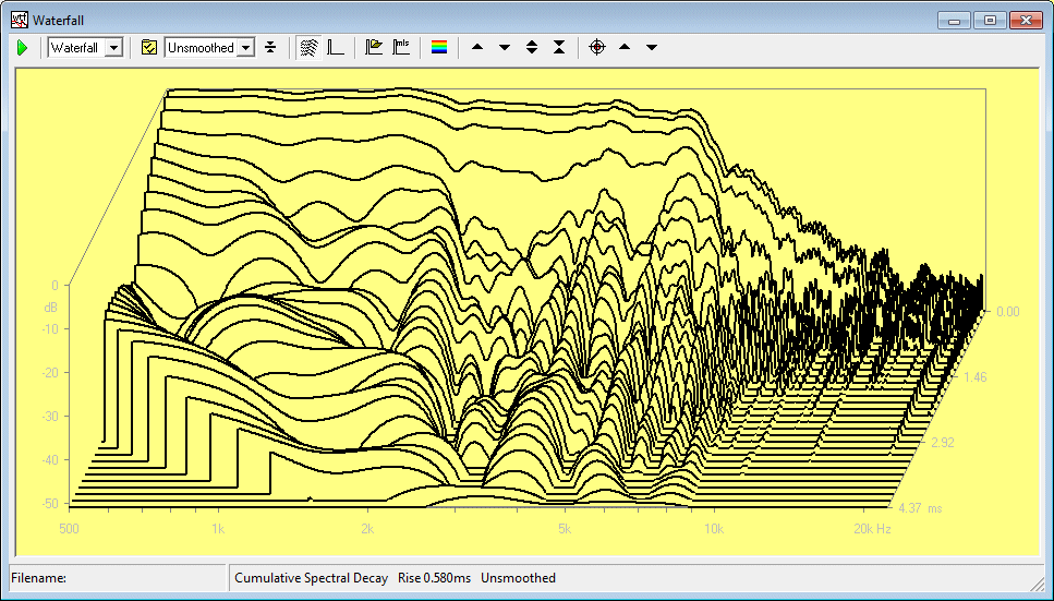

Please see the CSD plot below, this this the Peerless Nomex driver (measured of the Hamlet box) at 2 Metres and 15 degrees off axis (the recommended listening axis) and note when off axis there is no problem with the 4KHz peak that in on axis. There is also no severe ridge that would indicate a significant resonant behaviour.
I have long held the view that under the 'Jordan knee' being the frequency where the cone ceases to be a piston, that under the knee it is diffraction effects of the box that dominates and above the knee it is diffraction effects within the cone (much to do with cone shape and surround) that dominate, provided there are no severe cone break-ups or other anomalies. I don't see any such here.
So if that 4KHz peak is a problem, toe the speaker further out - that has always been my recommendation. Also, rooms can have a significant influence here as well. I once made a speaker sound right in a very dead room and when it was taken to an average (good) room, it sounded much to energetic in the upper mids and up.
So the Elsinore Mk5 can be made to work without the LCR on the MidBass - just takes a bit of applied thinking setting them up.

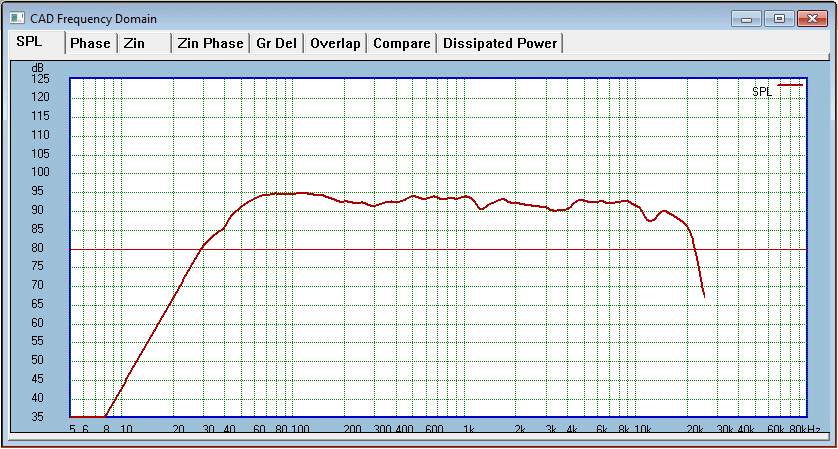

Early modelling of the Mark 6 Crossover - it looks like this may settle in to close to the end result, see below.
Please note the plateau centered around 100 Hertz is influenced and accentuated by microphone proximity effect of nearfield measurement - so account that it in reality it is a little lower than that.
Cheers, Joe
