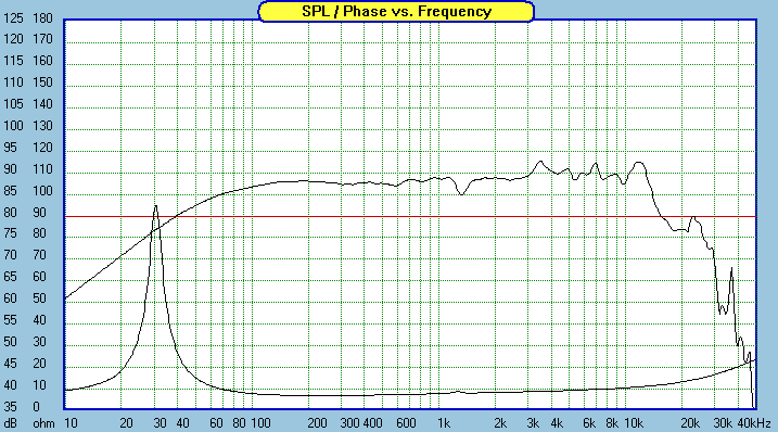

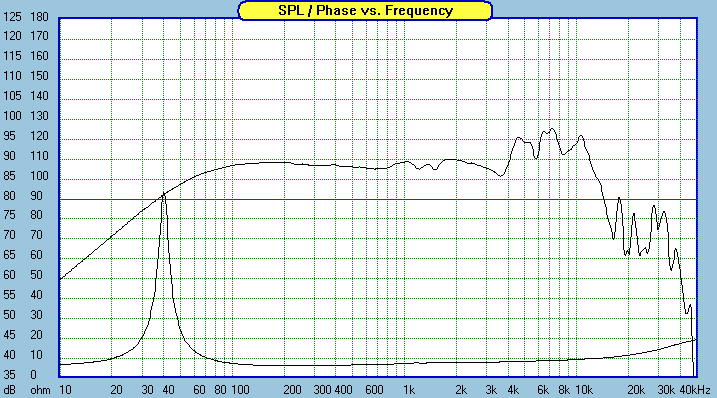

From Zaph's site (with Satori 1st):
The difference in mass results in a lower fs (..if it's something you need), and naturally lower sensitivity (though not much lower as seen below). The Satori has about a 30 Hz fs, while the other has about a 40 Hz fs.
Ahhh... good ol' Zaph. Yes, I look at them to.
That 40 Hertz is said by SB will come down significantly, but as you can assume, the VAS will also rise. The Fs is claimed by them to be 32 Hertz when run in. There was some statistical work done back in the 80's that looked at speaker suspensions influencing Fs, where the mass of the cone and the motor are always a constant. It showed that Fs going one way and the suspension loosening up going the other way (VAS), that the alignment was actually surprisingly stable. So the mechanism is in part a self-compensation.
I think the difference in sensitivities is not due to cone mass, which looks to be the same (has nothing to do with Fs of course), but the Neo motor.
Yes, Zaph's website is also something I follow and when I did some measurements on drivers back earlier in the Elsinore Project, we had an interchange about doing those type of measurements and he was very complimentary as it is a skill I suppose. But anybody can do it if the set their mind to it - just need the equipment of course.
BTW, note the very low inductance of these SB drivers, the flat Z curve, and that the cheaper driver is actually better - and one rated 0.15mH and the Sartori 0.2mH. This has nothing much to do with the copper coil but the motor and is of course non-linear (does SB use a copper sleeve that Wavecor does?). But interestingly, when it comes to those distortion measurements, above a certain frequency, the poorer driver with higher non-linear inductance, may well better hide that distortion better, than a superior driver that does not. Note these drivers often have seemingly more erratic response in the upper mid and lower treble, they may look worse, but they really are not. Waterfall plots can usually clear up that the behaviour is benign in a lot of cases, and they show up worst when measured right on axis - I believe they are more because of cone diffraction (acoustic) rather than real bad distortion. Metal cones I avoid, they are different in this respect.
So now I am adding up the number of differences why I choose the non-Sartori driver and is quite comfortable with that selection. Also, have you noted there is an odd discontinuity in the Sartori at around 1.3KHz, and worryingly it can be seen in the impedance plot, just. Also, the Sartori, on axis, looks better above 3KHz, but is that because its inductance is higher?
Did I mention the price difference, it is huge. And more DIY friendly. This is affordable DIY, right?
Cheers, Joe
Hi Joe..
It was just some more info.. I personally don't think VC heating will not be a problem in either design. Zaph measured the Satori at about 15 grams, the other driver at about 11.5 grams.
I've got no problem with the choice. Though I should argue for others that you should design for both drivers, assuming that's viable (..and I think in this case it is) - let them make the choice on price. If it comes down to added expense on your part for the design.. try asking SB for a little help. It's going to make them money either way, so helping you out a little in advance isn't unreasonable. (..I'd even ask for some of their tweeters as a potential option as well. Consider even full "SB" versions - I'm sure they'd drool at that opportunity.)
As for the dip (or "null" actually) at 1.3 - it's just a harder (less-well damped) internal diaphragm reflection "hitting" the surround. The mass of the Satori is higher and can't be damped by the surround as well for that artifact. The other driver has the same issue, but it "ripple's-out" a bit higher.
Note that neither Jeff Bagby nor Joachim Gerhard seemed to have any real problem with the null (..which makes sense considering that it's both a null and fairly narrow in bandwidth). Of course if you don't think it sounds good then that's another matter, but you'd have to try it first.
With respect to the upper-end response: again, mass (vs. shape) and the driver's damping. The inductance of each driver is exceedingly similar (..maybe 1.5 ohms difference in the "break-up" region).
I think the more interesting plots are the non-linear ones. I can almost guarantee you that the Satori's stroke will be more linear for longer.. NOT as good as something like the Illuminator drivers from Scan-Speak, but then nothing else is either (..and the Illuminator's have higher distortion at lower excursions when compared to the Satori, and even high-order distortion on the non-Satori driver).
