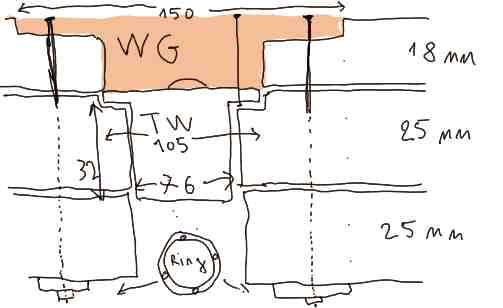

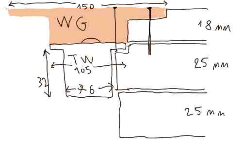

hi
now that i 've got the round wave guides, thanks to Joel,
i'm trying to figure out how to install the tweeters
i've done a very ugly sketch : it seems to me that the tweeter is screwed onto the wave guide but not onto the wood panels
only the wave guide is screwed to the front panel (maybe the screws are long enough to go somehow into the sub front-panel)
if it is so, would it be useful to use longer screws, 75 mm long, and an a sort of metallic ring of 150 mm external diameter to get a stronger tight ?

I mounted my tweeters to the waveguide and screwed the waveguide into the sub front panel as you outlined. I just used the the wood screws Joel sent with the waveguide and they worked fine. The fit seems very tight.
That said, you could use a long threaded screw and a T-nut:
T-nut - Wikipedia, the free encyclopedia
That might be easier than machining and aligning your ring concept, although I do like the ring concept.
