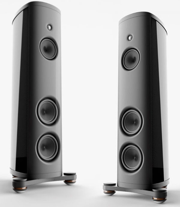

To fight diffraction, roundovers should be much larger; think 2 inches radius. Check this Magico loudspeaker.
But I get it that this is not doable in an Elsinore.

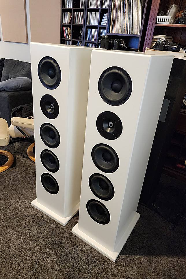

[Upcoming aluminimum "NBAC" version, shown without the IsoAcoustics base it sits on.]

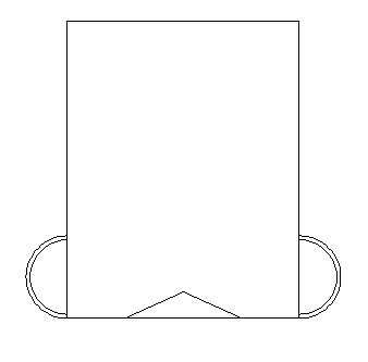

Here's an alternative. It would be relatively easy to take a 100mm diameter cardboard tube and split it down the middle, thus reducing the change in baffle support compared to rounding the existing cabinet.

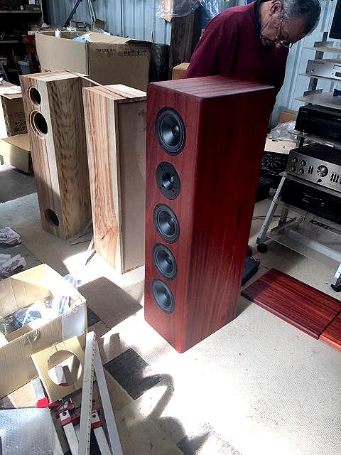

When I first posted the Mk1 design, it was published so that even guys capable of plain square butt joints could build them. Just good old square corners. Now we have access to stuff and the situation has changed. Yet anybody with a Mk1 Elsinore can find a way to upgrade them to Mk6 because the fundamental box design has not changed. So that is something that pleases me no end. Yes, some customisations that are common sense, they can still be done. But let us see if anybody takes up your suggestion? :nod: OR o_O
Back from a short holiday and came home to see the re-lathed waveguides by Steve in Melbourne having arrived, so hopefully we will have a solution to supplying "NBAC" waveguides based on the current "MFC" waveguide that we have all been using with the D2608 tweeter (and that includes "ULD" version too.
Just to categorise the three different versions of the Elsinore Mk6, they can be described along these lines:
"MFC" is the allrounder that most should build, it has high sensitivity and there is nigh on near no amplifier out there that won't sound good with it and better amplifiers even better. The sound has been well described here on this thread. It is very detailed with no hard edges and it fits into most people's systems, but room placement is always a key. This is the version that 90% of you should be building and if you have any doubts as to which version, then just build this one.
"ULD" is the Elsinore taken to the max, albeit at a massive price increase. It has the edge on the "MFC" is the purity of it sound and also sounding slightly faster. It may also be a tad 'cool' sounding, but also very pure is the gain. The "ULD" is for a few people. Sensitivity is the same, so any amplifier can drive it. It will go louder than any of the other versions and has extraordinary power handling, one that will probably never be needed. It is also suitable for very large rooms.
"NBAC" is a specialist version of the Elsinores. Maybe a poor man's version of the "ULD" could be the answer, but it is not that simple. There is a significant drop in sensitivity and it requires at least twice the power from the amplifier. In fact I will soon be doing a more accurate measurement/assessment and it may well need 3-4 times the overall voltage and current taken into consideration. The impedance around 10KHz falls to 4.5 Ohm and is the lowest of all versions. This speaker sound more like a "ribbon" speaker that I have ever heard any dynamic speaker sound. But that is my personal assessment. I like it and use it with a 30 Watt Triode amplifier. But the "NBAC" is not for everybody.
(No description of the "NRX" version above as it is based on a discontinued driver, but it fits along the "MFC" in performance).
I hope the above is helping in making your choices.
The "NBAC" details with +crossover schematic will be published soon. The driver is exactly the same as for the "MFC" in every way, only the drivers, waveguides and Crossovers are different.
