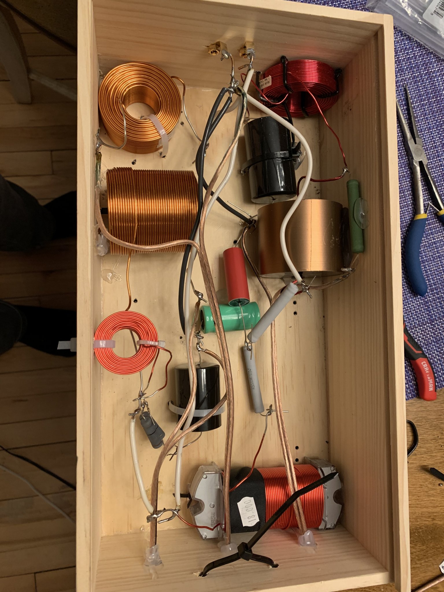

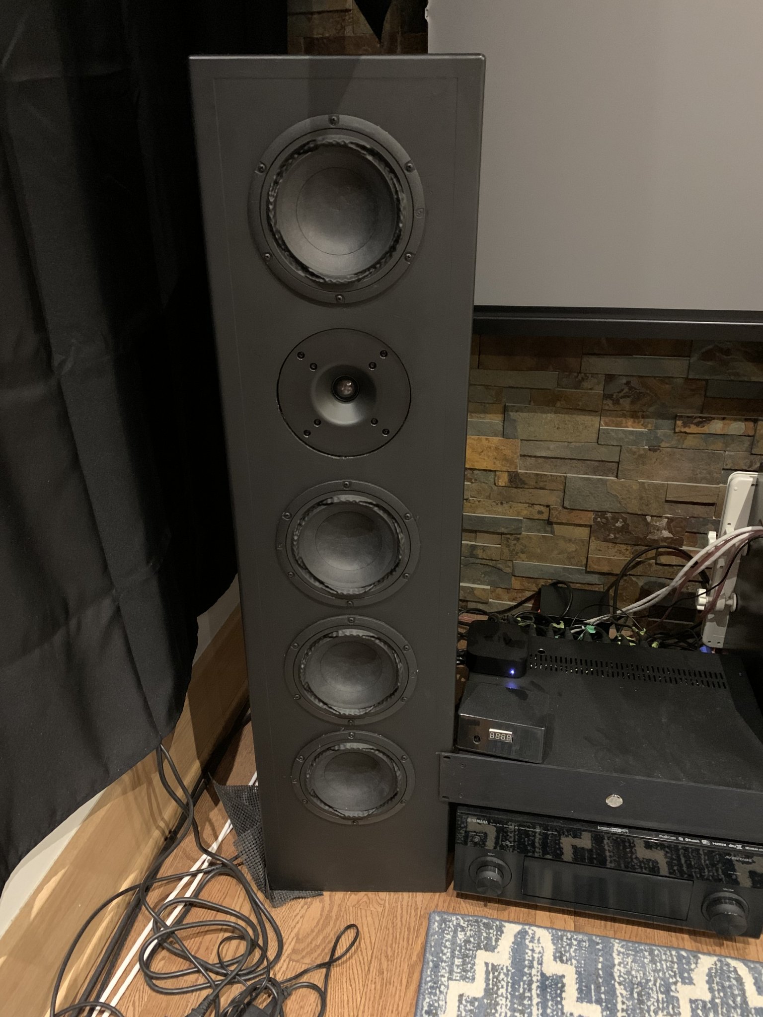

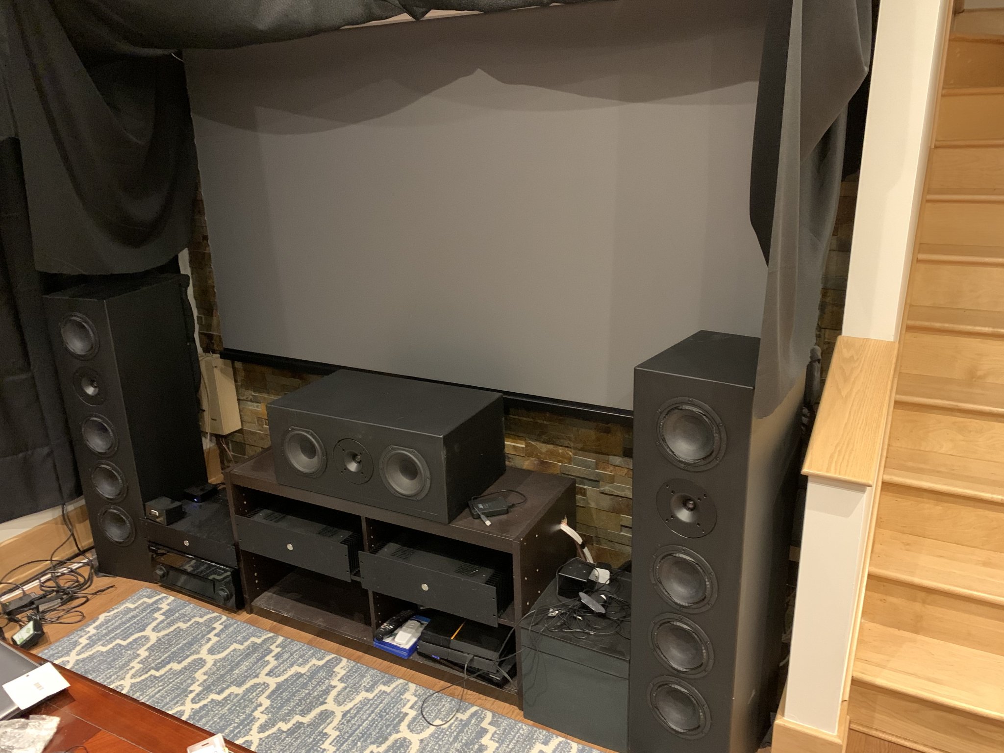

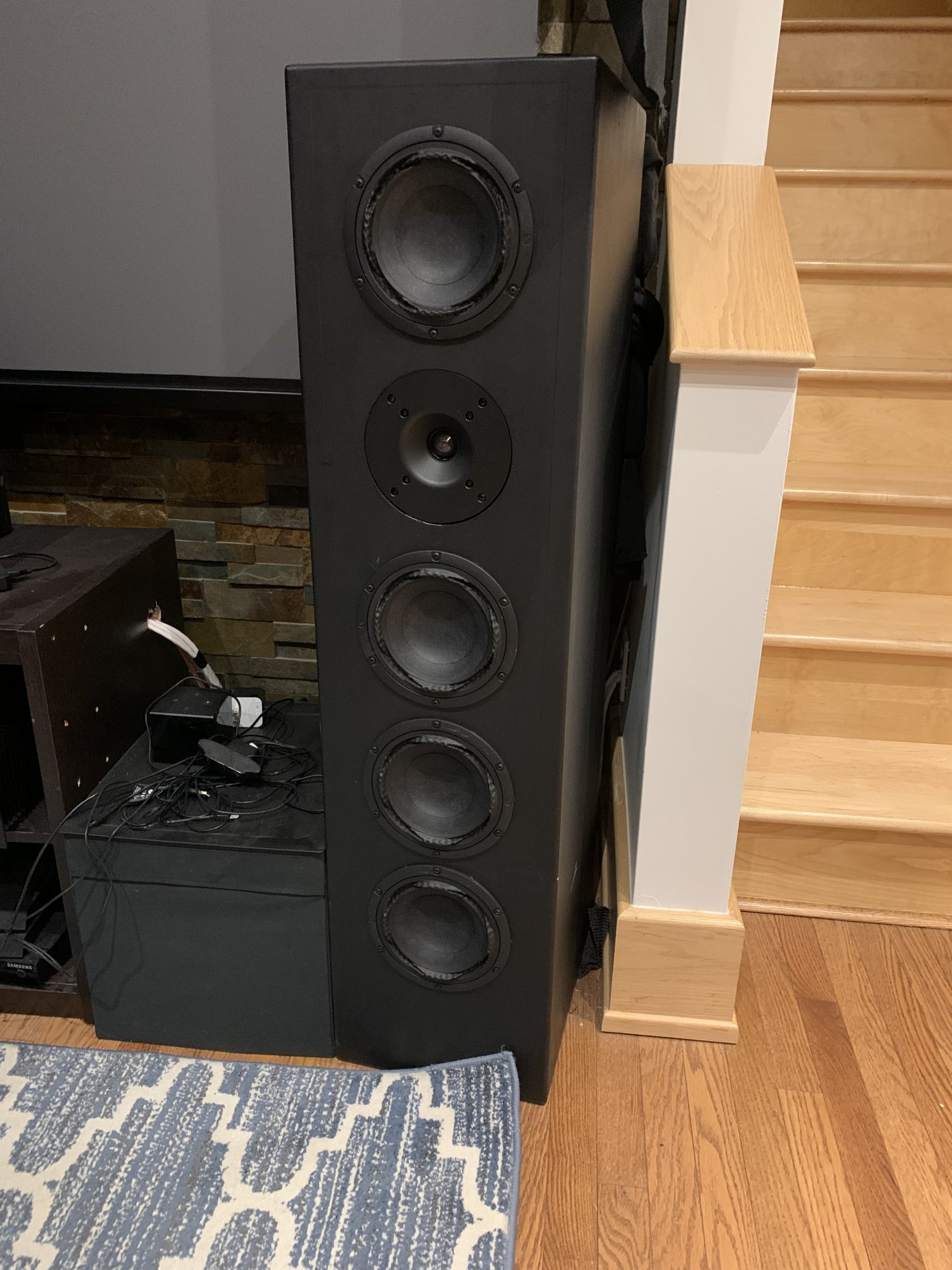

Got the crossovers changed over last night. As mentioned, I already was running the Purifis in my Mark V so given they were already mounted, it was overall a pretty quick transition. Also re-shortened the port to 80mm length for tube approx 86mm in diameter.
First impressions are very similar to when I swapped initially - the Purifis are able to resolve a lot of detail. Voices to my ears sound a bit crisper than before. Speakers remain very balanced, and overall vs my temporary config, everything is now more refined. Overall they sound terrific Joe - I’ll post more as I listen more but my initial impressions are these are easily the best speakers I’ve heard. Thank you so much for your work!
FYI my setup is a modified Yamaha cx-a5100 which has a ESS Sabre 9016 DAC, with front outputs bypassed from after the DAC before volume control IC to a custom external Muses chip based volume control preamp, then to a set of neurochrome 286 amps. Overall the system with your speakers (including a HDS era Hamlet center - insert Purifi Hamlet plug here ;) )makes a fantastic heart of my home theatre.

Was watching the movie Incendies last night - this movie has a couple of scenes with tanks and buses rolling by. One of things I love about these speakers is they project so well that in these scenes the sound of the scene environment envelops you - the power transfer into the room lets you actually feel the low frequency effects like these tanks passing you by. Another scene I use to demo is the final episode of Mandalorian season 2 where the dark troopers are breaking down the blast door - their punches into the blast door create a thump with enough power to be felt as a shockwave in the room - without a subwoofer connected in my system. Notably some of this power transfer had been lost when I had initially installed the Purifis using the mark V crossover. It’s back now with the officially posted crossover. Just extremely happy with these.
Also - to clarify my above post the intake is 86mm ID, so similar to the 87mm Joe suggested.

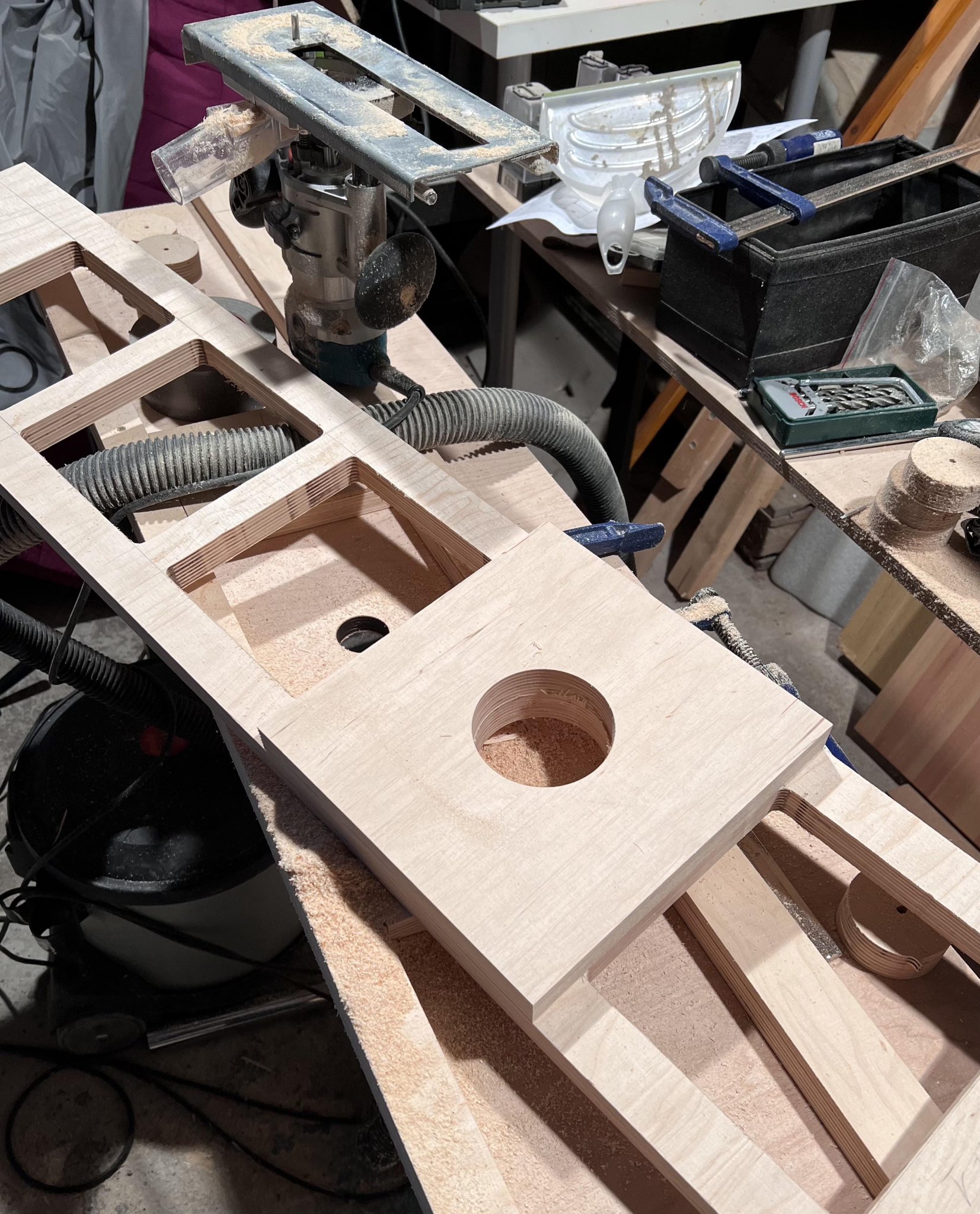

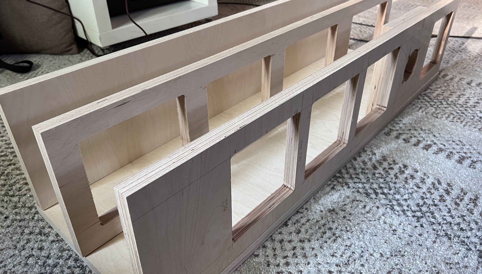

These are photos from over a month ago. Unfortunately, I have so many responsibilities now that the work has stopped. I already have all the components, electrical and mechanical, for the speakers.
It will be a few more weeks before I return to my workshop. I believe that in September at the latest I will be able to enjoy Elsinore ULD. If I resume garage operations, I will definitely show off my progress.

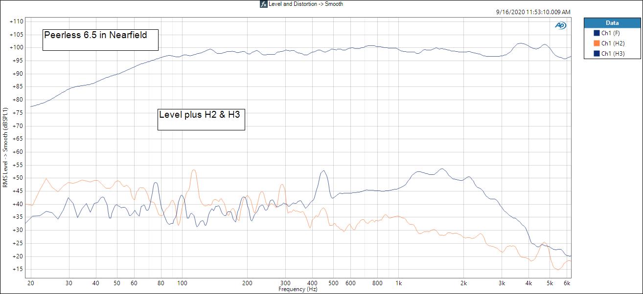

I have a pair of original made in Denmark HDS Nomex 830875 drivers in ~0.5 FT^3 sealed enclosures also installed in my bench speakers are original XT25 tweeters I just purchased a pair of D2608/913000 to test drive.
These bench speakers are similar to the JR minis in this thread.
If anyone can help, is there a suitable crossover circuit floating about?
For grins here is a test plot of the HDS Nomex 830875 driver in the sealed enclosure.
Thanks DT

Hello All,
There is a lot of nerd in me too.
I purchased a pair of waveguides that are on the airplane that left AU yesterday.
I have two pairs of D2608/913000 Tweeters on their way from Madisound as I type this.
Already on the shelf are pairs of XT25 and DX25 Tweeters.
I will post FR, Impedance, electrical phase and T/S Parameters of the tweeters and woofer if anyone wants to lean in and help with a crossover circuit for this not so mini pair of 2-Way sealed Bench speakers.
I tend to shy away from ported speakers that cross over too high because of all the port noise and distortions.
Thanks DT
On my bench; AP555 analyzer, AP Acoustic software and calibrated GRAS microphones.
