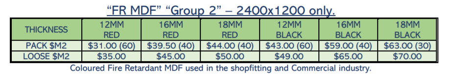

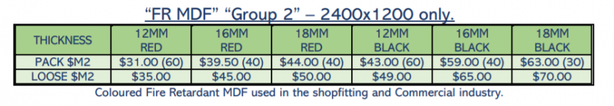

Valchromat or DMK does a Coloured Fire resistant MDFwhile i'm here. does anyone have any tips on where to get the black core HDF in australia?
Oh I know, just as anything DIY costs time, but at the end, I would have a CNC machine, as well as my cabinets. There is all manner of things I want a CNC for and I nearly ordered an Axiom i2r 6, from the guys at BGPRECISION in Melbourne. I even flew down to check them out in late 2019, but then both my parents passed away and the pandemic hit; putting the brakes on those plans. I had gone down to look at the i2r 4, but walked away wanting the 6 ...
I've already got the baffles modelled up. I had decided at that time that I would just buy a CNC, fully made and more importantly, fully supported. I was just using it as an example, because the quotes I got, I could have gotten a half decent kit machine.
Thanks @fluid. re DMK, aha, right, I didn't realize they had it. love those guys. I was planning to go visit them next time i'm in Brisbane, as I planned to get some ply and veneer from them as well. I wonder if it's the same product they have at bord. I think their main showroom is at the GC though. maybe a trip is in order. Gotta go down for XMAS shopping anyway ... ugggh.

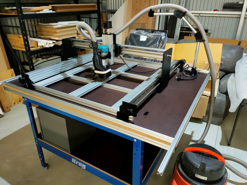

That is a nice looking machine and not an outrageous price for a completed unit. My own is somewhat similar with linear rails but still not runningOh I know, just as anything DIY costs time, but at the end, I would have a CNC machine, as well as my cabinets. There is all manner of things I want a CNC for and I nearly ordered an Axiom i2r 6, from the guys at BGPRECISION in Melbourne.
They moved to Molendinar but I would not call it a showroom. They have samples of most stuff to look at but it is basically a warehouse.I think their main showroom is at the GC though. maybe a trip is in order. Gotta go down for XMAS shopping anyway ... ugggh.
Hmmm, Not really convinced by that audiogod66. They claim 0.1mm repeatability, but I cant see how that would be the case, given the mechanism. It also would appear it would struggle at (or just flat out not do) 3D contouring, being more of a '2 axis' machine in effect. the enormous work area possibilities are a bonus, but buying something like that direct from Italy, with no local support and nothing else like it around, seems like asking for trouble. Not cheap either and seems pretty slow. unless you absolutely need the huge work area, I would definitely buy something like the i2r range locally before that.
aha, ok, so just down the road from griffith uni, GC. Thats where they have their fabrication factory too isnt it? They will do CNC for you using their stock too on site IIRC, but i'm not sure of their capabilities.
Yes, very solid machines, trickle down tech from the more industrial axiom AR range really nice guys at BGPRECISION too. Yes. being me, I was convinced for a long time I would build a machine to get better value, but the more research I did and given my noob status in the field, the more convinced I was that for a change, I needed it fully built and locally supported.
Yours is a Great looking machine though mate! what's the problem? anything the brains trust can help with? issue with the electronics? That must be doing your head in, having that there, so close to functional
Available time and mission creep, if I just design this 3D printed part that will make this work better and be neater etc. etc. .... and yes having it sit in the shed so close to going but not is quite frustrating.Yours is a Great looking machine though mate! what's the problem? anything the brains trust can help with? issue with the electronics? That must be doing your head in, having that there, so close to functional
