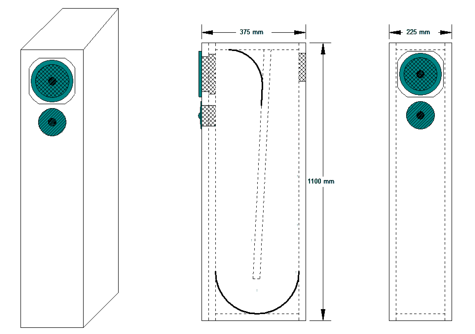

I did a design many moons (years) ago and I think this would qualify as an aperiodic TL. Note the single peak around 41-42 Hertz. It was filled of course. Your thoughts?

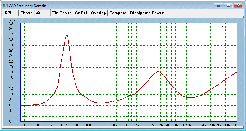

The impedance curve clearly shows that you have not gone far enuff.
While the line has been pushed heavily towards aperiodic as can be seen by the (nearly) complete suppression of the upper resonance seen in a box with a hole in it, a fully anechoic box would completely flatten the lower one as well.
So a heavily aperiodic TL, but not yet an aperiodic box.
I fully apperiodic box would have a flat iimpedance at resonance without the use of conjugate filters (as used in Elsinore).
An aperiodic box is the holy grail for those withing to use current amplifiers.

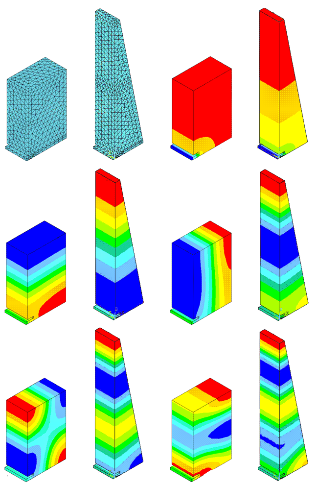

Given what we have learned it becomes very hard to equate line-length to tuning frequency. Any taper or restricted terminus throws that out. The only line were tuning can be estimated from length is a non-tapered pipe with a terminus = cross-section.
TLs can be of any length, I have designed a few on the order of 25 cm long, and they are very effective.
Since the advent of modern modelers the known TL/quarter-wave design space has dramatically expended.
The assumptions in a BR are that the box does not deviate significantly from a cube or sphere.
As one dimension increases, quarter-wave resonances start to occur. At some point they take over completely.
Given the aspect ratio of Elsinore, and the use of volume filling stuffing, Elsinore cannot be a BR as hard as the design fights the quarter-wave resonance.
The bif difference in terms of box design is that a TL with a restricted terminus (ie mass-loaded) is tuned lower than a BR of equivalent volume. We often see people doing this with tower speakers without knowing why (based on measures) they have to.
Compilation of MJK ANSYS simulation of BR vrs ML-Voigt (an ML-TL variant).
An ML-TL can range from maximum bass enhancement with just box lining moving towards aperiodic as more & more volume fill is added.

By the way, the impedance curve of your "TL" shows that it is obviously not working like a TL; apparently you overstuffed by far, it is more like a closed box, not even an aperoidic damped box because that should show a more damped impedance peak.

By the way, the impedance curve of your "TL" shows that it is obviously not working like a TL; apparently you overstuffed by far, it is more like a closed box, not even an aperiodic damped box because that should show a more damped impedance peak.
You know, I actually find that I agree with you on that. I aimed for that single peak (as far as I can remember) and it was to me a 'leaky' box in the same way that I have these plastic filled vents made many years ago made by Scan-Speak. These were meant to be 'leaky' so that a sealed box would look bigger to the driver and hence the Q and Fb would stay low and hence smaller box. The old Dyna A25 had that filled slot, similar sort of thing. To me my TL(?) was behaving more like that than a Baileys TL.
In your mind, what kind of output would you like to see from the vent.
To me this comes down to what the Z plot looks like and what is the vent output? Or if you like, is there a reflex action (a la vented)? Is there a Helmholtz resonator?
