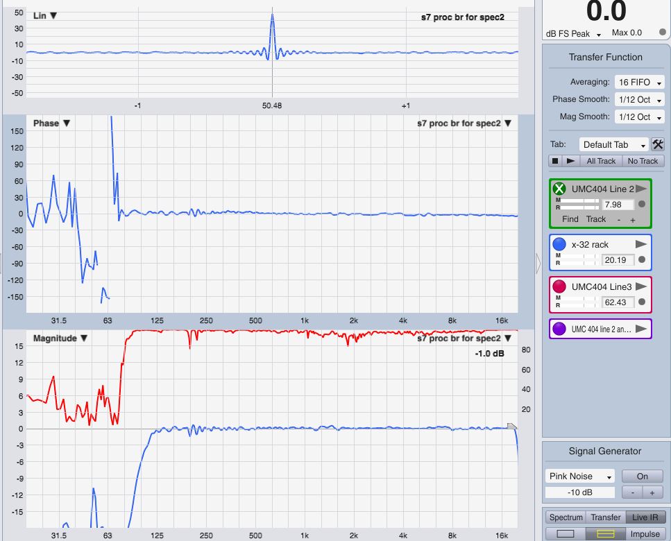

Your 91dB calibration setup/plot does indeed look pretty neat.
And yeah, pink noise and RTA's are no way to do sensitivity, especially indoors.
Must say though, I'm not really a fan of RTA's for anything .....
I just use a mic calibrator, put processing in place, and then measure each driver section's sensitivity via the method previously described, outdoors.
Must do it driver by driver as all my builds are multi-channel active, FIR processed.
Below is a 3-way synergy with drivers spanning these ranges:
Mid 100-650Hz, HF 650 to 3k2 Hz, and VHF 3k2 Hz to 20k.
2.83V @ 1 m sensitivities, off a high deck outdoors are: (whatever the heck space you'ld call that )
Mid 105.3dB
HF 110.4dB
Vhf 106.6dB
I know sensitivities like that scream PA, but I've found the cleanliness and dynamic headroom at everyday home listening levels, make lower sensitivity/ lower efficiency speakers, sound quite weak and constrained.
I'll say it too, Pretty Neat, eh ?!

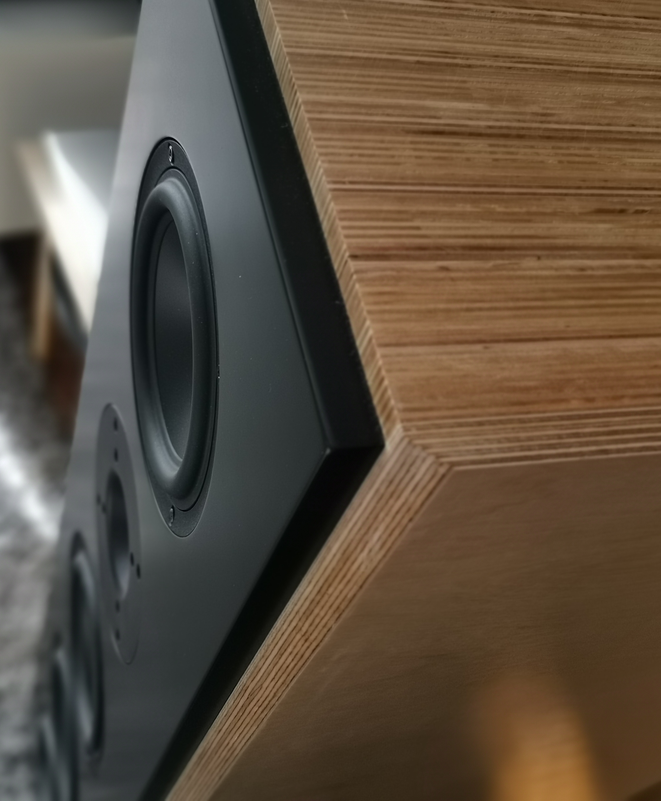

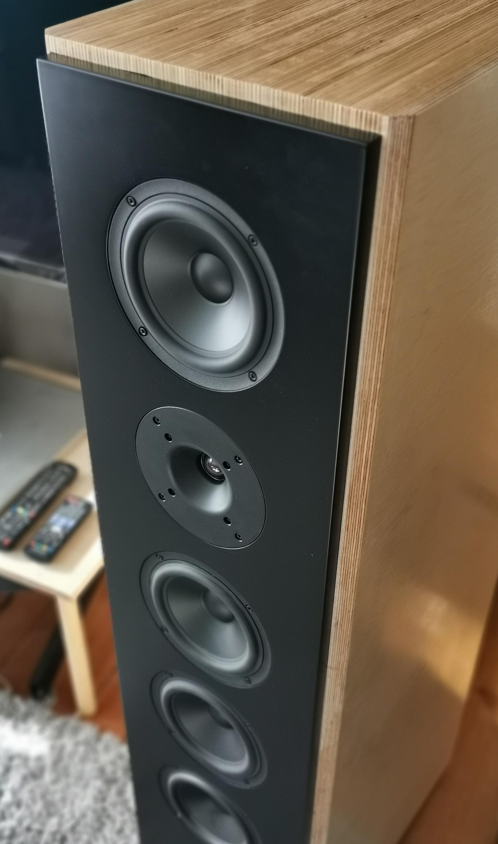

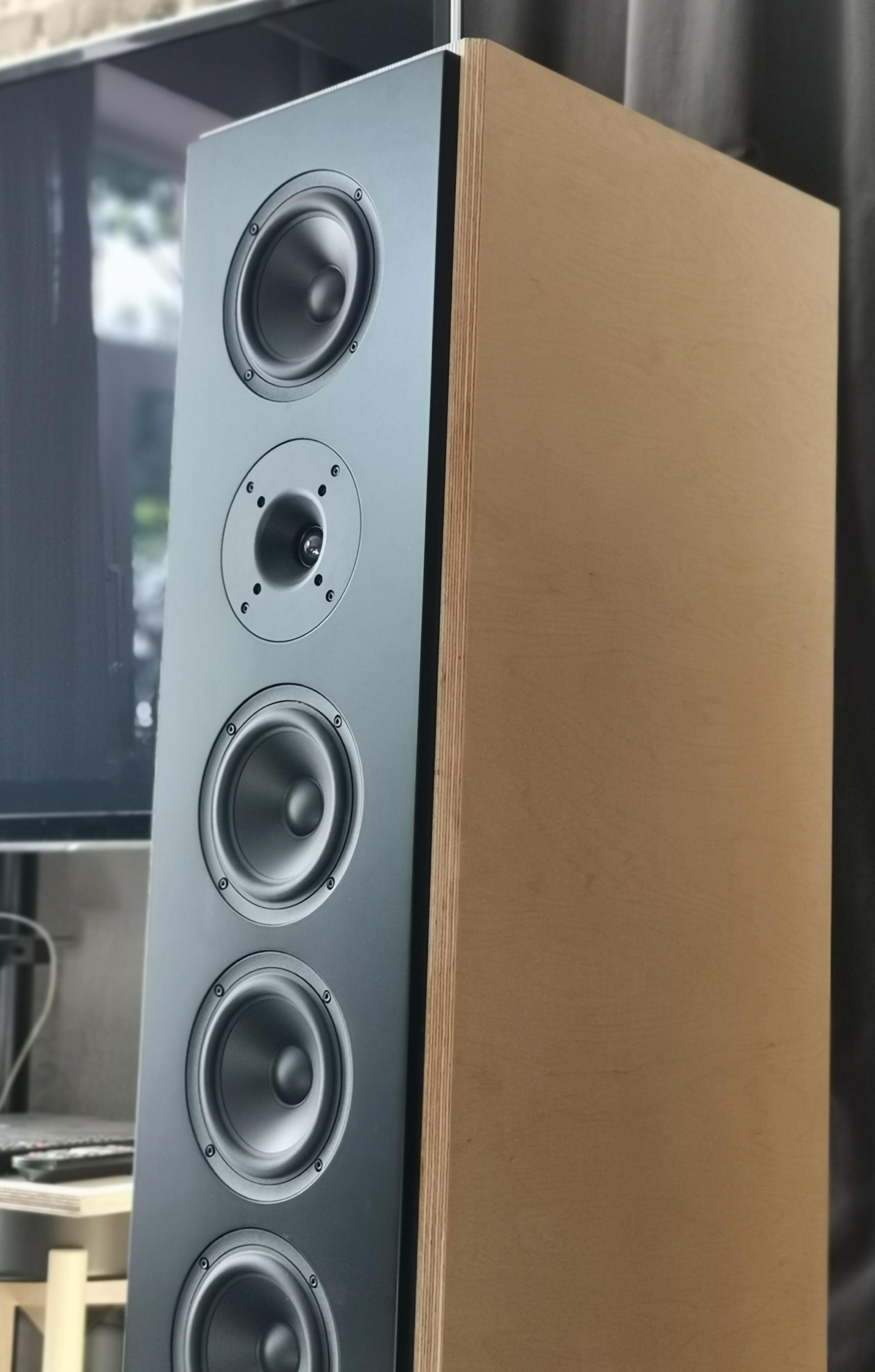

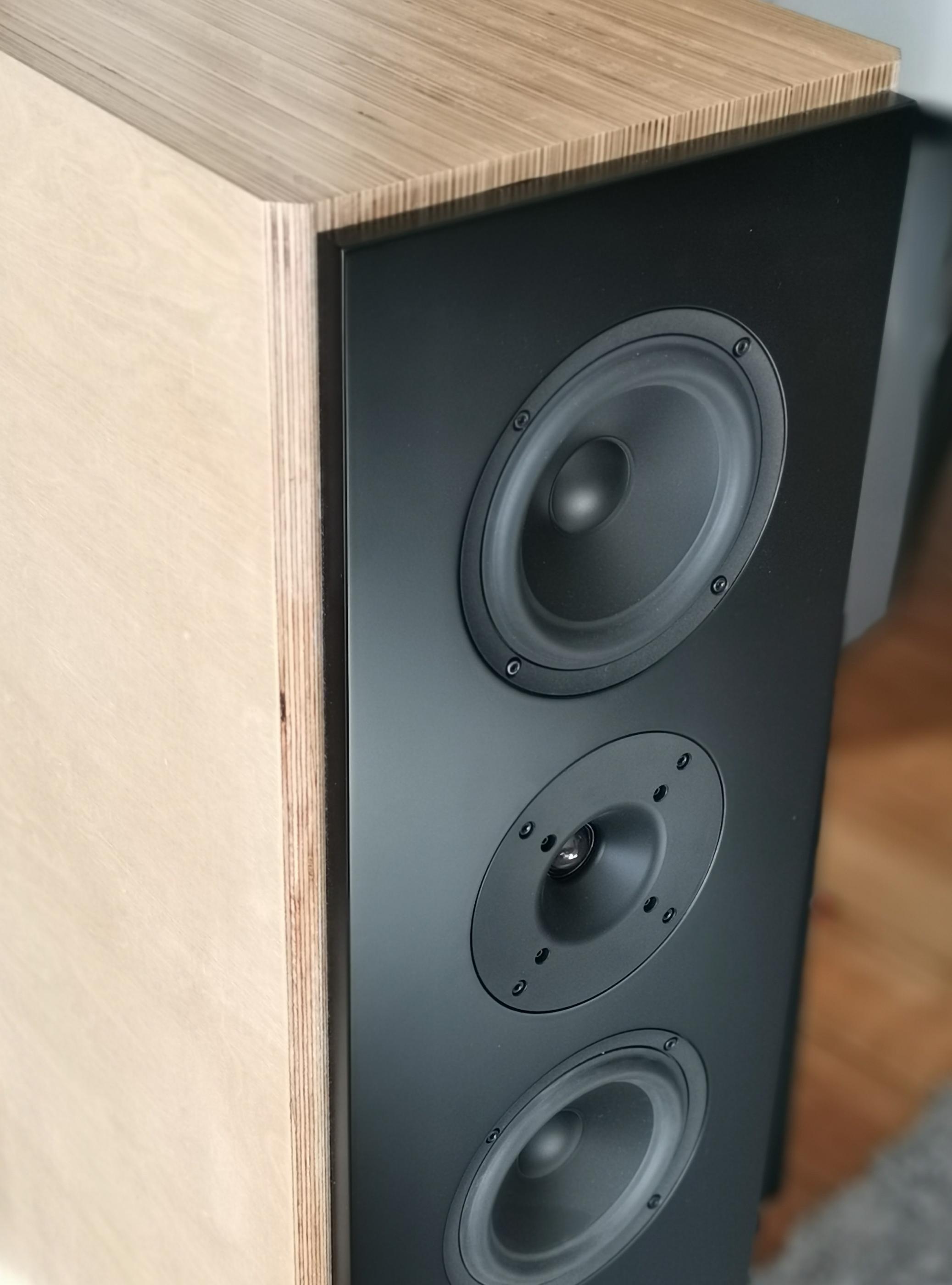

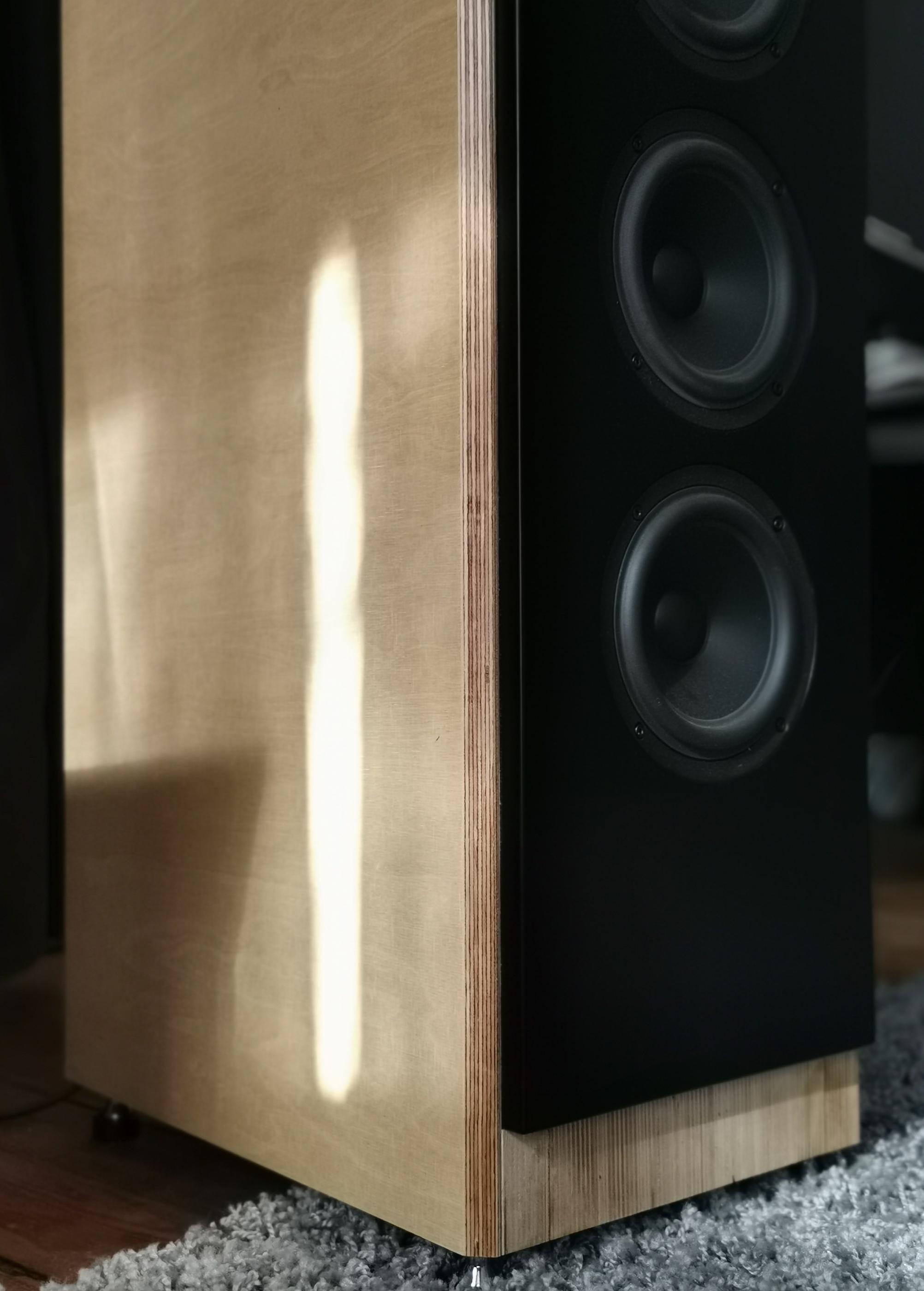

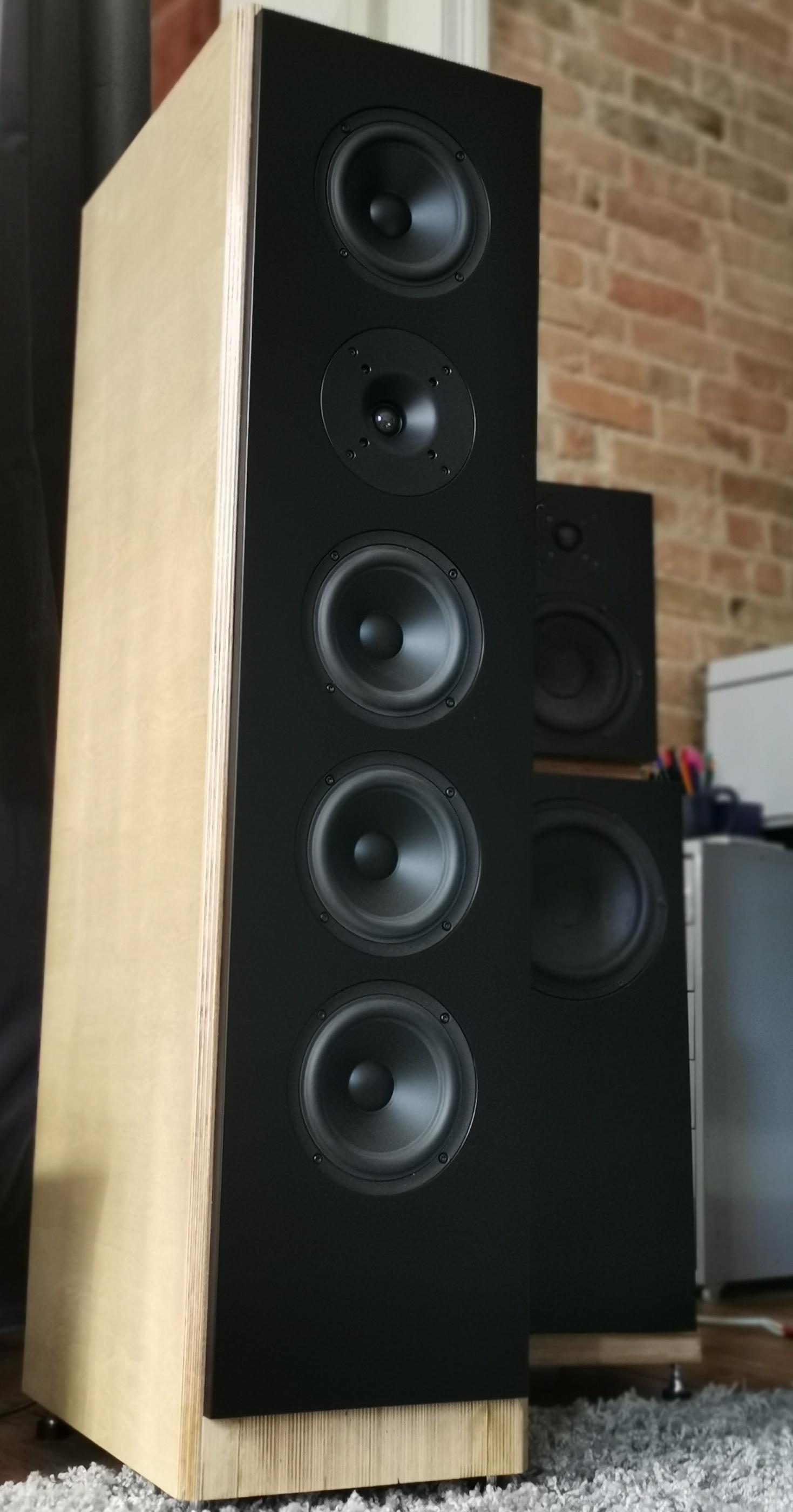

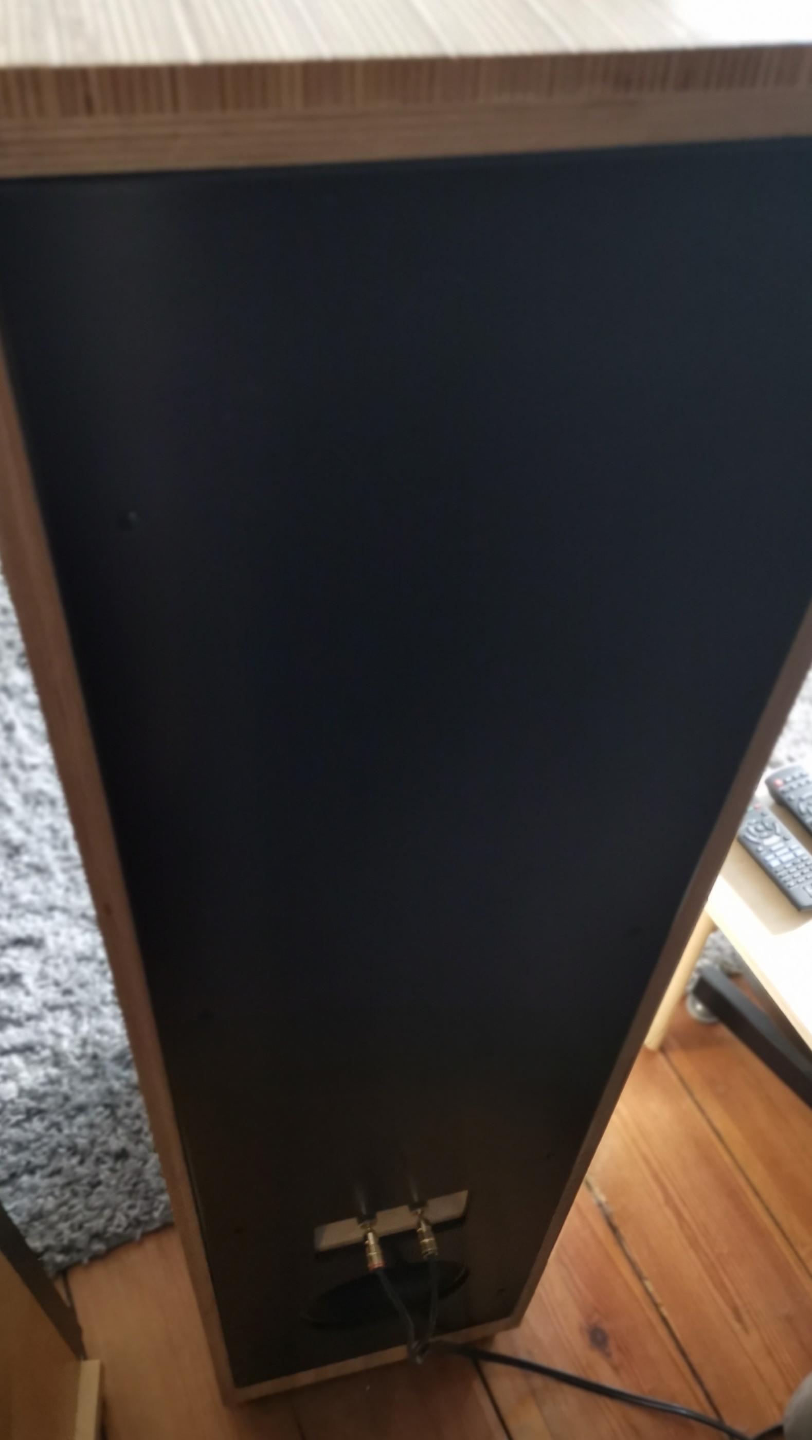

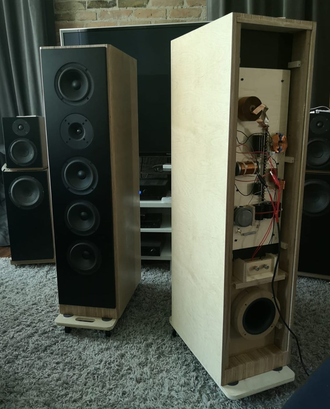

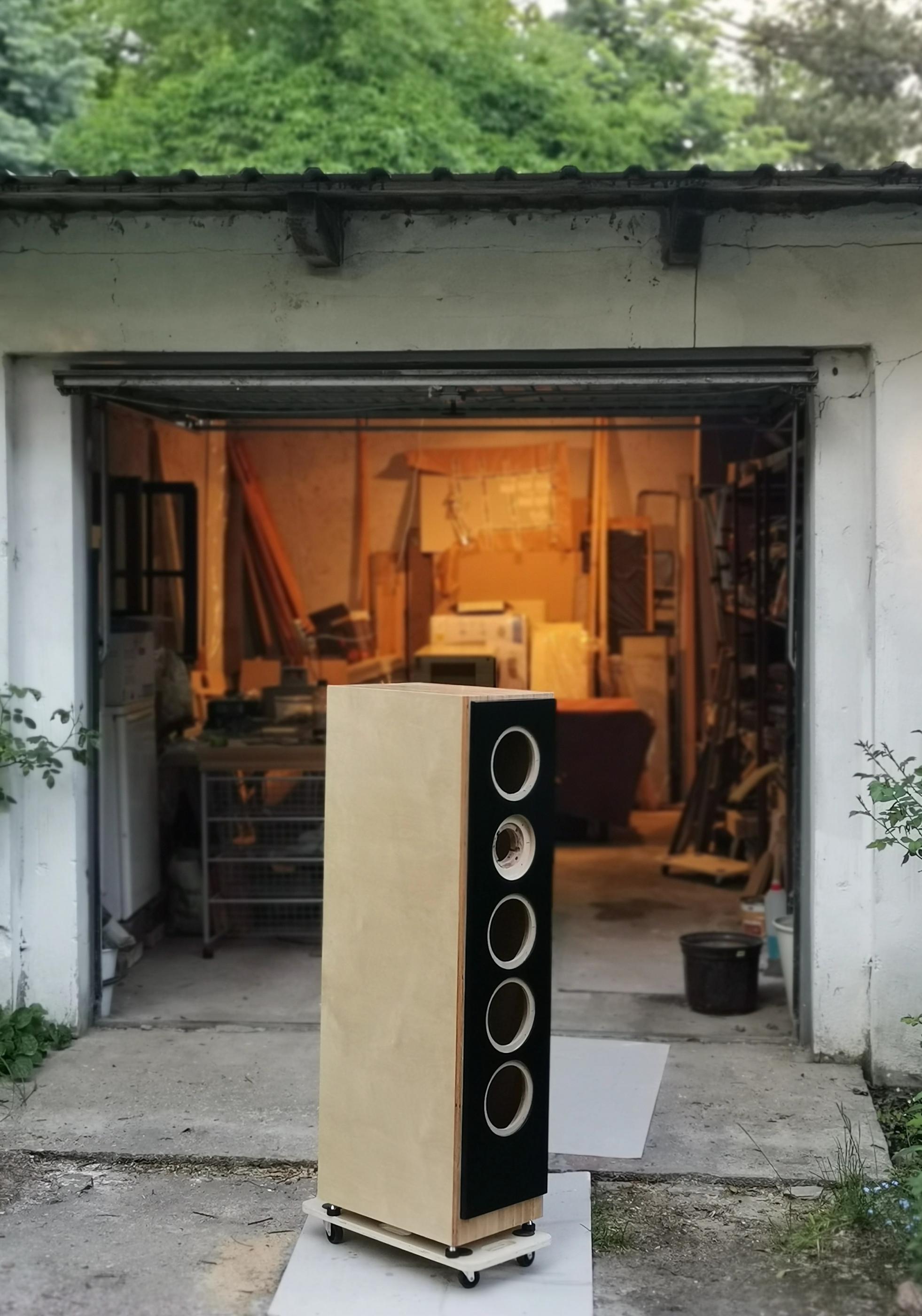

And here they are. I planned the end of carpentry work at the end of May and succeeded. Today I made my children's day and connected all the speakers and set them in the room. Oh ... I didn't expect that. Each of them is 70kg. And this is because it is a box in a box. The original size of the casing received additional support from plywood panels. The edges have been chamfered and the front is sized according to the design. The steering knuckle is closed with a lid on the back. BR got the right housing to connect to the cover. I am a master of complicating and adding work as much as possible. But I have already reached the shore. Working in spare time from mid-January today has a finale. It's time for music. Thank you Joe, it's a great project.
In the background my kits have been playing for me since 1997. I like them very much so they will still play for me. Probably in a different space.

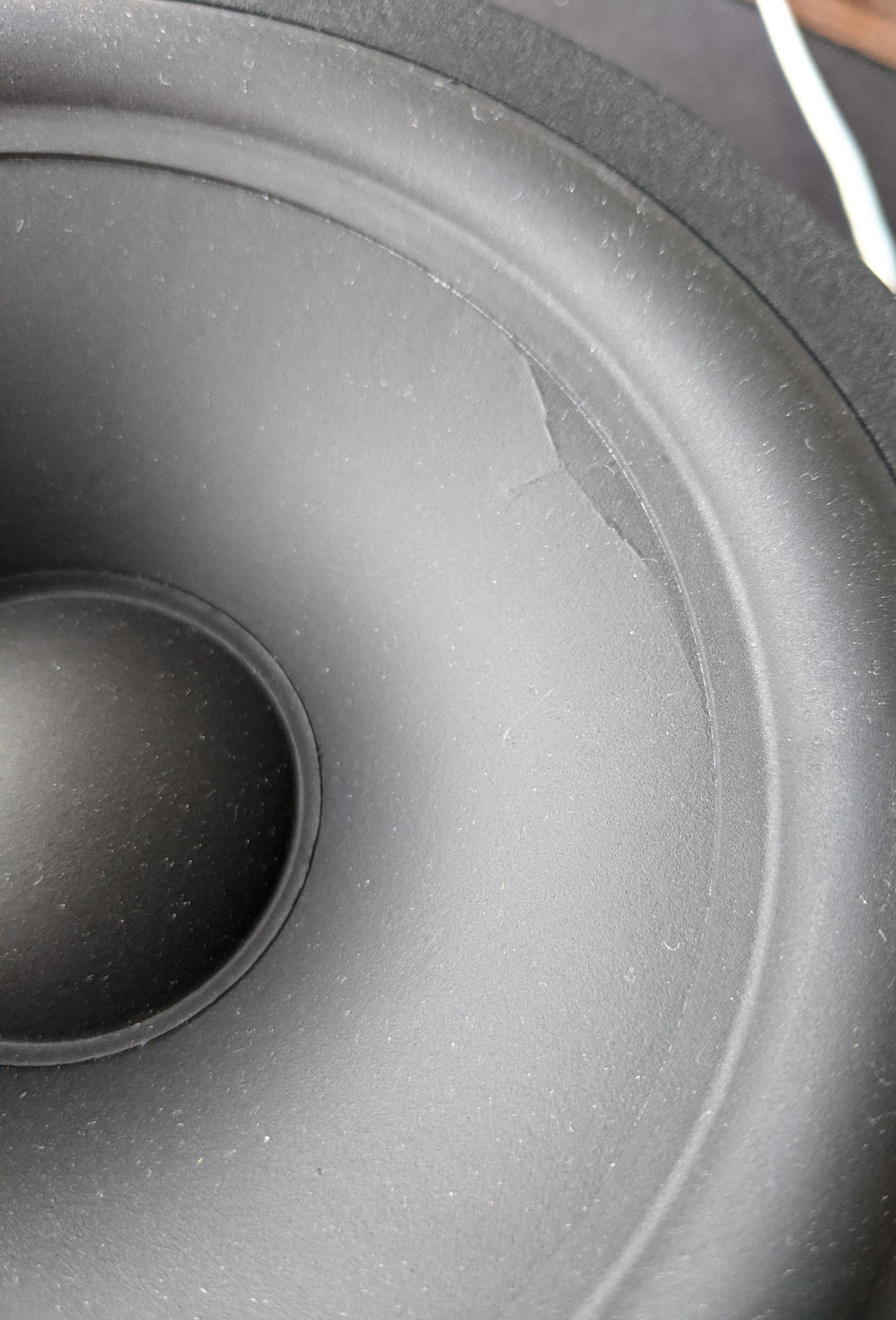

I have been slowly gathering all the parts for my build. Looking at the woofers today I discovered one of them has a imperfection to it. Might be a bit hard to see on the picture, but it looks a bit like a paper fold in real life. What do you guys think, is it still usable or should I try find a replacement?
