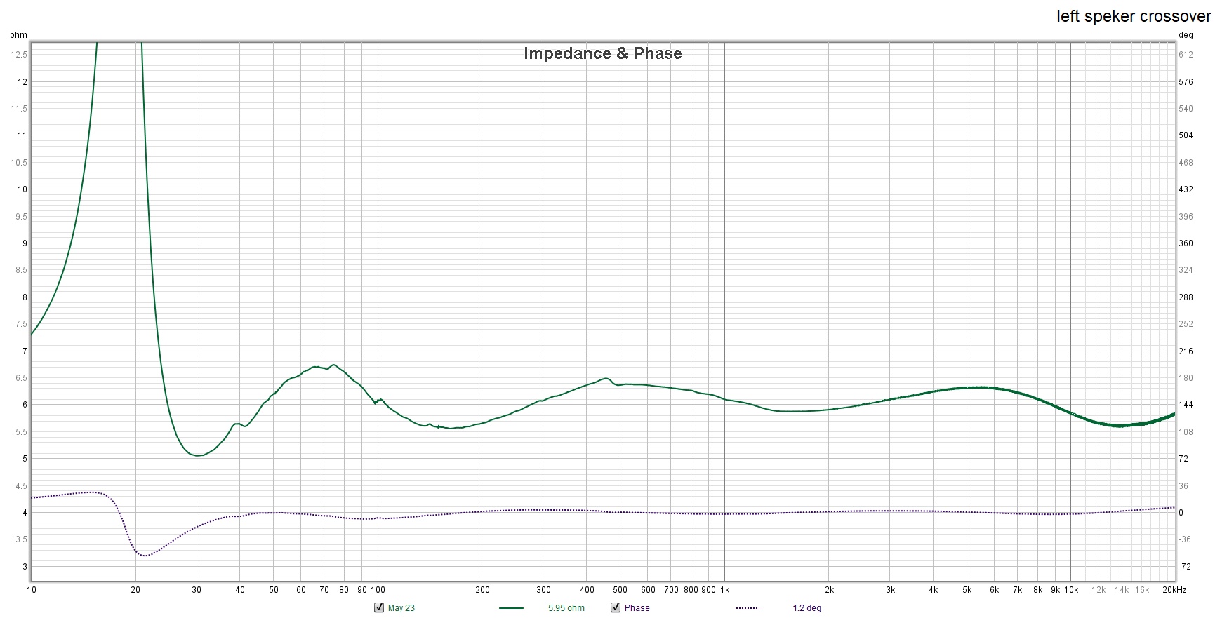

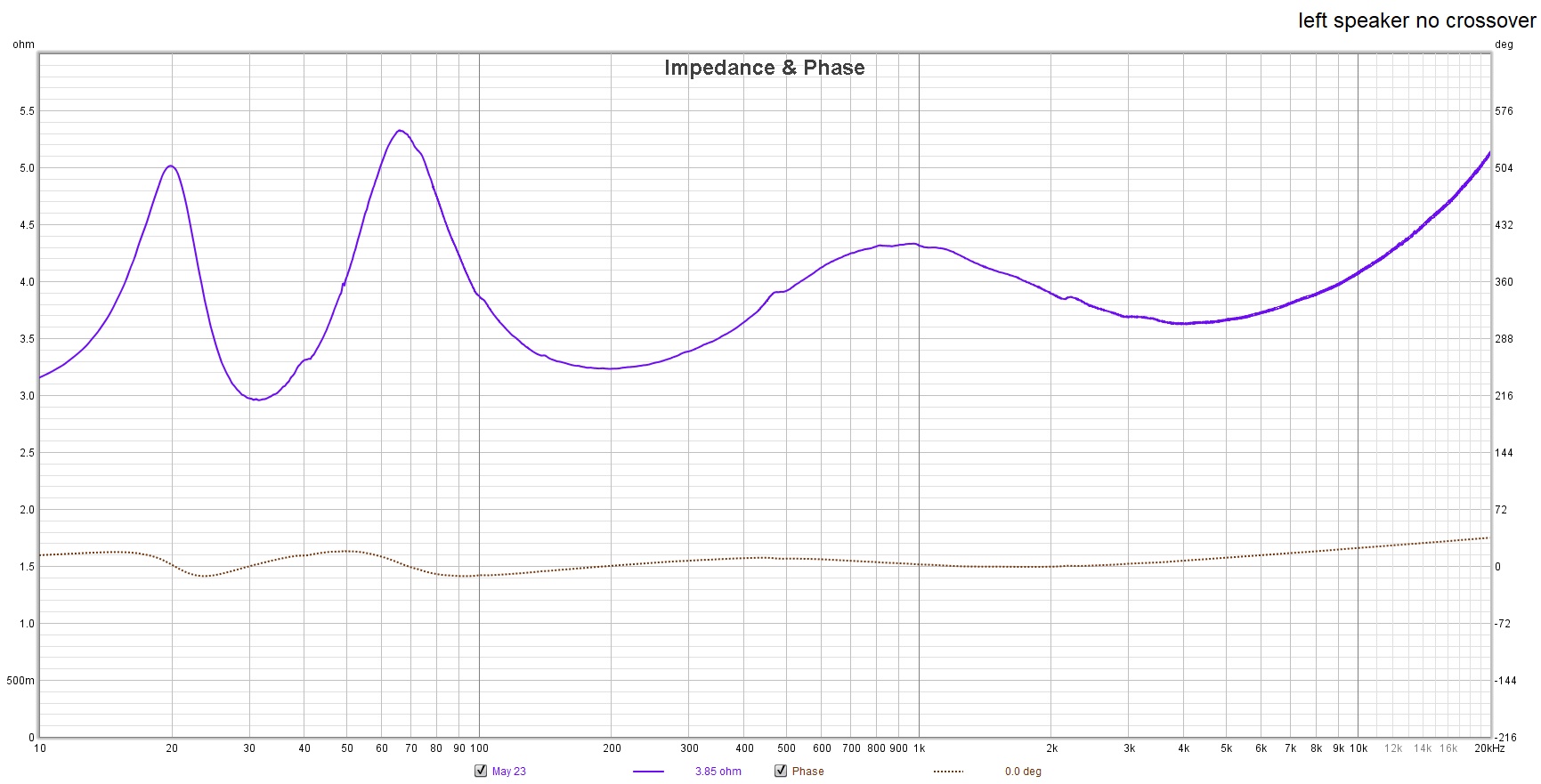

Looking at your "no crossover' curve again, there are two interesting features.Well finally I was able to tame the measuring device
Now I have this two measurements with and without crossover. I didnt add the stuffing yet. If I understand those little bumps are standing waves? But other than that do these graphs look like they should? There is some difference in tunning frequency between the two should I tune with or without crossover?

View attachment 846781 View attachment 846782
1. The bass reflex peaks are not very high.
2. There is no steady impedance rise at high frequencies, but rather a broad bump, and then another rise.
Did you maybe connect/include the tweeter in this measurement? It would be better to just measure the woofers alone.
