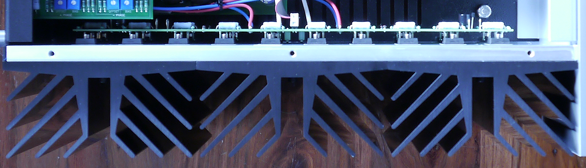

Dont place any aluminium sheet, between cooler and mosfets.
But separately PSU is good idea.
This is pass labs XA30.8 Amplifier .There is an Aluminium sheet between MOSFET s and Heat Sink .
That's not a sheet. It's a thick slab. Basically part of the heatsink.
Something was needed to hold all those separate Fin extrusions together.... likely Ali because Copper would have been Too expensive
To Marc Brown: Using a PowerOn, connect (+), (-), (G or common). You do not need to run earth to the amp chassis. I did a dual mono using a SpeakOn (no high voltage AC here) to each channel and ran +, G, -, G (there are 4 conductors) with a 12-4 cable. I connected the amp chassis to G but did not notice any difference. The G of each channel is connected to earth in the PS chassis though the CL-60 paralleled with a 35 A bridge rectifier (as F5T manual and 6L6 show). Also, follow Zen Mod's advice with space and cost being the limiting factors. I put 54 mF per rail per channel near the amp PCB with a large CLC back in the PS chassis, and it is dead quiet. You may try moving the PS chassis away from the amp chassis to see if it sounds any better (quieter).
It is not part of the heatsink it is a heatspreader to assure that the heatsinks dissipate the heat as uniformly as possible.
I would also call your attention for the " L " brackets NP sugests for the new SONY VFET amp as a heat transfer means to the heatsinks.
Once again : "stay away from absolutes" and use good judgement.
Engineering is compromise.

However, you think about factory production conditions. But our friend will does DIY. For me, full contact thin aluminium sheet and cooler is so difficult and he wouldnt do. Maybe compound can helps but in time it will need to refreshing. Disassemble all part and again assemble, bla bla... So i said to avoid from sheet.
Engeenering is foresight and optimization also.
Good words "Engineering is compromise"
I know what you try to tell and theorical your right "absolutely" . it was joke
Said like that i agree....thin alu sheet will not work because contact area with heatsinks will be very irregular.
As always the devil...and Murphy is in the details.....
