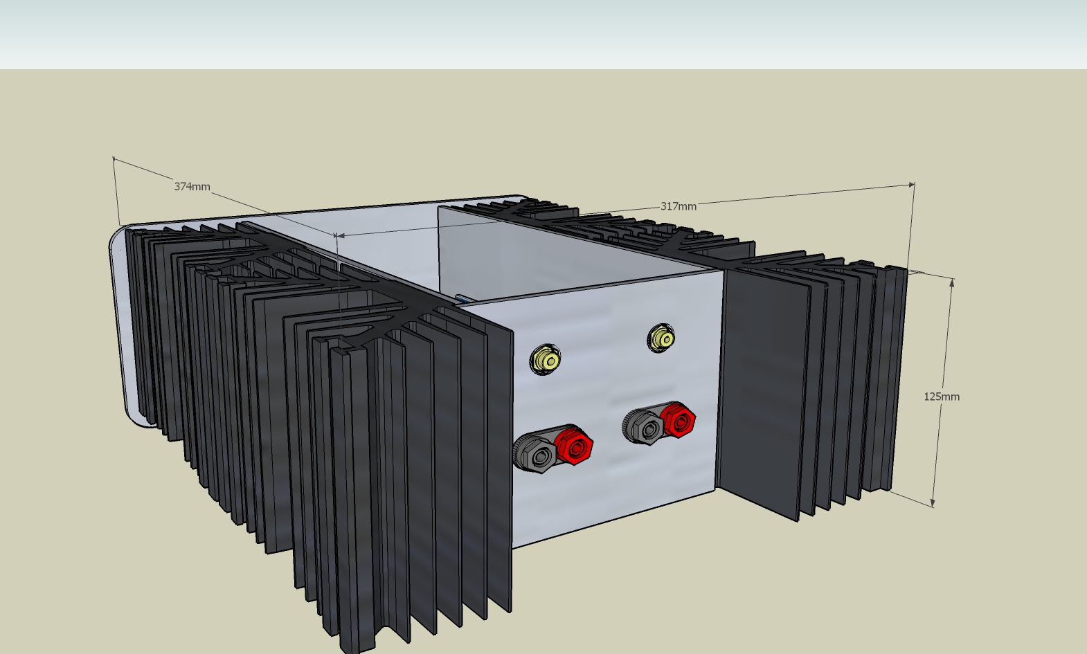

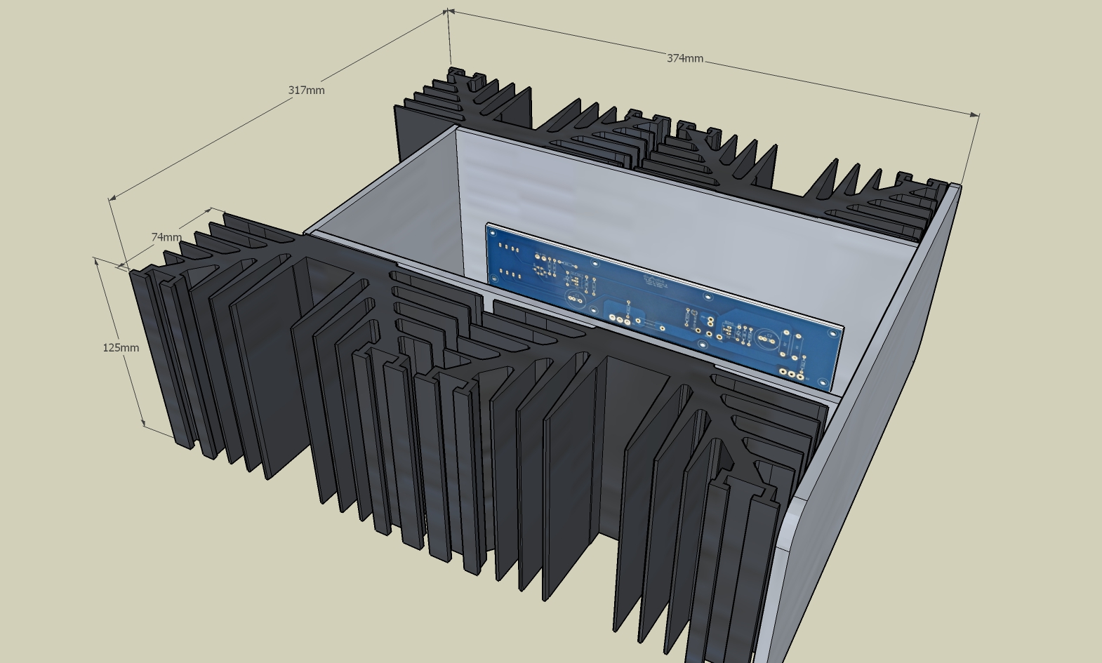

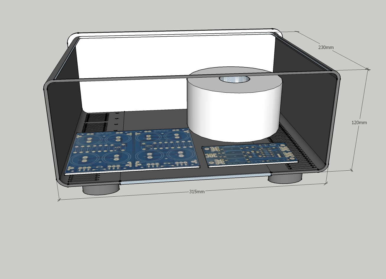

starting my F6 build
I've assembled my parts and have begun plotting my F6 chassis design. I'm going for a stand-alone power supply using a Galaxy chassis. When I picked an enlosure for a MyRef amp, I chose a 2U 330x236 Galaxy chassis. In designing the F6 enclosures, I wanted to go with a similar footprint. The power supply is going to be built into a 3U 330x236 Galaxy enclosure. The output section is going to begin life as a 3U 330x230 Galaxy enclosure. The heatsinks are Wakefield 133 Series.
Nice artwork!

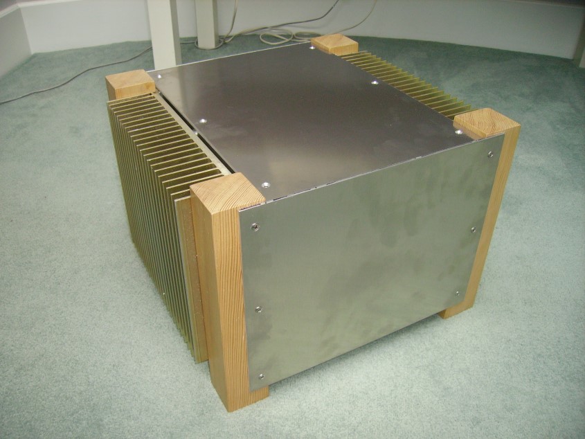

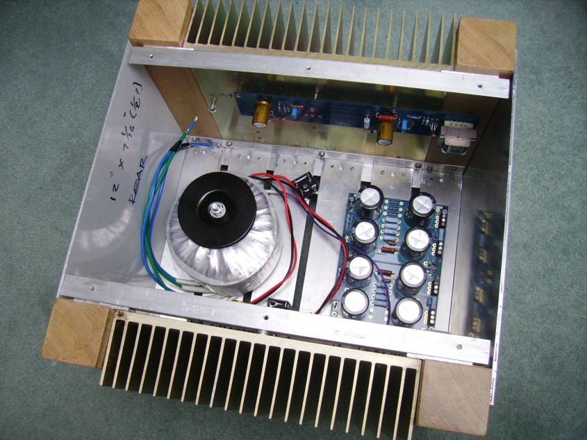

If you build your own boxes you may even go for a dual mono setup. This can give more options with placing them.
Also you may want to consider to have two filter caps close to the boards - or even double the PSU Boards and move them to the amp boxes entirely.
