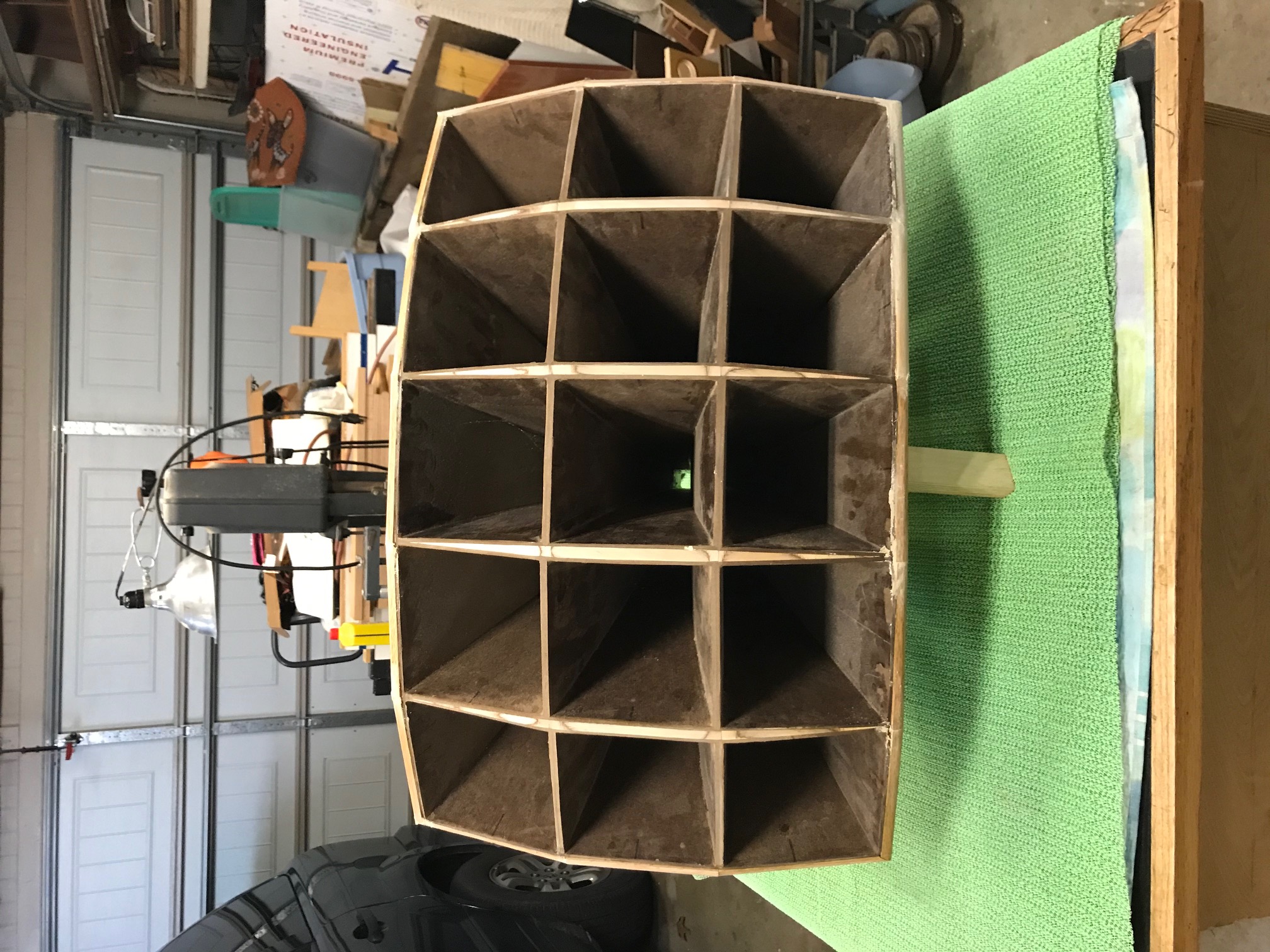

Around November of 2018 I started construction of a set of multi cell horns based in Peter Persson’s original post. I had an aluminum pattern CNC cut, based on Peter’s spread sheet. Due to cost and availability of high quality 3mm ply in my area, I used 4’ x 8” sheets of Masonite to construct the horns

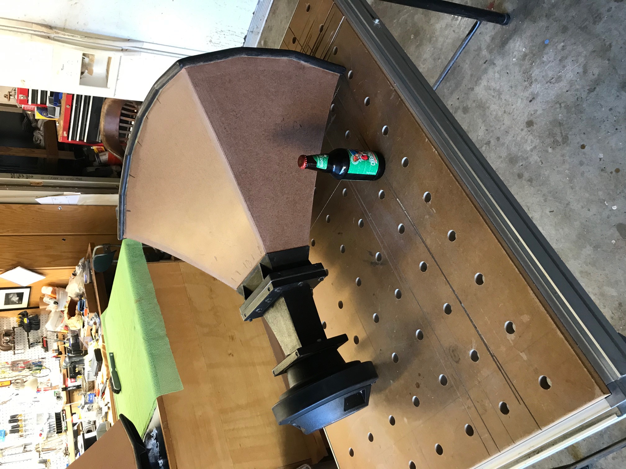

The Masonite purchased is a little thicker than 3mm, so I adjusted the size of the aluminum pattern to keep the assembled ID of the horns as the spread sheet suggested. All pieces were cut out on a band saw, then cut with a 45-degree router bit mated to the pattern. The cell ends were cut to length “batch style” with a chop saw. This took me around 4 months on and off to complete.
I assembled each horn as seen the original pictures - documentation, with wooded squares, sliding over the jigged cell walls compressing the sides to make each horn. With each cell made I decided to apply paper mache to each horn over the lengths, leaving the very ends un-papered. My reasoning is the same as discussed in previous posts, damping the horns and to make the 45-degree horn sides stronger. I applied Roughly 6 layers of 24 lb/ream paper to each horn cell.
Cells were assembled as suggested, then the cell large ends were filled in with hard wood, each had to be hand shaped and fitted, as they do not flange up as you would think. I started thinking of additional vibration dampening and decided to enclose the horns with Masonite and fill the internals with a sand and granular rubber I used from other speaker projects.
I made the horn Driver adapter in the same manner as the horn cells and fill the inside of the adapter with Durhams Wood Putty – Worked great, as per Peters instructions.

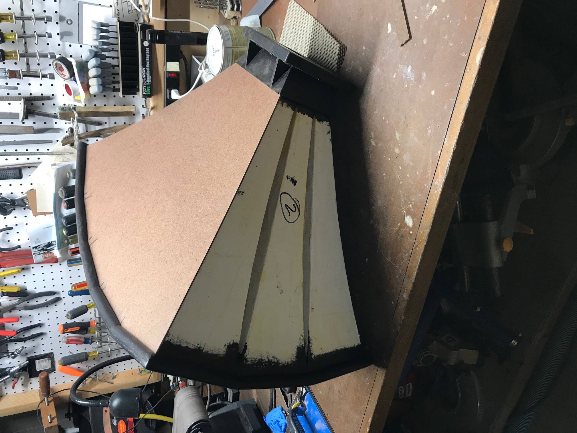

I am driving the horns with a set of used JBL 2446H drivers, I have measured and listened to these horns cobbled to my home set up and have been blown away. The original Maxell tape “blown away” has nothing on the speakers. The dynamics are fantastic, and the sound is LIVE. I am extremely impressed with the sound, coming from conventional cone-based line array systems. I am still early with integration as I only have had the horn up and running for a month or so, so very early in my journey…….
The one issue I am having now are the JBL drivers, my ear thinks they sound great, but I am seeing measurement issues. I post some information a week ago concerning possible diaphragm ringing, and a +5 dB frequency rise at 1300Hz on the multi way forum at:
JBL 2446H Measurement interp
I anyone has input to my questions Please respond. Most likely I will purchase a new set of diaphragms and remeasure the drivers alone and with the horn attached

Awesome build Tom! However I see nothing that would upset me in your measurements. What do you see that disturbs you? Most of the graphs show a long window, we see the DUT (device under test) plus whatever happens after that (in a room or wherever the measurement was made). Even for such a long time window it does look pretty good.
Even the IR looks normal to me (though it is inversed) and I don't think the FR curve looks bad either. What makes you think something is off?
