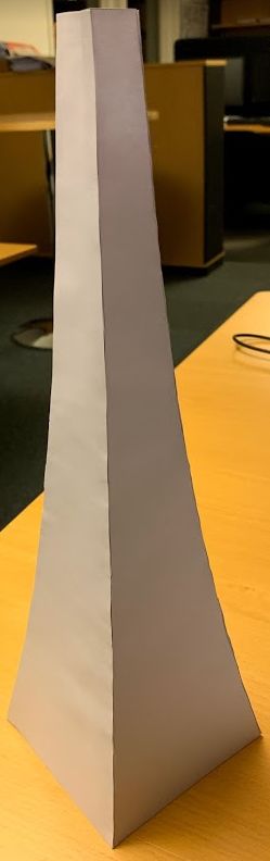

Since there is so much polyester inside, I wonder if a multicell horn like this could be made from hard paper and some paper tape. In my youth, I made quite a few paper models and I think as a base it could work. I would glue the cells with paper tape, then spray with transparent lacquer (or paint by expoxy paint) to get some strenght and make the adapter with a 3D printer. The paper is thin so it might be necessary to laminate the front part. I will try to make two smaller cells as a proof of concept. It that will work, I will share the results and maybe make it into a full horn. These just look awesome and hopefully will sound awesome as well with my JBL2445 drivers.
Joined 2008

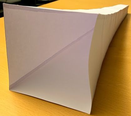

So I think paper could work for the construction. The pictures show 35 cm long cell made out of standard office paper with glue stick. It is far from perfect, but it lead me to an idea. For a 50 cm horn, a 3D printed inside mold could be done in 3 pieces (or maybe in 2 on a larger printer). The sides would be cut out of thicker paper, taped to the top and bottom of the mold - and then glued together from outside with paper tape or maybe by strips of paper with PVA glue. After the glue dries, still on the mold, the paper would be painted or sprayed with lacquer to gain some strength. Then it could be taken off the mold, add another layer of lacquer, it should not warp anymore. The rest would be the same as with the plywood.
By the way, I used hornresp export defining the throat and mouth area of a single cell with the selected cut off frequency and it did work quite well.
So now I will try to design the mold with proper dimensions (for a 183 Hz flare / 500 Hz crossover), since I have JBL2445 drivers to use. The driver attachment would be also 3D printed.

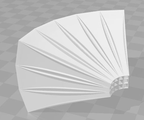

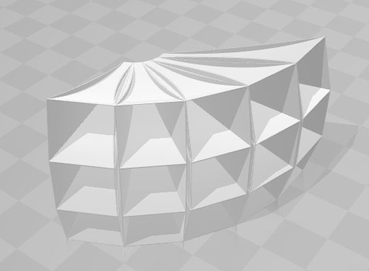

Dark and cold evenings in Denmark bring crazy ideas:) I started exploring the thought of 3D printed multicell horn. I made a model in Fusion 360, since the guy with the 3D printer confirmed that 1 mm wall with this shape and size should not be a problem (material/work price is a different thing...).
However, even when building with paper mache, there are some construction issues I will need to fight. I expect some difficulties while designing the throat flange. The difference due to the curvature is around 20 mm if I measured correctly on the model. That can be reduced to about 7 mm by cutting the outter walls of the outter cells. The number of lego pieces is growing:)
