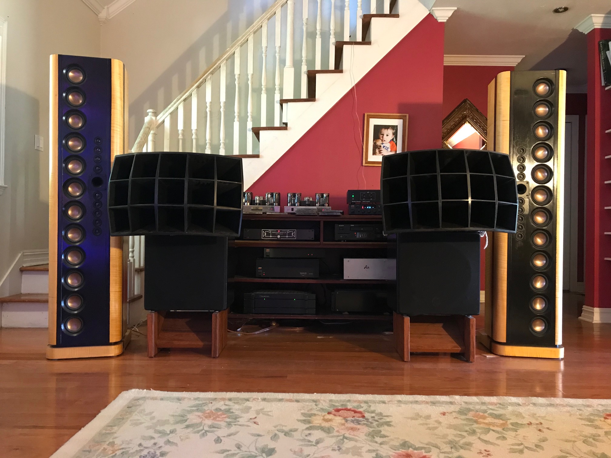

The Masonite exterior worked out well for me, along with filling the internals with the sand -granular rubber mix. Although the entire assemble now has weights 60 + pounds, I need to get an accurate weight measurement It took a little effort to fit the pieces to the horn assembly, I used thin cardboard as a templet for fitting each piece. If you can see in the pictures, I made a dado – groove at the half round molding around the horn side and a similar groove at the driver adapter side to slide the Masonite into the groves. The Masonite was cut long so when install they would “snap” into place and remain under slight compression. Hope that makes sense.

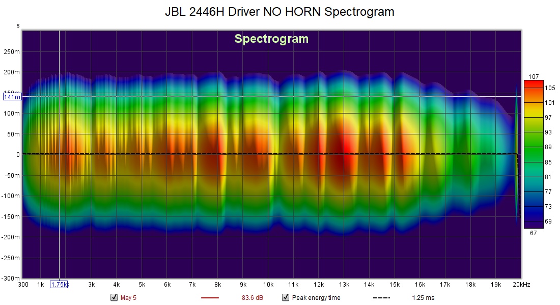

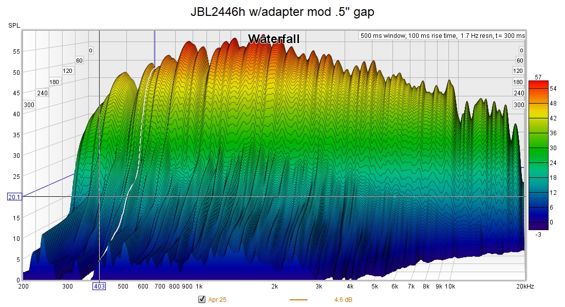

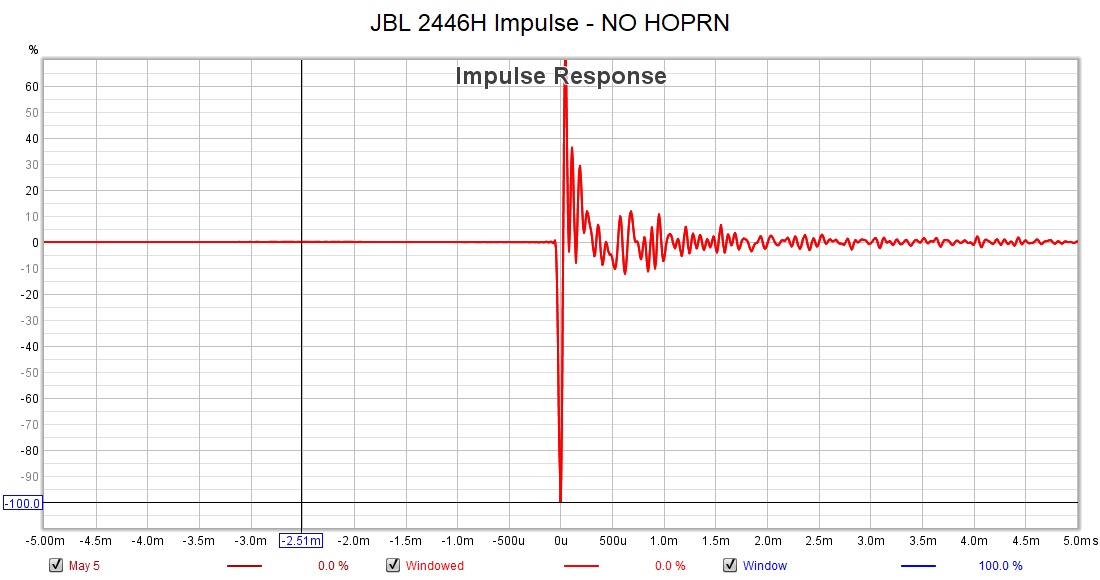

My concern is born out of inexperience interpterion of REW graphs:
How fast will a good titanium compression drive settle down after initial impulse?
What are the vertical irregularities in the X direction on the spectrograph?
In the waterfall what are the irregularities below 30dB and between 500 – 7k Hz?
Is that ringing?
I put some effort into bringing down the + 5dB frequency rise centered at 1300Hz with not
much success, every iteration of notch filter I tried, did very little to reduce the rise.
I want to make sure I am not chasing a base line issue I cannot correct without replacing the diaphragms.

Nothing other than FR jumps out at me on your plots. But it is odd that you can't tame the 1300 Hz hump. Could it be an artifact of measurement? Do you have DSP or other active EQ between REW and the amp with which to make drastic cuts that would be easy to see?

If yes, I squared off the multi cell assembly, using the Durhan's wood putty, shimmed up with MDF to create a flat surface on all sides. Made a flange adapter out of cardboard as a model, then reproduced with 1/2" ply that fit over the horn throat with lots of wood glue to fill void.Yes it did take some time - but the final product is worth it to me
