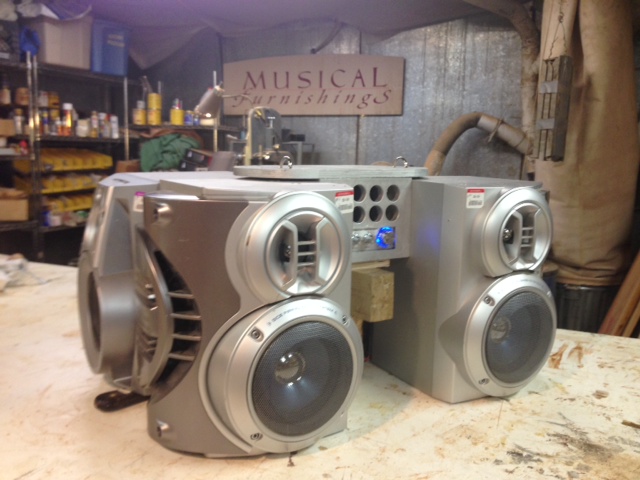

Hello, God Dag,
I am a long time lurker, infrequent poster... over here in the US. (my mother happens to be Danish, which adds some warmth to this thread for me)
I thought I would show you a project I've been working on, and get some pointers.
Its a design that utilizes a bit of the boominators science, but lets non-tech people be somewhat part of the design and construction. And it is cheap, simple and very loud and clear.
My plan it to make the design available online for people to build, and have the cnc files available as it is all designed to be cut on a router table. I may also have a run cut on a cnc, and sell them online at cost. It all fits in a flat rate postage box.
Then I will have a buying list for people to purchase the exact right parts.

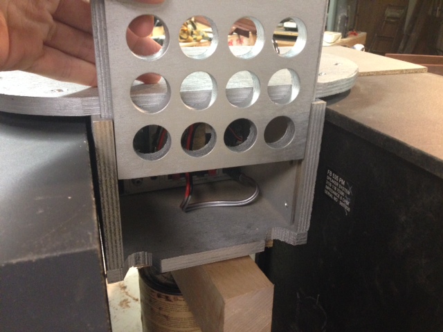

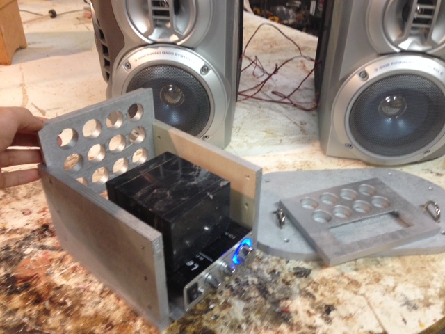

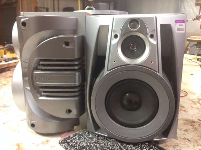

You will understand it just by the photos. Four thrift shop speakers, 8 or 6 ohm. These particular ones are all 6 ohm run in parallel. The infamous Lepai amp. Small SLA battery.
1) The loudest it plays is with the tone controls off, but it actually sounds wonderful at lower volumes with the controls on, high bass.
2) With a fresh battery, the amp kicks off with the 3 ohm load at about 80% volume. Concerned about how this harms the amp. It is much less likely to do so when the battery voltage lowers a bit.
3) I brainstormed reducing the volume of the enclosure to crudely tune them up a bit. Unsure if that would be worth the effort.
4) Did I mention that this is designed to be bicycle panniers? This one is huge and weights 40 lbs, which works fine on heavy duty bike racks. People will need to make lighter ones for lighter duty racks. (it isn't assembled in the photo)
Do you think it would be worth the added complexity to ask people to add a highpass crossover? The very low end of these ported boxes is surprisingly fun to have present when indoors.
