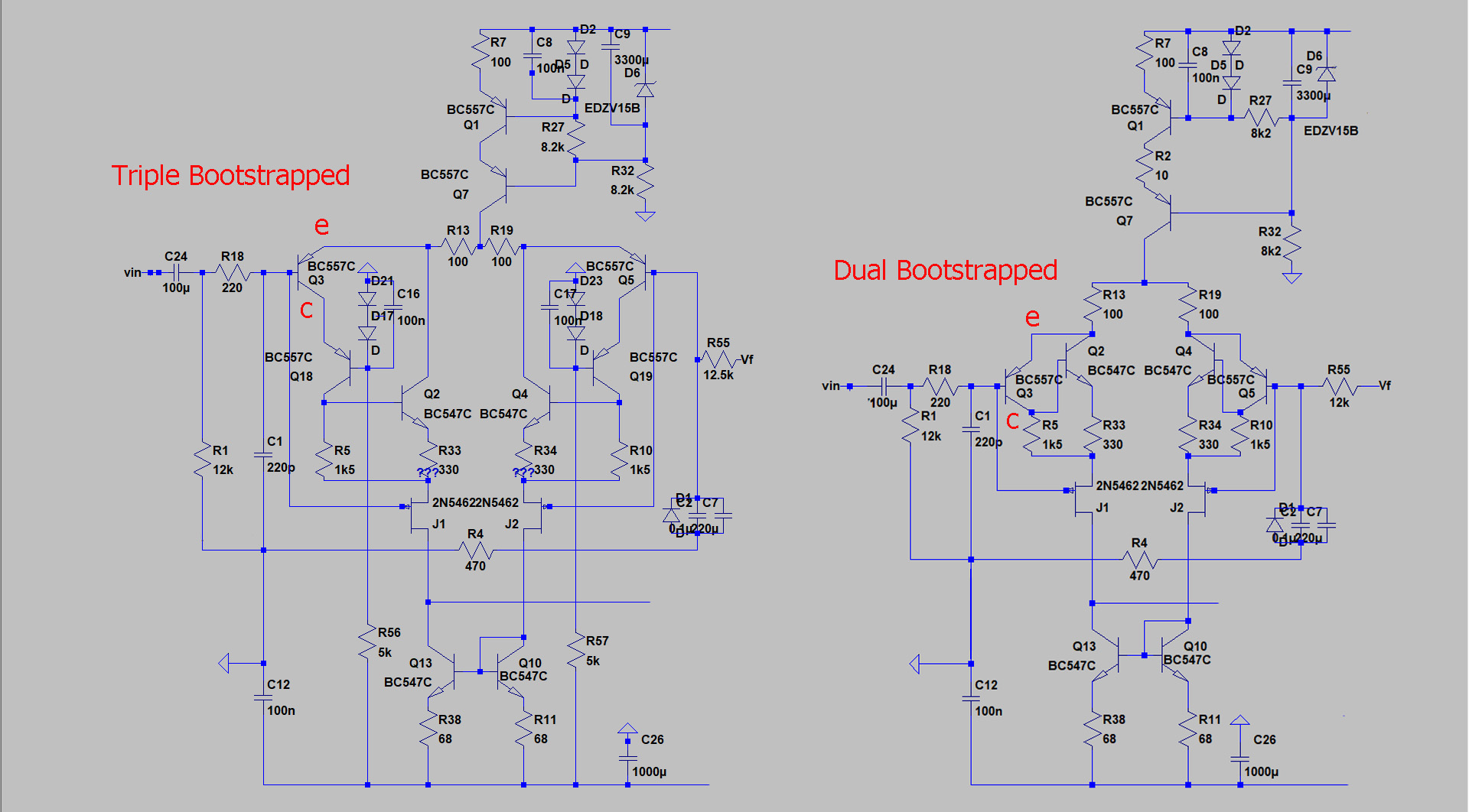

I have used these two versions, the Dual and the Triple Bootstrapped versions. See image below. From a thermal point of view, the Dual version performed much better.

The most noticeable effect of bootstrapping is that Cbc will be carrying a very much smaller AC component, thereby decreasing the input capacity.
Especially output drivers can have large (non linear) Cbc capacities that will be significantly reduced by bootstrapping, increasing the Bandwidth and reducing the distortion.

I see we have a nomenclature problem :D
When I speak about "double, tripple, quad" I mean it on an horizontal sense, for example, the "quad" has a bootstrap in every section of the amp and the "triple" has bootstraps in 3.
What you name as double is the original cascoded-CFP input but to conform to Kolinummi's nomenclature, it is a bootstrapped-CFP as the cascading element receives a sample of the signal. The one you name "triple" is bootstrapped cascoded-CFP (cascode-inside-the-CFP) and I was about to tell that it is funny that the one that behaves the worst on thermal terms is the most clean and open sounding...but yesterday I noticed that I blew again the driver's cascode for the positive side, so i have to investigate what is happening.

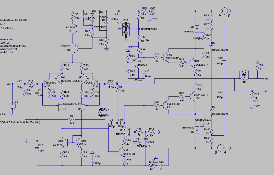

Hi Max,
I nearly finished a Combi Layout for experimentation based on your latest QUAD bootstrapp schematics covering the following configurations:
QUAD
TRIPLE bootstrap.
Darlington bootstrap
Cascoded SZIKLAI
all with CCS VAS and new input circuit.
The schematic pdf-file contains the 4 configurations high lighted in color.
The different configurations are realized by mounting options. Only the
Cascoded SZIKLAI requires cutting wires and reconnecting via solder bridges
(swapping collector/emitter the output transistors).
I know that the attached 2 layer layout is not easy check but I do my best that everything is correct.
I will explain the mounting options later in a separate document.
So concentrate on checking the attached schematics.

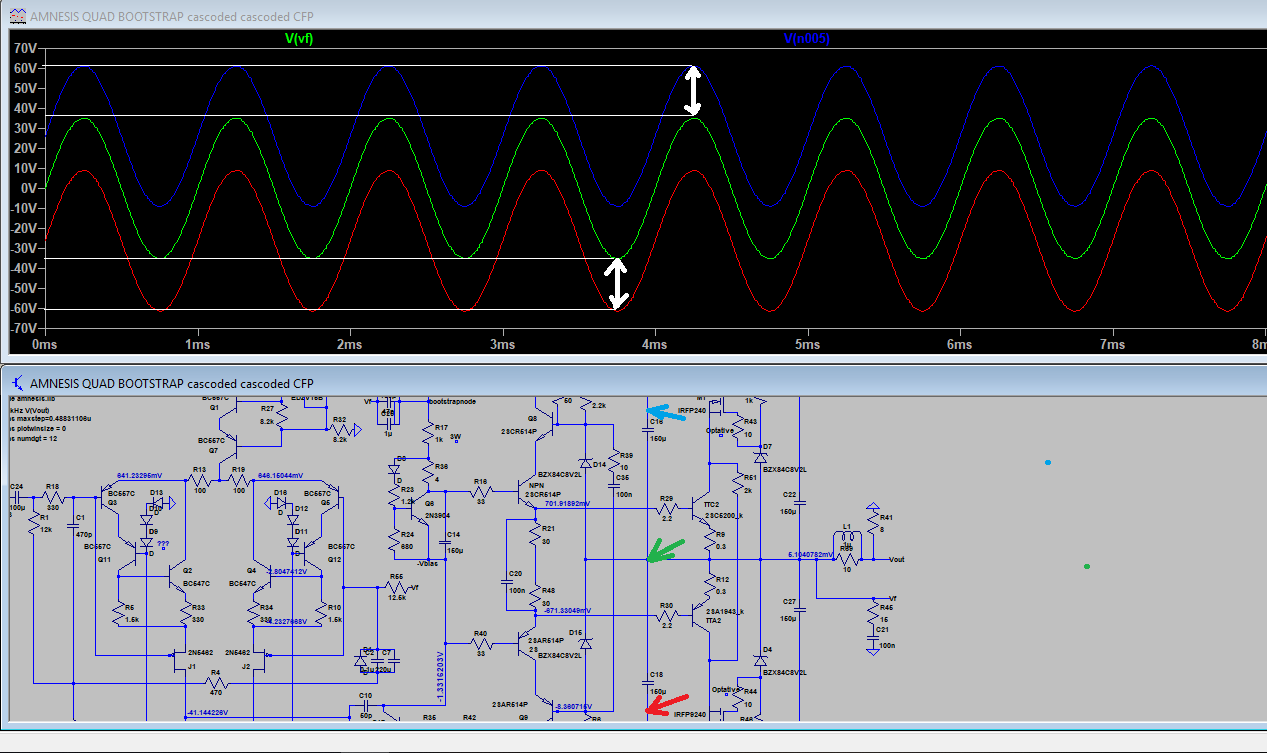

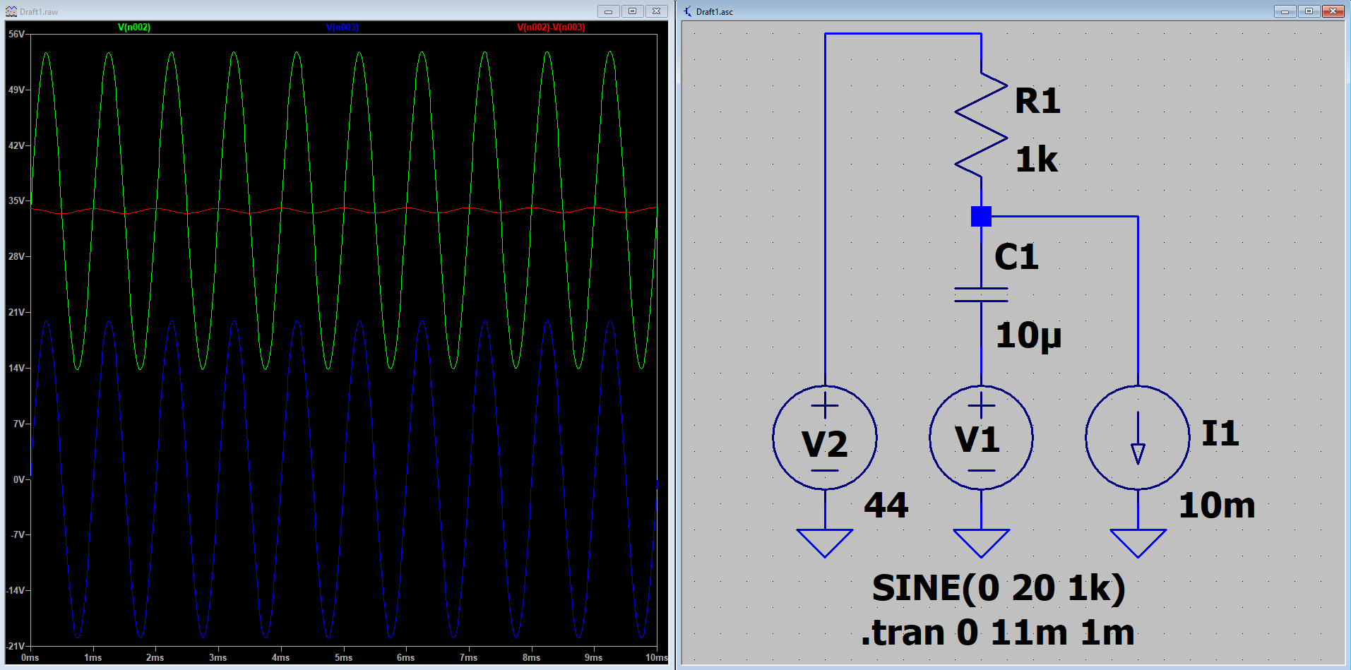

I agree BUT the AC component goes from -10V to +60V (positive side and vice versa) near clipping (+/-1.3V signal) compared to ground.
What would be the AC voltage difference between (+) and (-) leads--> if I trust LTspice it must be around 25VAC, so we are good.
I am checking the PCB (QUAD version) little by little and I found no big mistakes so far. I even found D2 :D
Some comments:
Feedback resistors are good from 48K to 50k paralleled. Or 12k-12.5K single. Simulations do not show it but I commented before the work of an audio guru (which name now escapes me) that measures significant THD reduction with parallel or series-parallel (low tempco) equivalent resistors.
IF you find the amp worthy, then it is recommended that all resistors on the signal path be swapped to high Q, low tempco units.
You know BJTs on the input CFP could be swapped for equivalent (cbe pinout) with lower Ccb/lower V capability (BC550-560 for instance), as they face very low voltages...

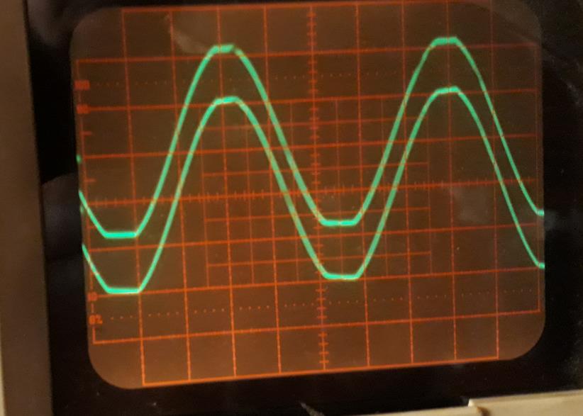

I made new measurements with my single Amnesis prototype (Darlington output stage):
Ups= +-44V
Sine wave 1KHz
Scope 20V/scale
The lower curve is the output signal (minus pole of cap) at clipping point (+-40V)
The upper curve is the voltage at plus pole of the cap connected to the middle of the two 1k resistors (+44V).
As you see the maximum voltage across the cap is below +30V.

Dear FdW wrote:
Yep, I was kind of in a hurry
What I wanted to show is, how you could determine a value for the bootstrap capacitor by observing the 'red'-line
A small sim goes a long way (I hope).
Yes, thanks for your interest and support.
I believe we can be confident on the minimal value we found: 35V standard or more. This can be bypassed also with good film cap.
I repaired my channel with the last configuration. It seems stable with 6R8 dummy load. No time to listening though...family obligations...
BTW, JOSI1, did you listened to your single channel? And, is it stable? Just curious...anyhow, at least 48hrs of burning-in are recommended before critical listening.

Guys, I revisited my crazy alternate compensation scheme on the Darlington output amp. It behaves well on square wave test and in stability terms, IMHO.
Is there an explicit way to show stability margins in LTspice?
You know I am a nullity with LTspice: I've tried without luck to introduce the BD139/140.
I hope today I will have time to complete my test with the last configuration proposed as optative oscillation killer: 50R-10nF from base to ground of the driver's cascode.
M.
