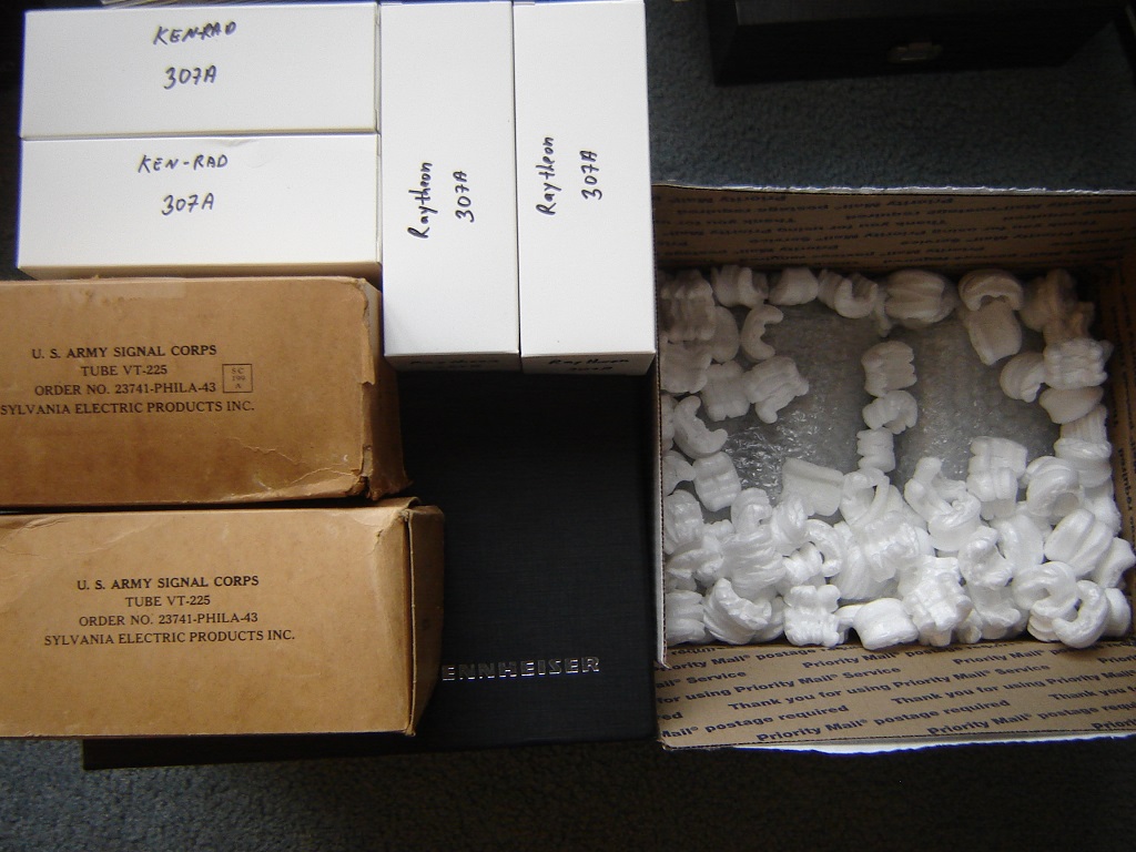

Look closer, they aren't very similar to the 307a. The 307a gives better results in the output stage, AFAIC. But then, the 307a beats the 300b, so...
iko can you elaborate on why 307a beats the 300b? 300b properly driven is very linear, IMO it rightfully deserves a bad rep when driven from something like 6sn7.
307a tubes are still out there for not much money, you just have to ask dealers. Five pairs pictured, another 6th not shown :Present: I think I will be using these on the output of the headamp. Only downside most of these are black glass hiding the beautiful grids
I can only speak from simulating output stages with a "perfect" input signal. The 307A had lower distortions when compared with various 300B models that I found around the net. However, search the forum and you'll also find anecdotal reports that it's better in reality. Perhaps not conclusive, but it's an easy choice for me, as I don't want to fork the $$ for good 300B samples, and I already have a good number of 307A. It's good to know that they can be found for reasonable prices still. Two years ago or so I couldn't find them anywhere below $50 a piece.

There must have been a score of military issue 307A's recently. I guess I am going with this tube on the output ver the 300B mainly because they were all made by Western Electric under contract, and I haven't heard a bad tube from that old company yet. I understand the 306A may have better linearity but less B+ capability? This would put the 306A at the same disadvatage as the 4P1L, 2A3, etc.

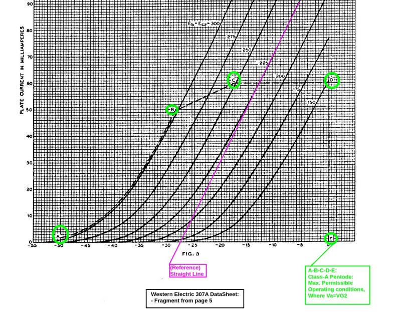

Although the pentode-mode specs allow 500V, I don't think this will translate into 500V for triode.
The WE data sheet gives maximum operating conditions as an envelope in the attached diagram, for class-A pentode.
See that the 60mA rating is already derated to 50mA at 300V.
For triode, the voltage can probably increase a bit, maybe 340-380V, but at 300B levels, I would expect real trouble.
Not only that, but the linearity will get much worse at high voltage. We need some real measured curves to see where the degradation sets in (this happens for almost any power tube, but the onset voltage varies a lot).
Personally, I would find some way of obtaining real measurements before spending money on transformers.
The fact that the data-sheet says explicitly that the class-A performance of the 307A was compromised in order to get good class-C operation is a warning. It gives us exactly zero confidence that the WE 307A can compete with the same company's 300B design, where class-A linearity was the actual design goal. But still, measured curves will answer this question, too.
Yes and a WE engineer making a slight compromise in linearity in the 40's is better than anything we can expect with todays materials. Making god tools is largely materials engineering/science and they just don't make 'em like they used to ?
It's possible, but this could go either way!
My point was that we need some kind of reliable characterisation of the 307A - in triode mode - before dropping cash on the iron. Nothing about the data sheet suggests more than middling performance, and 50-70 years lying around soaking up gas does not improve anything - gassy grid current is noisy, for starters.
(I speak for myself, but) I don't see the worth in designing with an unknown quantity. Real curve tracing, like the Audiomatica samples linked earlier, will allow:
- meaningful (rather than anecdotal) comparison with 300B;
- checking grid current in ancient samples;
- checking the operating point (especially voltage) that gives reasonable linearity - before the high-voltage degradation sets in.
