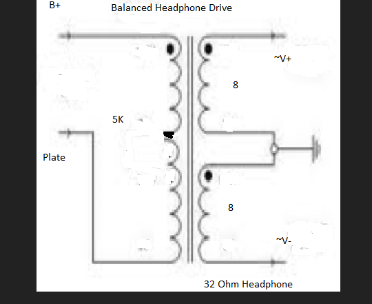

The other thing we are struggling with is "balanced" drive (see attached). It may be easier to spec a 5k transformer to have two 8 ohm secondaries which I've been told would impedance match with a 32 ohm headphone. I haven't been able to get this to simulate with LTSpice, do you have any thoughts on this or know the math behind it?

It depends on who makes your transfo, my builder just quadrupled the secondary left the primary/core the same as for a 45 and I got a "nice" 10 ohm DCR secondary, the tota efficiency of the transfo gave about 50% less power than an "ideal" model, this is what I am "warning" folks about. Most transfo winders have a formula that is based on a 25:1 primary/core size and a headphone secondary is just considered a low quality "add-on." Rather than an opportunity to take advantage of the 11:1 ratio.
So hence my interest in the dual 8 ohm secondary "balanced out headphone drive" idea/rumor. Trafo builders have years of experience with 5k:8 transformers.
Regal,
As a thumbnail, secondaries can be doubled by multiplying them or dividing them by 4. So, 4 X 8 = 32, whereas 2X 16 does not equal 32. So a dual 8 ohm secondary will provide 32 ohms of load impedance reflection into the primary and into the plate. If you want to understand the formula, here it is in text, since I know from nothing about math notation from a keyboard in Windows.
5000 ohms primary load impedance. To find the turns ratio divide 5000 by the averaged impedance wanted and derive the square root of that. This is your turns ratio. For secondary turns in a SE OPT it is divided into the primary winding turns. For push pull it is both halves of the primary.
As for your concerns with your current transformer. Loses are not defined by the secondary alone. To get within a few % of the total power loss you must take the square root of the turns ratio and multiply the primary DCR by that, and, add it to the secondary DCR to approximate the infinitely reflected losses between the two. There is a core loss but it is insignificant enough to be ignored in a properly designed transformer.
In a general sense any SE OPT with more than 100 ohms primary DCR is going to have a high insertion loss. A 50% loss is pretty ridiculous, but 45 tubes require a fairly high inductance and with their desired current flow and the resultant gaps, you are stuck with either high DCR, a large (14 pounds 3.75" X 4.55" core perimeter) M core transformer, an amorphous core or a nickle C Core transformer, to generate the required inductance. Much better to accept a bit of flavoring and use a lower mu tube, like the 300B or 2A3.

Regal, the transformer you need already exists. It is the Lundahl LL1627.
Primaries will always be all in series regardless of the load. Secondaries will be in configuration C for a turn ratio of 11.3 (i.e. 4.1-4.6K for 32-36 ohm), configuration D for a turn ratio of 8.5 (i.e. 4.6K for 64 ohm) and configuration F for a turn ratio of 4.25 (i.e. 5.4K for 300 ohm). You always use all secondaries and power loss is very low in all cases around 0.1 dB! The only thing you need to specify is the gap for a lower operative DC current. If you ask for 40-50 mA rather than the standard 90 mA, you will get the right inductance for 4-5K (i.e. about 25-30 H).
You could think about some way to swap terminations around (for example using jumpers or similar stuff) until you don;t find the right set-up and headphone so that you don't have to solder every time you change headphone. You could also ask for the best core they have (thin lamination) or the amorphous.

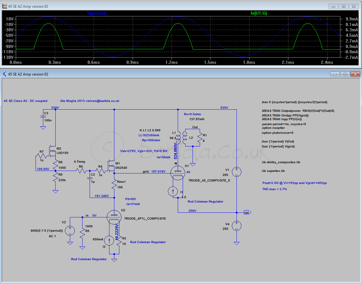

Also as I lost Iko with my spice THD #'s and I wanted to mention that Spice is predicting much higher THD that Ale has been measuring even as OTL preamp. I look at LT spice as a great tool for setting operating points determining zero grid thresholds, power levels, etc but think the THD isn't accurate because its based on an infinite low noise floor, the THD predicted from spice is good for relative comparison and little else.

The spice model is not accurate in A2, so THD is not that representative.
You probably want to consider carefully to go down the DC coupled route with stacked supplies. I'm currently building a 4-65a SE in A2 which is proving to be very demanding due to the supplies. Not sure whether is worth the effort (and size and cost) for a headphone amp.
That should be interesting. In my opinion the different thd results we get are due to the poor transformer models we have. I don't read too much into that.
