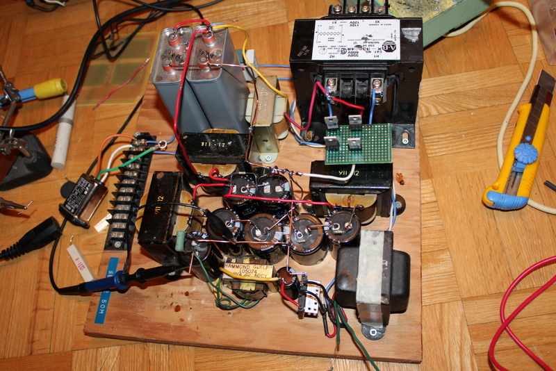

I think I know what you mean. I finally got over a psychological block and put together a prototype psu capable of about 750V DC at 2 x 100mA for my D3A-4E27 SE test project. All from spare parts that I had around, but seems good enough to test the amp with. From the sound of it I don't think I need to go A2. Anyway, it's off topic, so I'll stop.
Interested in seeing the Spice/schematic for this if you have one

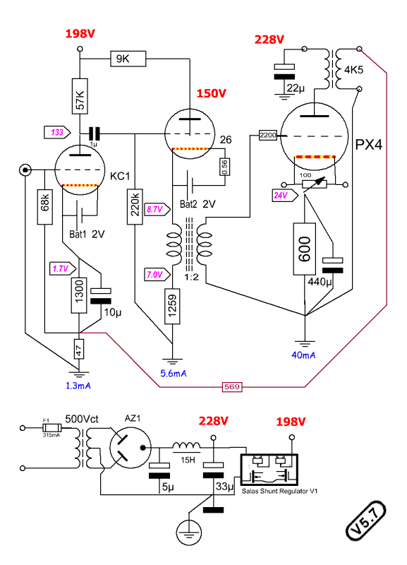

I'll leave you all for now with a "dream" schematic from back when good NOS DHT;s were "available". The 24 mu input DHT shown in this schematic is unobtanium as are the PX4's.
But I think a 4P1l cathode follower could drive a 1:4 stepup transformer-37A triode. Something to think about.

I think that a DHT cathode follower is not a good idea in general. Filament current is too high for a typical interstage even if you use a 4P1L. If you want to provide some Kohms load it has to have inductance and the 1:4 ratio makes things a lot more complicated. You could try with one of those small DHP like 1S4, 1W4 which require 50 mA only or a parafeed drive.
A 3 stage amp without step-up interstage more likely will do better, IMHO.

Wouldn't you just create a center tap and pull the cathode current separate from the filament current?
I have never tried this. However if you use an indirectly heated triode (or pentode) it will not be different as the cathode follower has 100% local feedback and is a lot more linear than any DHT in common cathode configuration. A 6V6, for example, would be a very good choice.
Anyway I think that a 3-stage (for example 3A5 or 26 + 4P1L + 307A) amp without such interstage will be a lot easier to make.

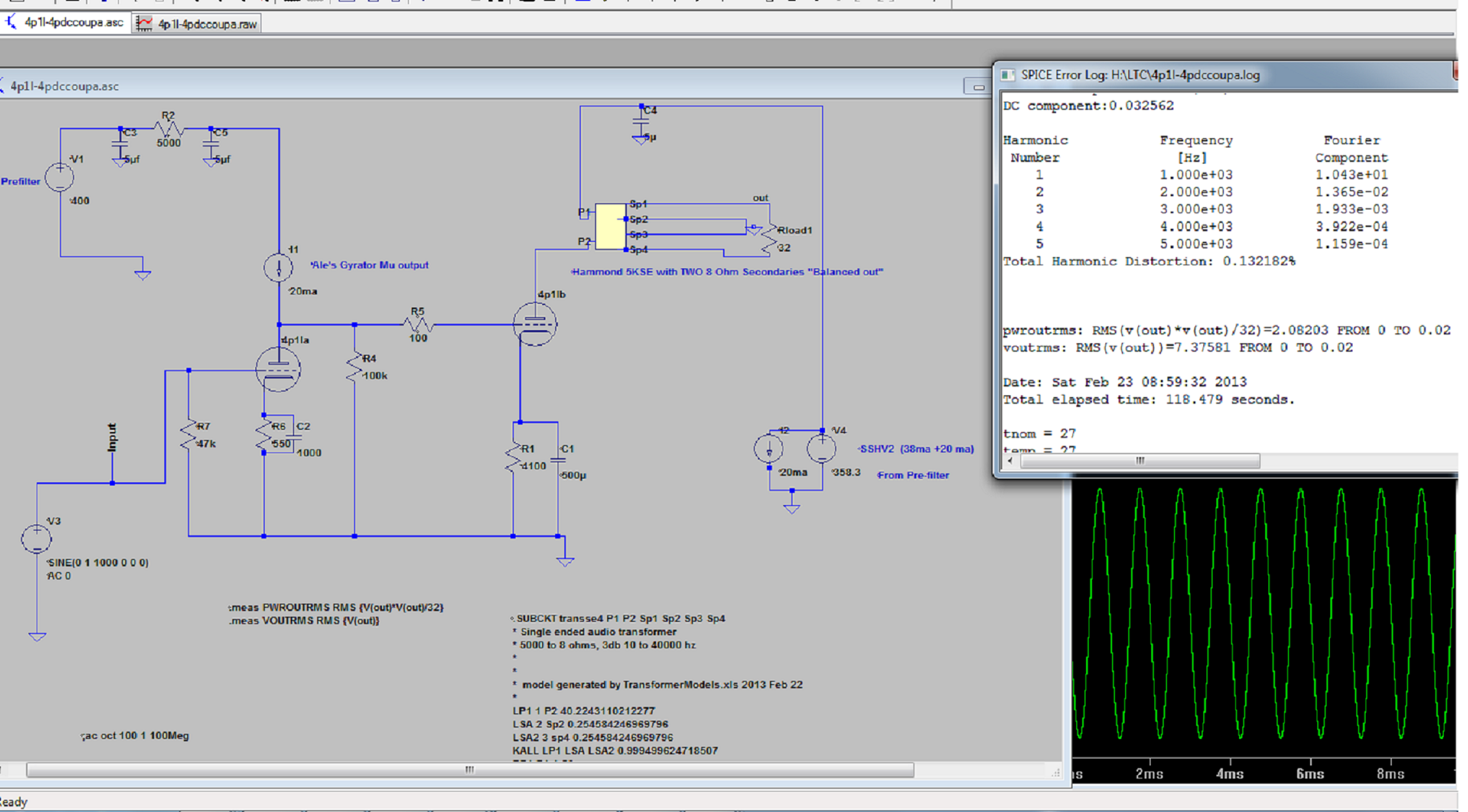

I've attached my spice simulation of a 4p1l to 4p1l dc coupled SSHV powered amp that looks to be a real step u from my high gm spud SET headamp. This shows surprisingly good sensitivity and exponentially better THD compared to my previous attempts.
As Pano said its time to start soldering. I have the coleman regs, #26 tubes, 4p1l's, and 307A's, and I know what to ask for from a transformer winder. This is somethig that could be done from most all transformer manufacturers, Bud, E-Print, Bartaluuci, Sowter, Edcore, Lundall depending on what you want and where you live it can be left to the discretion of the Builder. Just ask for low primary DCR, and dual 8 to 10 ohm secondaries. For high ohm headphones I think a parallel resistor is the way to go, from both a hum perspective and a cost perspective.

Maybe you used the 500uF capacitor on the output stage cathode bypass just for simulation. But if you don't go with stacked supplies and intend to use such a bypass, ouch! It's much easier to find a good quality small value coupling cap and go with ac coupling than to find a good quality large value capacitor.
Also, for the cathod bypass cap in the first stage you probably made a typo, because it is 1000F, not 1000uF.
The text is hard to read but the first stage says it will be filament bias.
For the second stage I guess I just disagree, would rather have a quality electrolytic cathode bypass or large film cap and DC couple than ac couple to an output stage, coupling caps do bad things as the grid of an output tube nears zero. Also with the 4p1l we need as much transductance and gain as possible and we sacrifice both with filament bias in the output stage.

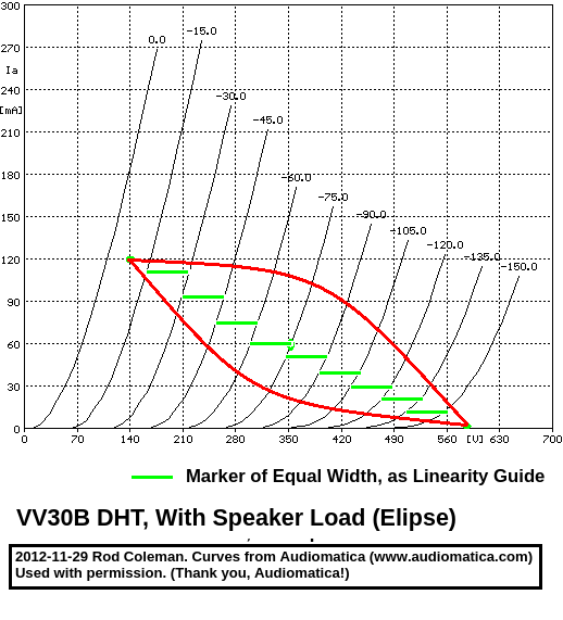

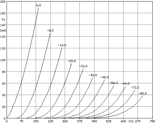

EL34 triode is not too bad - but only if you use only a small fraction of its output power.
This is one of the situations where SPICE models can really lead us into deep woods.
To illustrate the point, please see the characterisation of real tubes, made by Audiomatica (Audiomatica Srl). Their images are used with their kind permission.
I have compared the EL-34 and the 300B. The really obvious difference is the slumping & compression of the EL34 curves below 20mA. Note also that the mu is shifting at high voltages.
The comparison with 300B curves shows why the DHT is so much better.
My suspicion is that SPICE models do not adequately take account of these rather complex properties, leading us to think the EL34 is better than reality.
The only proper design method is old fashioned load lines, and real measurements of the tubes we plan to use.
Driver distortion for 300B can be tiny. See for instance the 6E5P driver in Shunt Cascode that Ale & I have already worked out: 0.23% distortion for 160V pkp-pk out.

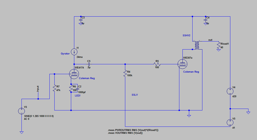

So until then I will stick with the 307a/VT-225. I got such a good deal on these NOS tubes it would be a shame to not use them soon. I will start with a 417A ac coupled with a SSLV negative bias to the 307A triode (SSHV2 B+). I considered "stacked" supplies but this means I think a custom power transformer. I think this should be a good compromise.
I am calling it this the All WE High Power Headphone Amp since both tubes were made by Western Electric. Note I am using a coleman reg on the 417A indirect heated 417A because I have found not only much less measureable 60/120hz but also better sound using coleman regs on my 417 spud amp. This will also allow me to replace the driver wiith a DHT + Shunt cascode should a PCB become available. Also note this is a two chassis deal with absolutely no iron in the amplifier chassis beside the output transformers, and yeas they still need to be 90* from the power transformers. Headphone output transformers will pick up 50/60hz from power transformers over 3 ft away. The last thing is use a wiper on the gyrator in order to find the best spot, some 2H cancellation can be beneficial.

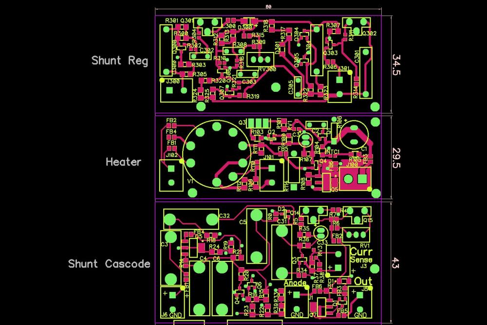

Since I like this Shunt Cascode solution so much, I decided to design the boards anyway, and a few days ago I sent out a Panel of PCBs for sample manufacturing. The picture is a sample of the Gerbers, also showing dimensions.
The boards are all 80mm wide (compared to the filament regs - 79mm wide).
The 3 designs:
- Shunt Regulator: 80mm x 34.5mm: A high-voltage Shunt Reg with discrete-transistor Error-amp for highest control of noise. Includes high-power CCS. Including completely adjustable reference voltage, temperature compensated.
- "Heater" a version of the Coleman filament Regulators, optimised for IDHTs, and configurable for Filament Bias. The IDHT B9 tube socket is on-board, and positions for cathode and grid resistors, and ferrite chip beads for the anode/g2 pins. It's configured for 6Ж9П-Е (6J9P-E) + E180F/E280F/E810F/EF80/EF184/6F23 - all of these are known-good for Shunt Cascode.
The on-board Filament Bias circuit allows low values of cathode resistor, with no bypass cap.
- Shunt Cascode PCB. holds the Darlington Shunt Cascode circuit, ferrite chip beads, high power CCS, and the servo circuit to allow dc-coupling of driver stage to DHT end-stage, with automatic biassing of the DHT.
The designs have liberal use of chip ferrite beads, to kill HF noise, parasitic oscillation etc. Together with the temperature compensation networks on all the CCSs, the circuit is somewhat complex, so I have laid it out in SMDs, which are standard build with me now. SMD layout keep the sizes of everything small, which is best for stability, and reduces EM noise pickup.
Like the Filament Regulators, the power transistors are on a board-edge, so that chassis can be used for heatsinking.
I hope to test them all out, and report some performance data soon.

That sounds great super idea to coleman reg/filament bias the input tube
But will the board be configurable to different output tubes?
Many would be fine with a 4p1L. I prefer the 307A over the 300B because it allows a high voltage swing at a lower current bias which helps in keeping the nudget and quality a bit in not needing the higher current handling transformer core that for the 300 B, it and I think the PX4 and even the 50 are a bit more suited to headphones for this reason. Not saying the 300B can't be a good solution its just a lot more expensive. And some will want the 2A3 due to its availability (the big JJ 2A3 has good higher voltage ranges that help with headphones also.)
Also not opposed to trying the 6J9P driver either, and having all the regs on one board would be awesome. Wish I could change the title of the thread to (The DHT Output Headphone Amp) :eek:
You do have a big challenge with the Shunt B+ reg, The SSHV2 is amazing in providing low output impedance transperant sound with a headphone amp.
But having all the SS on one board would be great, The best part is no coupling caps, no cathode bias caps. I really don't see the shunt cascode as being as "adding" a SS gain stage any more than using a gyrator or Cascode CCS's mu output.
