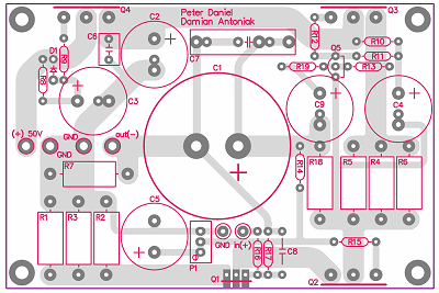

Are you guys ready for Zv9 layout?

unless i'm having vision trouble, the layout in that thread and the latest in this thread from veteran are not the same.
bb
Ok I need some help. I have my boards setup the way Peter shows on page 25. I have read his comments on grounding on page 14. I have none of the jumpers installed. First my ps is +/- 31vdc under load. I am not sure if this is my problem or not. When I start it up I get +31vdc on R14, -31vdc on R39 and +30vdc on R27. I have no idea how I managed that. Any ideas would be a big help.
