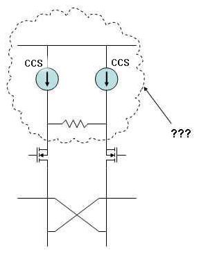

I think Grey means that the resistor reduces the
performance, assuming that the diff pair is current
sourced by a resistor. In this case it's not such a
great phase splitter, although it does work.
It hinges on the current sourcing; if the current source
is constant, then the resistor simply reduces the gain,
and the amplitudes of both halves are equal.

Actually, I indicated two CCS's (constant current sources).
Probably, my expression was dubious...
Thanks again.

I modified my BOSOZ, using constant current source tails recommended by Nelson Pass. It is here in a detailed circuit.
http://www.diyaudio.com/forums/showthread.php?s=&threadid=3949&perpage=15&pagenumber=30
It does great work as a pre plus unbalanced-balanced converter for my system.
If you adopt one CCS tail, you might need two gain control resistors of the same values between the sources: one to the left side and another to the right side of the centered CCS.
Anyhow, thanks for your kindness.
JH

IMHO, a CCS BOSOZ is more an Aleph P 1.7 than a BOSOZ (yours is 1/2 of both, since it only has 1 ccs per side )jh6you said:Bricolo
JH
What do you mean in the bold text?
Using 2 CCS on an aleph-x prevents fron using gain control resistors? Or you can use differents resistors values? Why?
You like to tease me.Bricolo said:What do you mean in the bold text?
When I gave Grey my first question, I was thinking about the concept shown in the figure. Pls refer to the figure. What is your question exactly?
JH
I've got no more questions, the figure explains all of them
the resisitor will be used to set the DC offset, am I right?
