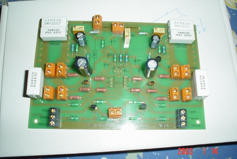

Can I assume each fet for the front end is biased for 10 ma each so they are sharing 20ma from the CCS? Or are we talkin 20ma per fet, I mean Hello?
ie I have never meaured the ccs value in situ
Ian
PS A peck at first board off the macka Line, by the way all the credit goes to John Inlow,
Three Cheers for John Guys.

JH,
A valid strategy. If you use two current sources, you will gain a little more control over the two sides of the differential, but at the expense of having to use balanced inputs, since the two sides of the differential won't communicate as freely with the resistor in place.
If you've got a balanced source, go for it.
Ian,
You want confusion? Try listening to a tube guy and a solid state guy talk about bias. The tube fellow will speak in terms of volts at the grid, whereas the solid state critter will talk about current through the device. They're both right, but the cultural differences do tend to require translation sometimes. You'll probably catch me doing both from time to time (perhaps even in the same post), since I tend to think tubes, then translate to solid state. Hopefully, people can make allowances.
At any rate, the current source supplies 20mA total. Half of that goes through each side of the differential, i.e. 10mA for each IRF9610.

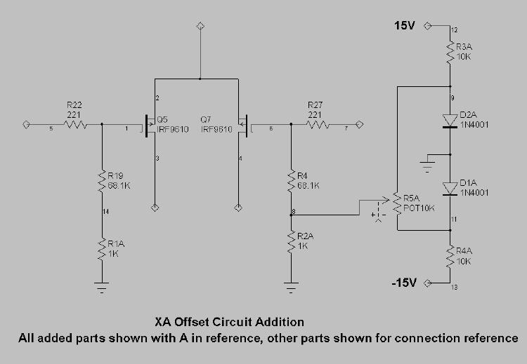

Somebody dropped me a note asking for a clarification of
"differential DC" and "absolute DC" at the outputs of an
X type circuit:
Differential DC offset is the quiescent DC value between the
two balanced outputs. This is what the speaker sees. If
both outputs are at +1.00 volts DC, their differential DC
offset is at 0.00 V.
Absolute DC offset in the above example is +1.00 volts.
Differential values are ideally 0, but practically speaking, less
than 100 mV is a pretty acceptable number most of the time.
Absolute DC is also desired to be at 0, but practically speaking
it can wander around a wide range without significantly
affecting performance. As this gets large, it starts cutting into
the maximum voltage swing of the amp.

Re: Grey, please explain your offset circuit.
By Vv2 I suppose you the pot that adjust the current source for the front end. That pot adjust the absolute DC offset. the circuit shown adjust the differential or relative offset across the speaker. It is only necessary to have the circuit on one side of the diff pair and it can compensate for a positive or negative offset voltage. I think the inputs to the 10K resitors or the actual input signal for the amp should be Ac coupled for this to work best. Looks like a good way to trim the relative offset without changing other parameters in the amp. Kudos Mr. Rollins.
Max
carpenter said:It's a lovely drawing, but I'm unable to fully grasp what you're offering to the group. Also, is this circuit located only on one side of the diff. pair? Does it work in concert with V2?
Thanks a bunch,
John
Max

Offset Circuit
Yes
Yes but let me know how long it takes to get a pair within even 10mV match.

carpenter said:Does this circuit correct imperfections in the FET (9610) match? If the 9610s were matched perfectly, wouldn't they have 0 volts offset in their combined properties?
John
Yes

Here it is. Nothing better than a man himself describing the circuit:
"By Vv2 I suppose you the pot that adjust the current source for the front end. That pot adjust the absolute DC offset. the circuit shown adjust the differential or relative offset across the speaker. It is only necessary to have the circuit on one side of the diff pair and it can compensate for a positive or negative offset voltage. I think the inputs to the 10K resitors or the actual input signal for the amp should be Ac coupled for this to work best. Looks like a good way to trim the relative offset without changing other parameters in the amp. Kudos Mr. Rollins."

JH,
It's not the impedance of the two current sources--that's fine. I think you'll find that the resistor between the two Sources, unless it's really small (in which case it doesn't really separate the two halves of the differential), will interfere with the signal crossing from the Source of the driven side to the Source of the undriven side. As a result, the front end won't function very well as a phase splitter.
The feedback will correct this to some degree, but I wouldn't want to bet the farm on getting a good, balanced drive to the two halves of the amplifier.
By all means, give it a shot if you've got time and parts. You don't have to build the whole amp--just throw together the front end and measure the output from the two sides.
