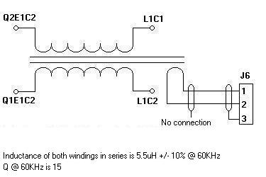

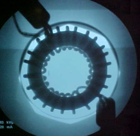

Power Supply Question????
I've located a few of these and am curious if they would be a good fit for the Aleph-X (and also original Aleph) power supplies...
Opinions???? I have requested the winding resistance but don't know it at this point in time...
The price is right!!!
Thanks...
"2.6uH @ 60KHz, 10A continuous, 100A max peak. This inductor/choke is designed for high current applications (but can be used for low current as well). It is constructed of a toroidal ferrite core with 14 gage wire wrapped around the toroid donut."

A bit more info...
Am planning to build a couple of AX's the are pretty close to the XA-200... The plan is configure them so that they are very comfortable running a 4 ohm load...
Are these big enough? What about paralleling the windings? Would this work?
Thoughts?
Thanks,
Thoughts?
Thanks,
