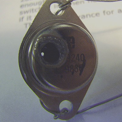

Well let's see if your temperature calibration nomenclature
matches mine:
Blimey hot is 10 seconds hands on = 45 deg C.
Crikey hot is 5 seconds = 50 deg C.
Bloody hot is 2 seconds = 55 deg C.
X*?@! is 60 deg C.
All of these are within an acceptable range, although
X*?@! is resrved for the more mature constructor.
Hmm,
Well if we have multiple choice then I recken it was option 3. (around 58 deg c according to the probe, and on the case of the IFR240 it was 79 deg c).
60 deg c is big burnies for any diy lad, not even the pussy cat will go near it (hot tin roof) Muhahahahahah
Worse than a hot iron or dripping solder on nylon socks!!
1. Blimey hot is 10 seconds hands on = 45 deg C.
2. Crikey hot is 5 seconds = 50 deg C.
3. Bloody hot is 2 seconds = 55 deg C. Correct
4. Flaming HotX*?@! is 60 deg C.
X*?@! is reserved for the more mature constructor.
Nobody said boo about my bias calcs?
Ian
:redhot:
This is to be avoided
