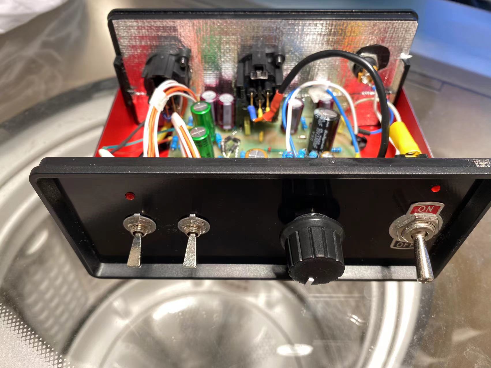

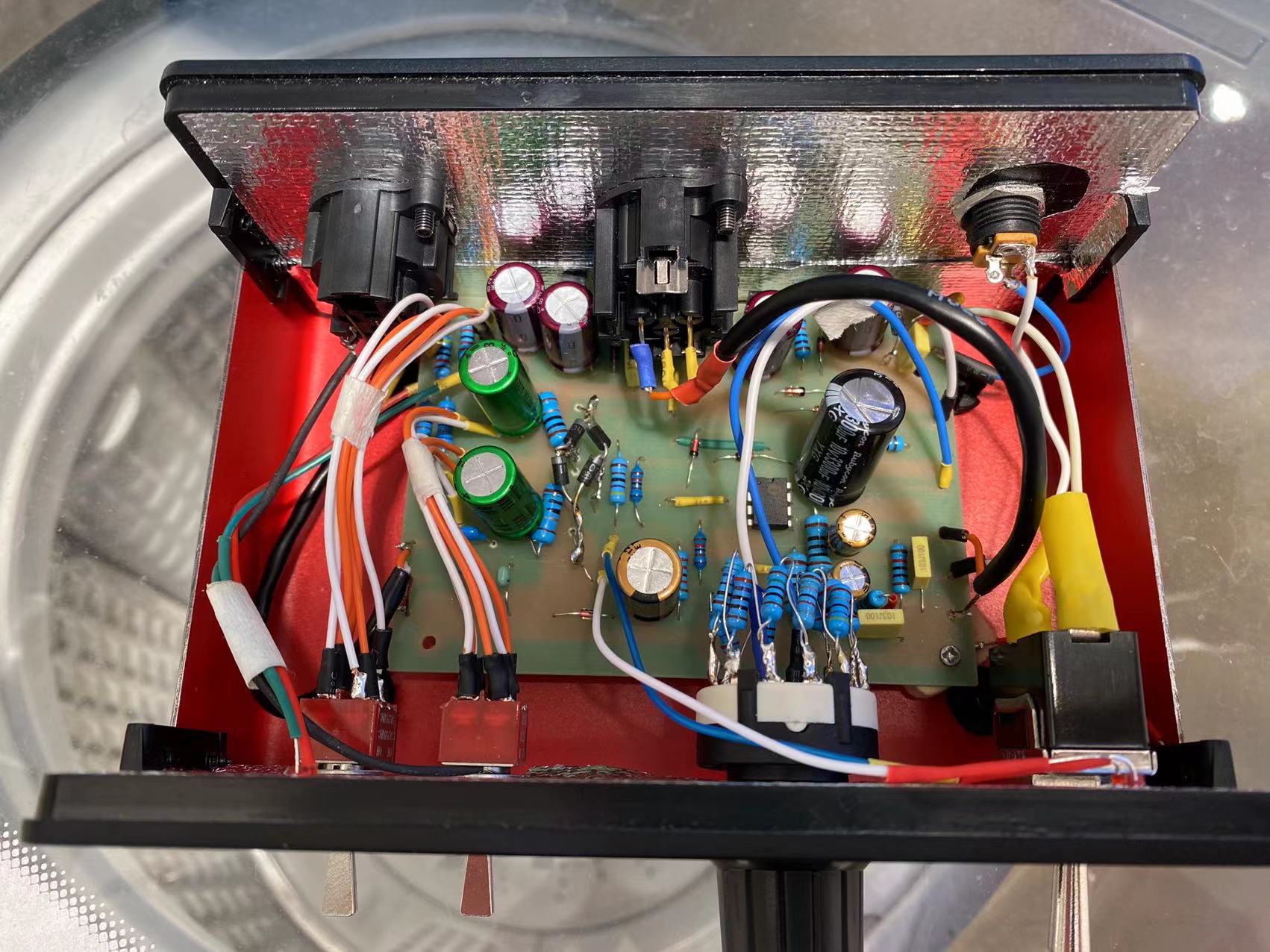

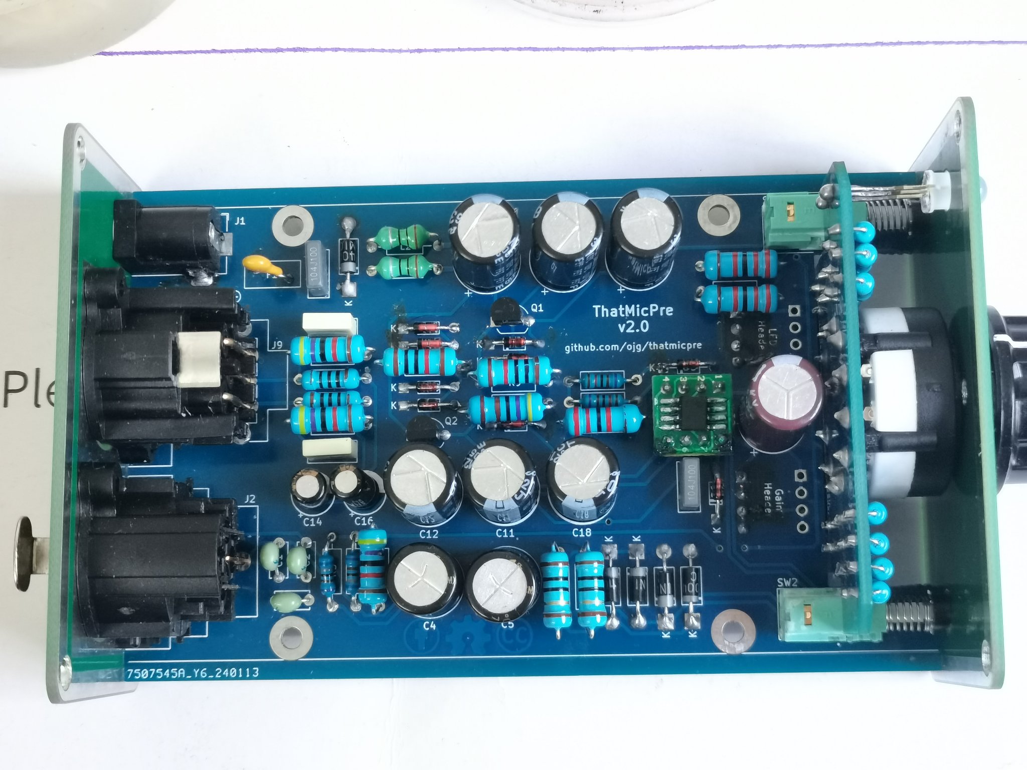

Here is my take on 2 of the preamps. The only thing I added is a little lens for the phantom-led to have the front more "closed". The knobs are a bit to long but I loved the colorscheme so I kept them.
Thanks for the cool project, loved working on it!

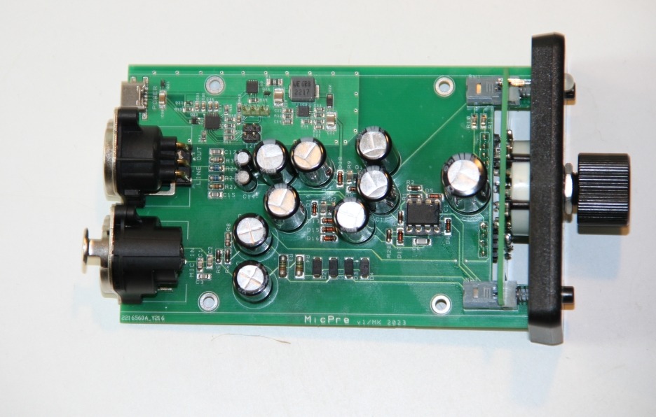

I made a slightly modified version of this mic preamp. I added a boost converter (LT8362) to generate 48V from lower input voltage. According to simulations (and datasheet) 8V seemed to be the lowest possible for 48V output. So to be able to use power banks I also added a USB PD sink controller (STUSB4500) so that USB PD power banks with >9V output could work as well. I had done similar stuff in my silentswitchers so I could more or less copy those designs.
When I started testing with USB PD power bank I noticed that the current draw at 12V input is so small that the power bank will switch off after few seconds. But to my amazement it works also with 5V input. So regular 5V power banks or even USB port can be used for power.
Here is a picture of the board.
Boost converter and USB PD controller are at top left corner. Power connector is USB-C. Apart from elkos and THAT1512 I've used SMD components. Resistors are MELF and capacitors C0G.

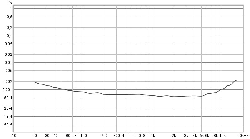

Performance seems to be very similar to the original. Here is THD vs Frequency at 40dB (input -40dBFS).

Nice one, bohrok2610!
Nice to see some derivative work. I have also pondered about different USB-C to 48V solutions. The 5V, 3A you get from USB-C without a PD controller is sufficient. I tested the LT8302, which is an isolated flyback converter, and that worked, but I think it is too expensive for a solution that I want to publish.
I wonder though if it could be retrofitted as a plugin-board to my existing design. And there would be the option of having it externally for those worried about switching noise inside their preamp.
I hope you plan to honor the CC-BY-SA license, and publish your design files as well, bohrok2610. Either here or on Github. Looking forward to seeing them.
The boost regulator on my board could quite easily be made into a plugin-board. SilentSwitcher boards have very similar DC converter operating at same switching frequency (2MHz) so I would not expect any switching noise even when placed inside the chassis. USB PD controller can be left unpopulated if not needed. Besides it needs to be preprogrammed through I2C so not very easy for diy.

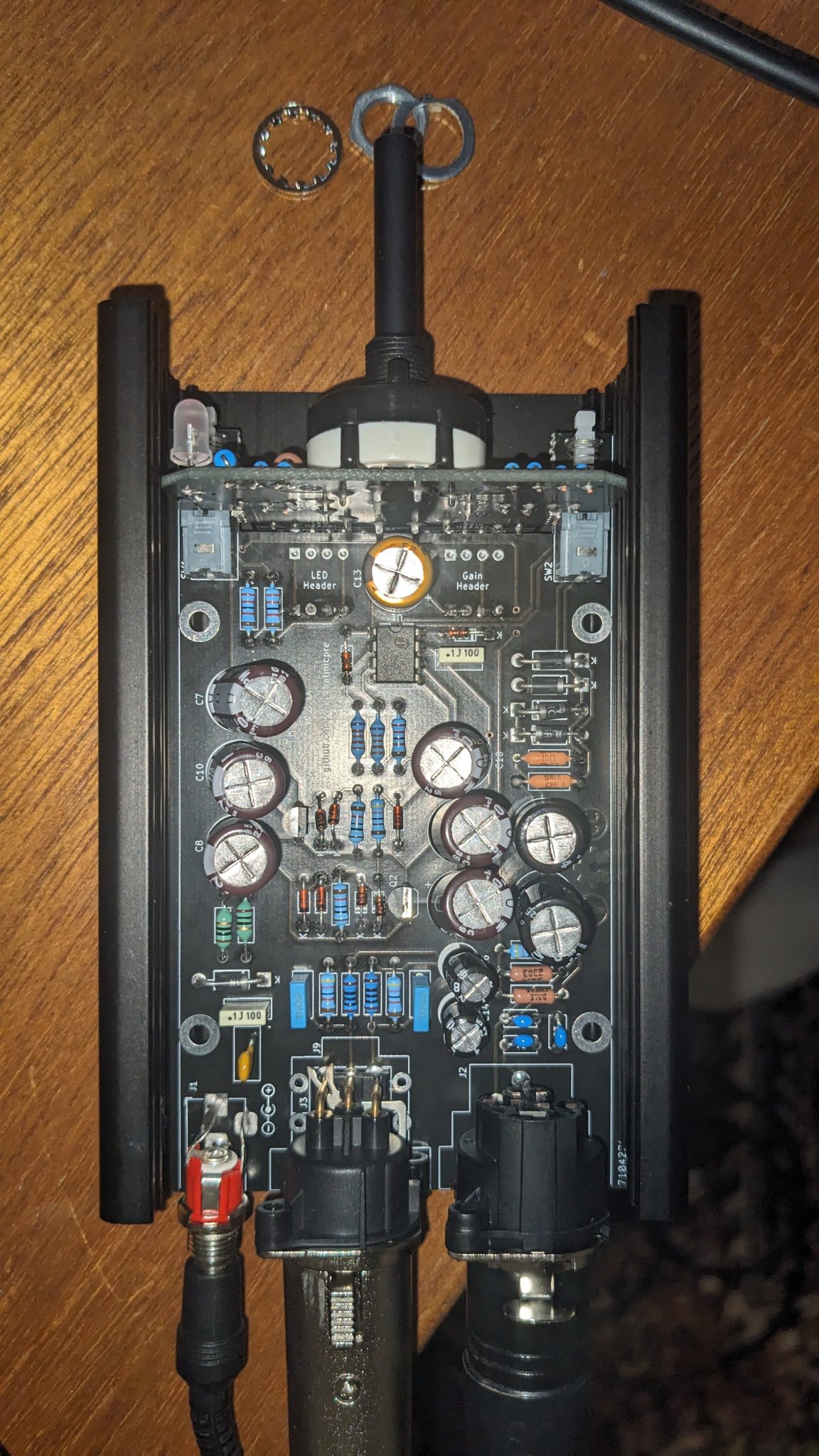

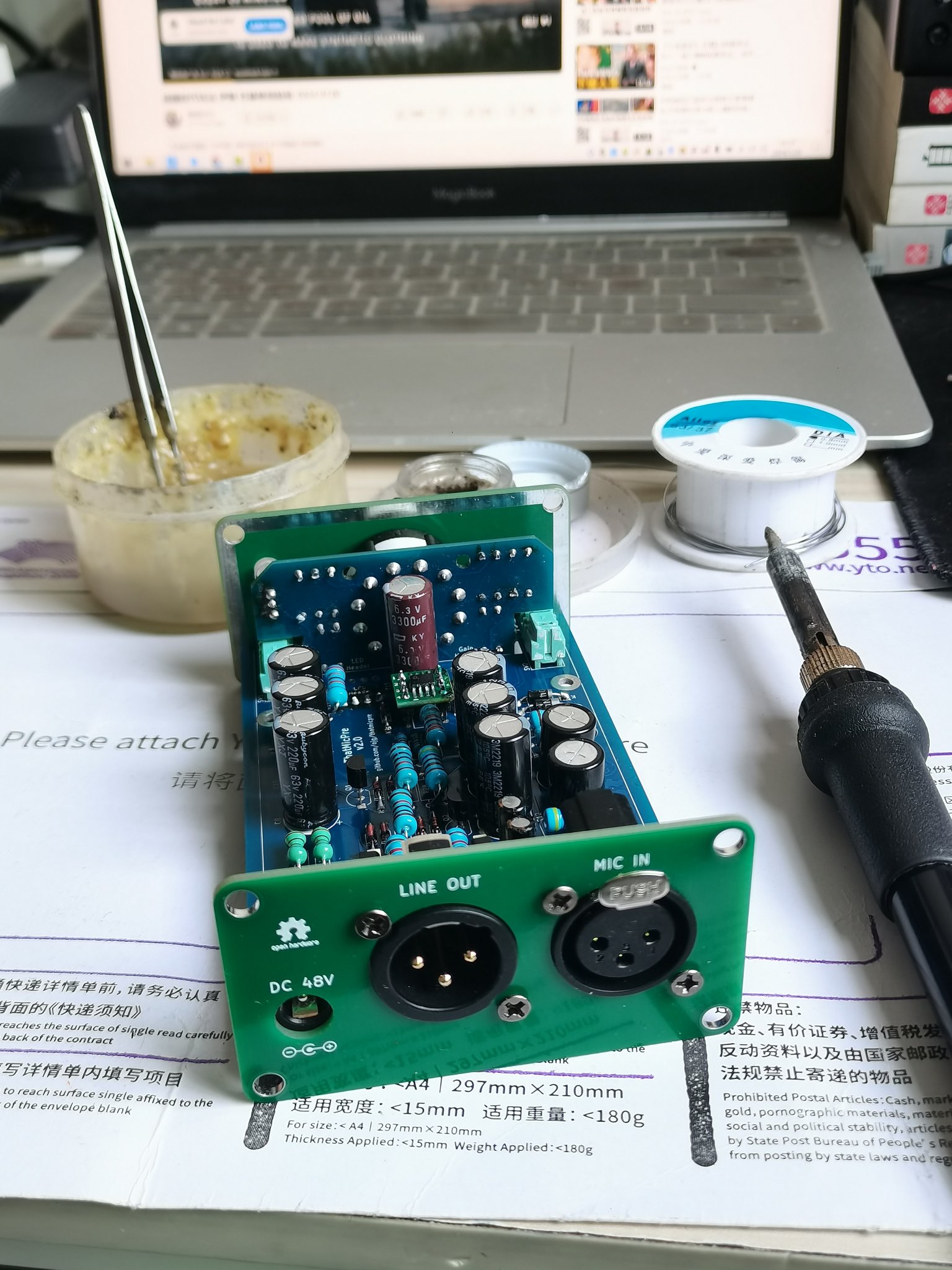

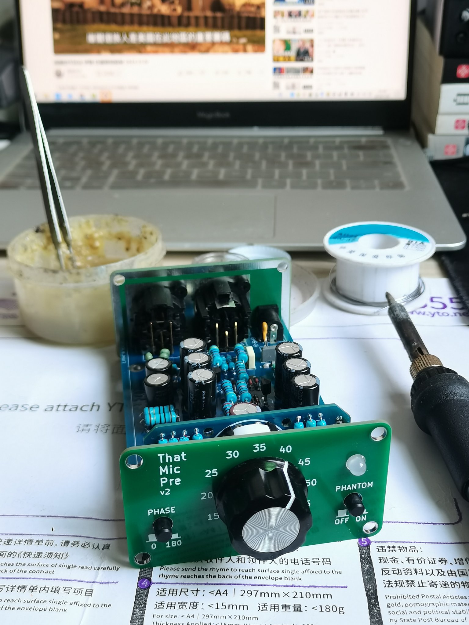

Hey everyone, I tried to build this as a first diy project. Everything seemed to be going good so far, but after a first test, I must've done something wrong. There is no output at first. When i turn phantom on (led green), the preamp makes a loud squeak. When I turn phantom off, I get an output for 5 seconds, before the audio gets distorted an progressively dies.
Would anyone have a clue of sections/components to check first?
Thanks so much!

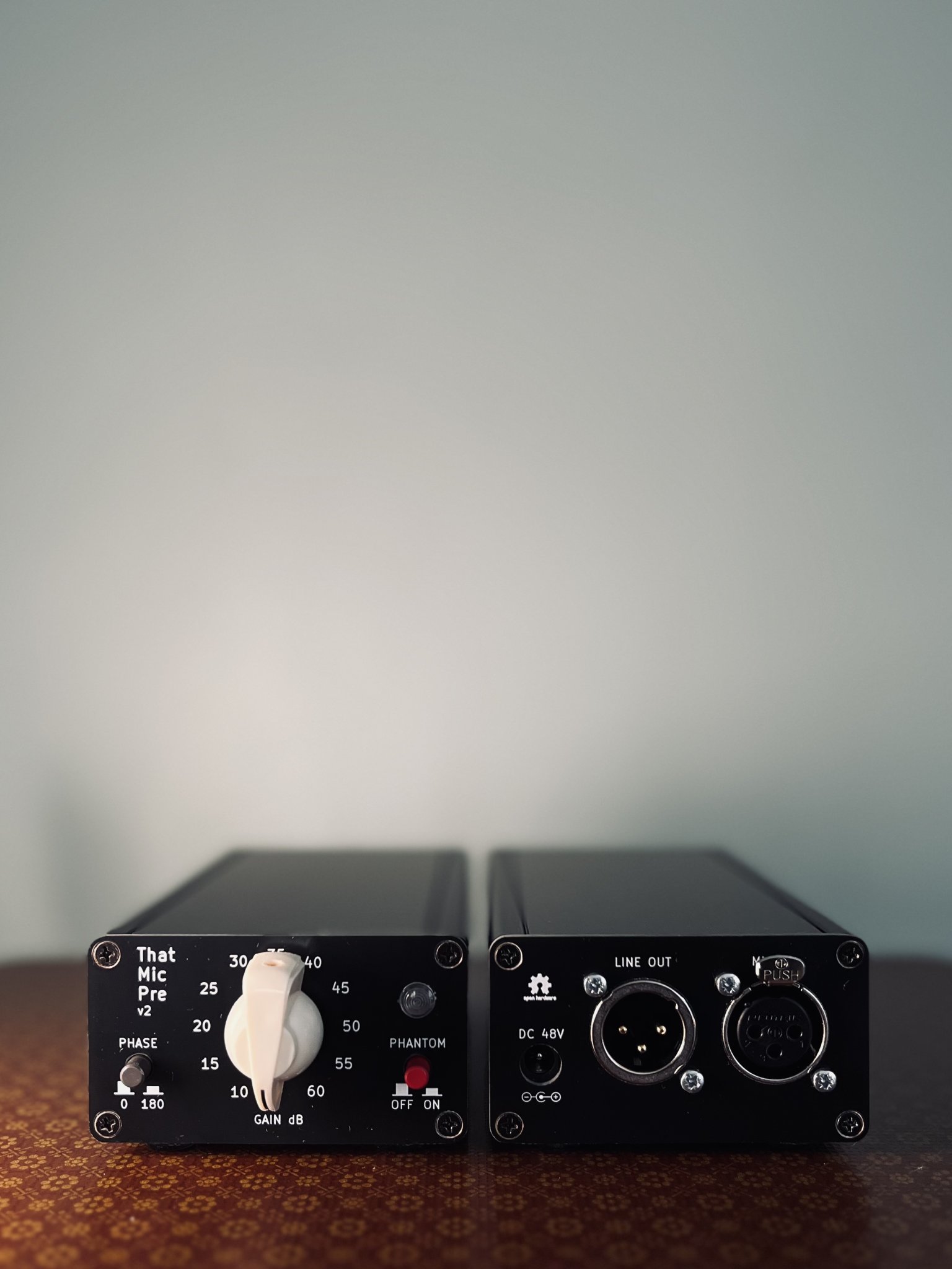

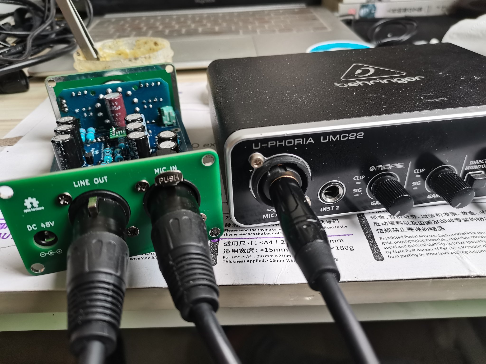

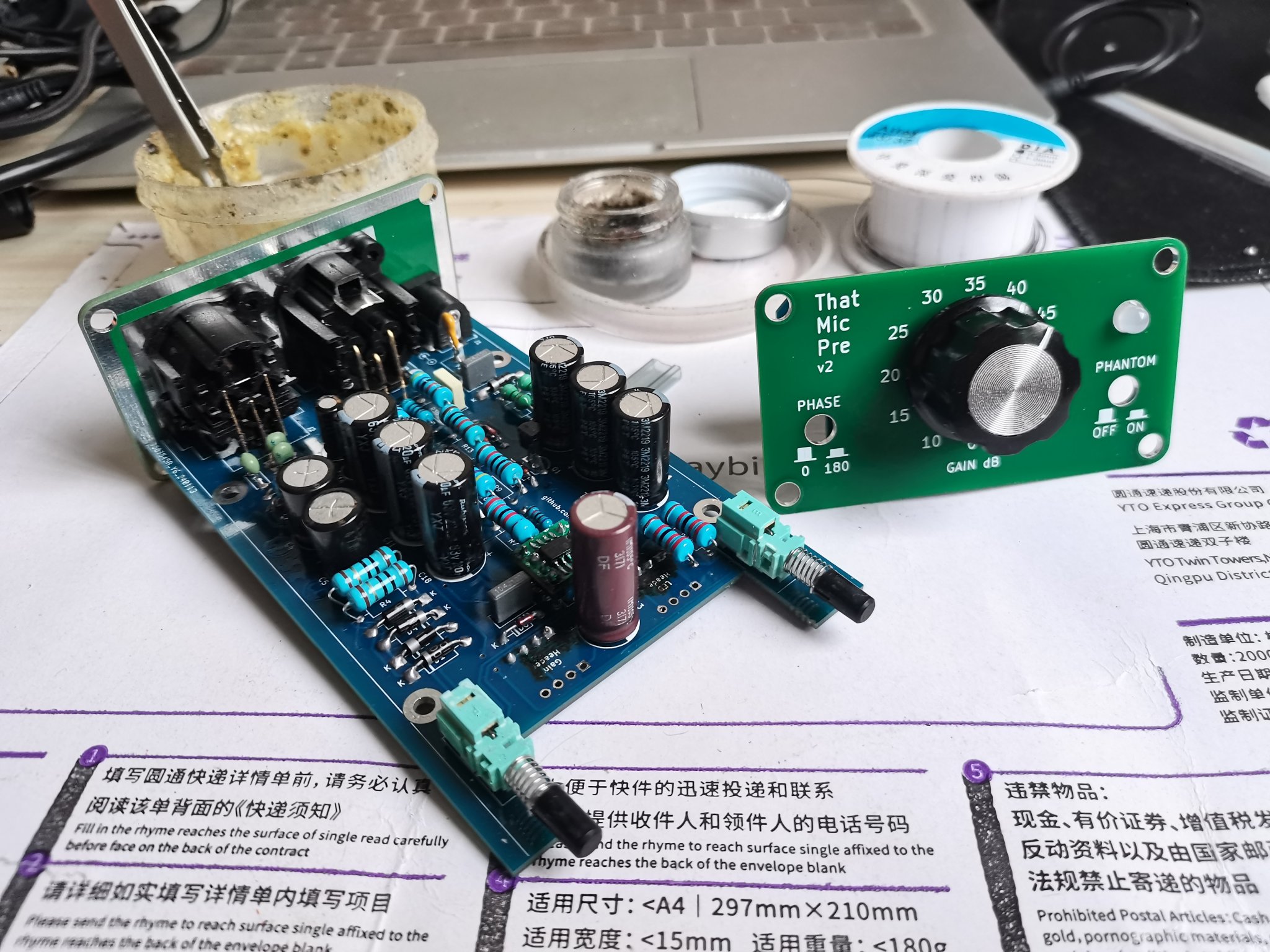

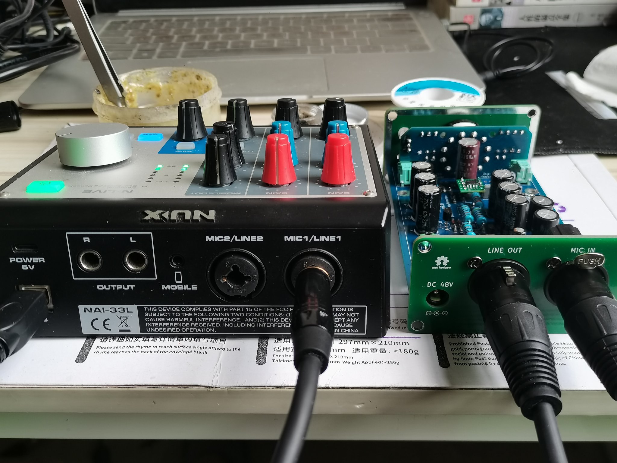

huangok2023 and hanyang, thank you for sharing your builds!
antoine_glis: That's unfortunate. Let's try to figure it out together. I can't see anything immediately wrong from your picture. Do you have a multimeter? Can you measure the DC voltage at the nodes where it says V48P and V35P?
