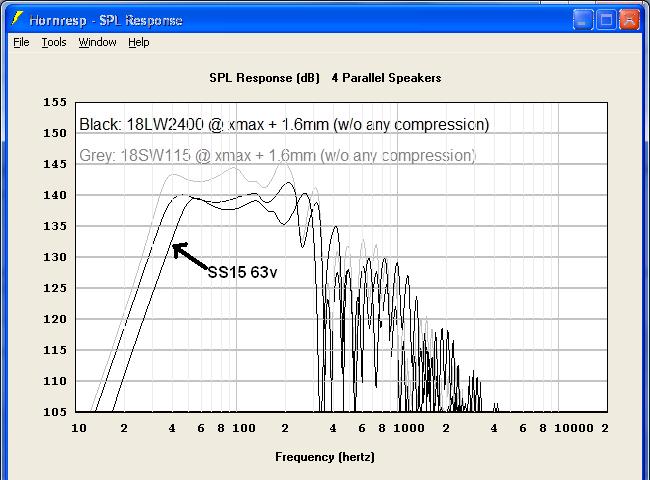

You should do a comparitive measurement. Set up a pair and run a sweep in REW and then swap in the other(less efficient) set and sweep again without making any adjustments. Any mic and sound card will do as long as you are not overdoing it with the levels. I've no doubt the 18's can move more air but I am currious about the difference in response. The SS15 is a known quantity so it should be very enlightning.
