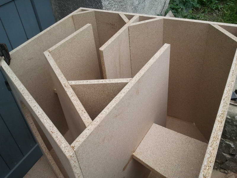

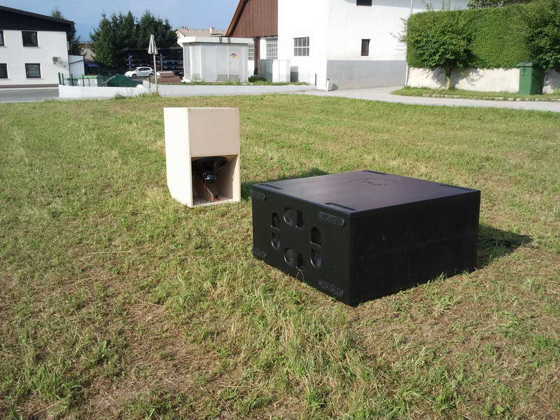

This are the only pics I have at the moment. Yes it's made out of chipboard, the bracings are "little" modified so it was an easier and faster build because it was only intended as a test box. I really liked this TH-18 design and wanted to give it a go. A have a smaller 15" TH but wanted to hear a bigger, more PA oriented TH 18" design
The sub in front of the TH is the LAB.

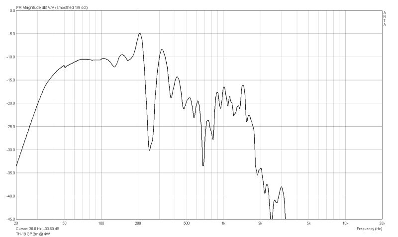

Hi SG3525
Very interesting to see you test results.
The roll off at the LF is of some concern, and the deep null around 250hz is interesting.

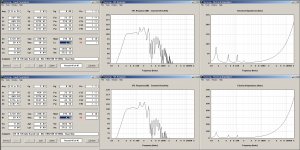

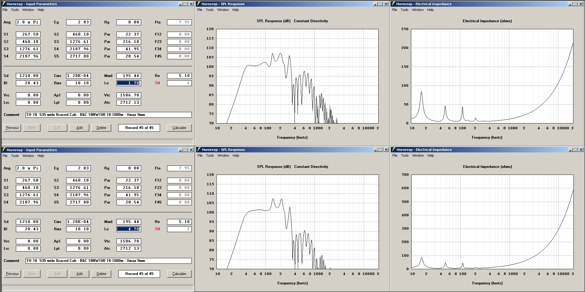

Playing around with the parameters in Hornresp My first assumption is that the Inductance Value, Le quoted at 1.7 mH must be considerably more at lower frequencies.

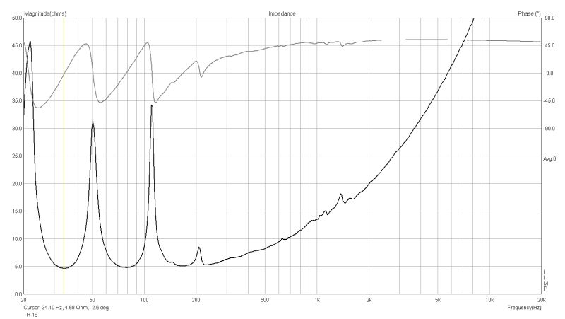

SG3525, the other point I noticed with your test results, is the lowest Impedance peak is at a higher frequency.
You have a peak at 23 Hz but Hornresp predicted the lowest peak at 16Hz. The other peaks are at the predicted frequencies.
I wonder if this low frequency is affected by other parameters, such as any Hi Pass filters in the test system.

Martin, the roll off is not a concern and happens with all TH's of this efficiency.
It starts to roll off (the system looses its efficiency) from ½ WL just like an ordinary horn and it’s -3dB point is around 1/3WL.
If you lower the efficiency of the TH the roll off is lowered in frequency also. In stacks this will be fully recovered. HornResp doesn't 'see' the changing of the Le of the driver downwards.

this is why i always double le vallue from 1 khz value for subs.HornResp doesn't 'see' the changing of the Le of the driver downwards.

Doubling or even tripling the value is a possibility. The problem however is when you double the value it isn't high enough for the lowest octave of the sub range and too high for the highest octave of the sub. I would prefer to see some sort of curve of which you can change the values. But the roll off is not just the function of the changing Le value. It's also 'old fashion' horn principles. I agree that the curve from SG3525 measurements looks actually pretty good.this is why i always double le vallue from 1 khz value for subs.

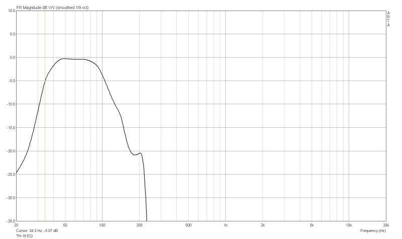

Just done some EQ work. In the measurement below the filters are set at 32Hz and 100Hz both 24db/BW and one EQ at 38Hz +5db Q:2,8.
Hm... It's pretty god at lower levels but at higher levels the "chuffling" noise from the B&C driver really becomes annoying. It's probably the cooling system or distortion from the driver when over Xmax, maybe a combination of both, still need to do some more testing. I'll have to try it with a stronger driver and see how it goes.how does it sound SG3525?

I have taken to analyzing the shape of the response curve using the Hornresp Loudspeaker Wizard. The Le value can be varied upward to get an idea of how the response changes. Unfortunately varying the Le value has a greater effect than any minor tweeks that I have tried with the shape of the TH18 horn.
