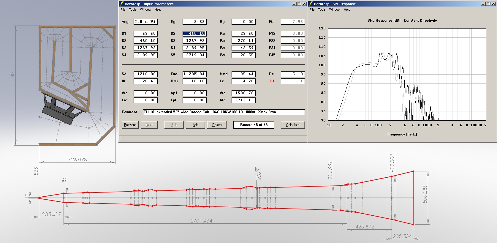

It is certainly possible to stretch this the fold in order to gain some path length but if you would like the results is debatable :confused:
I have taken an early version without the extra reflectors, and stretched it to 1140 high. I also have straightened out the bulge in the path at the first bend by increasing S1. This makes the Hornresp sim look slightly worse at the 100hz dip but is not so significant when you model the entire path in Akabak.
I have done a comparative sim, using your test driver, with a tweaked LE value that gives a best match to your measured data.
The original box as you built is the grey line in the SPL response window.
If it is worthwhile, I could supply you with some more dimensions to prototype a cabinet.
I look forward to seeing the results of removing some of the reflectors:)
PS its going to need a bit more work but this should give a reasonable expectation of the differences!
Regards
Martin

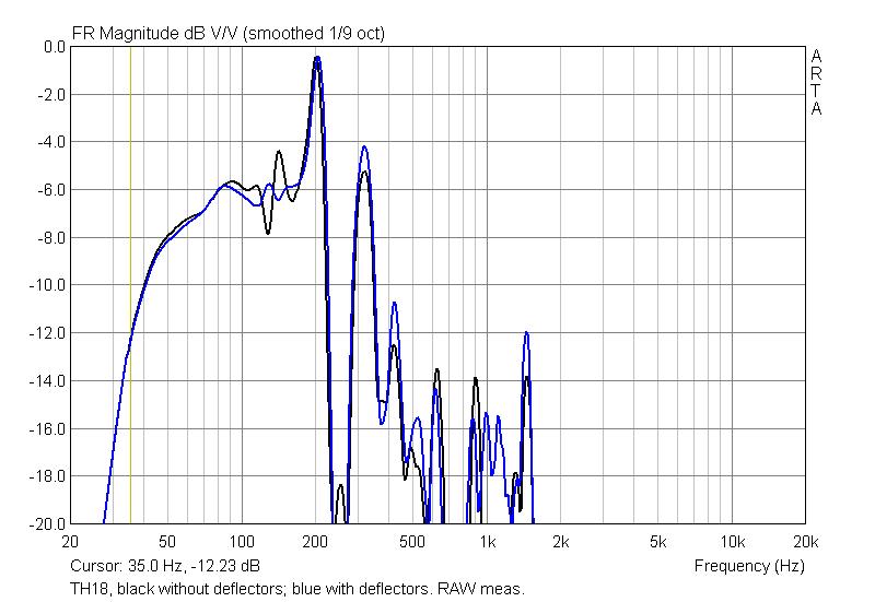

Hi XoC1, thanks for the sims. Yes the higher efficiency of the original does look better :) Below are the comparison measurements of the original TH with deflectors (blue) and the one without (black). The only noticeable difference seems to be in the 45 to 65Hz range. All measurements are RAW.
Currently the next thing is to wait for the 4 Ohm 18SW115 to come and then some more testing to see if the added power and 5mm of Xmax do any difference :)

Hi Sg3625
Thanks for the measurement plot.:cool:
There seems to be a trade off between more LF energy without the reflectors, and a smoother extended HF with the reflectors.

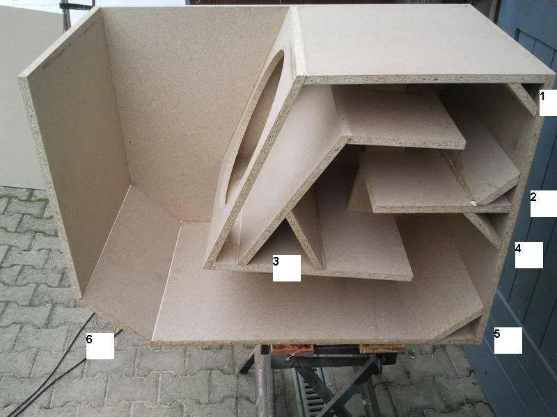

When you say you removed the reflectors, which ones did you remove?
I have put some numbers on one of your construction photos for reference.

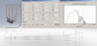

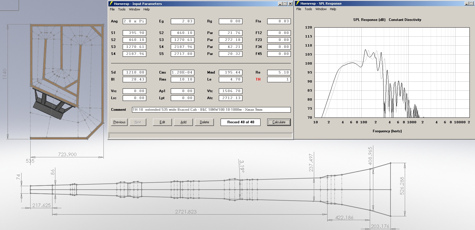

I have reworked the 'extended' concept for the TH18.
I am fairly confident that the horn taper on this folding is accurate and linear.
Target error tolerance is < 0.1mm :D
I added a extra panel to the horn throat in the same way that Josh Ricci has used it in the Othorn & Gjallerhorn. This seems to reduce the 100Hz dip in the response.
Adjusting the S2 dimension in this fold as suggested by epa is not easy. The way the horn width dimensions stack up, effects the front to back depth of the cabinet. If anything the response looked flatter with a smaller S2 dimension when adjusting in the Hornresp Wizard, but that is not practical with this folding.:(
Screenshot shows latest attempt. Original cabinet response in grey.

[QUOTEI added a extra panel to the horn throat in the same way that Josh Ricci has used it in the Othorn & Gjallerhorn. This seems to reduce the 100Hz dip in the response.
][/QUOTE]
Looking at the graph, I dont see less of a dip at 100Hz? I see more of a dip.
Am I missing something?
Andy
