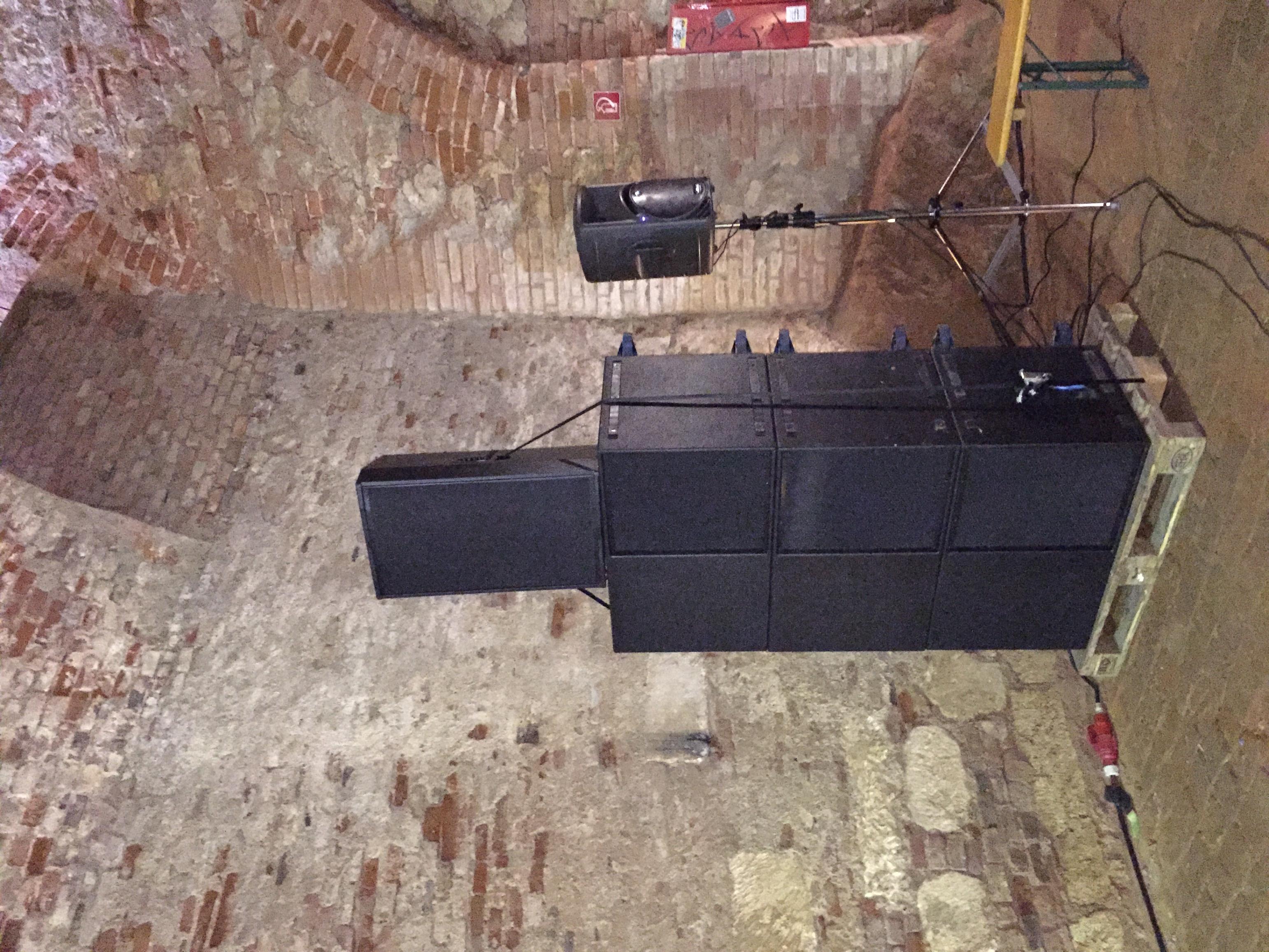

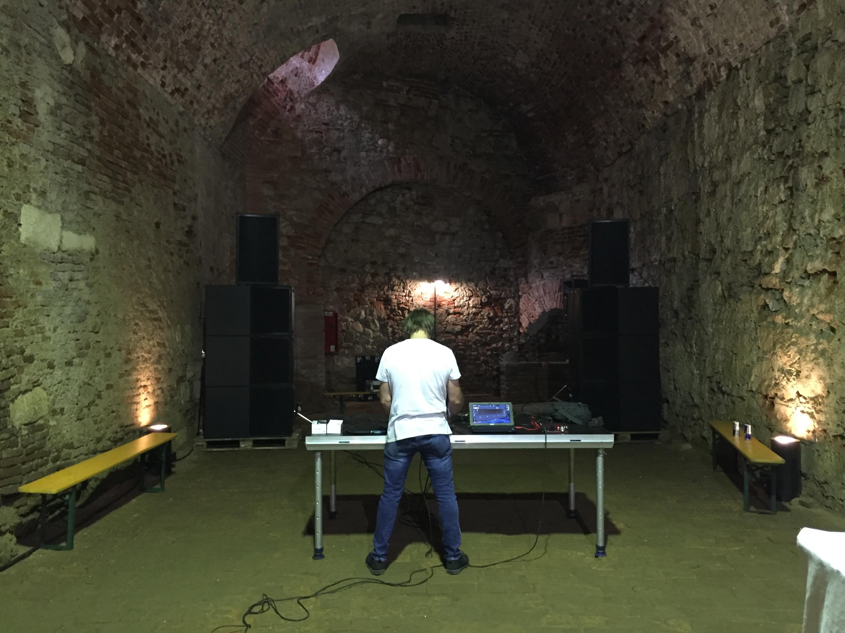

Hi
Positioning subs in the right distance to walls or to each other is very important. a single-cluster near the walls is the best thing fore sure but mostly not possible. yesterday we built up 3 TH118 per side. the distance to the backwall was about 5m, the distance between L and R was about 7m. the effect was a loss of pressure around 30-35Hz. there was also a deep flutter-effect. some frequencies sounded like they would come twice. it was very strange and sounded disappounting. then we changed the distance to the backwall. with 3m we shifted cancellations to higher frequncies (shorter wavelenght). after that the sound was perfect. nearly flat response down to 30Hz. 25Hz were also impressive (playing judgement dub).

The greatest difference between Europe and the new world is the construction of buildings. Here the walls are essentially invisible below 30 hertz unless there is a brick or concrete block outer wall. In Europe masonry construction is the normal way not the exception.
in this special case even Napoleon wasn't able to bomb the castle down. this historic room is in the underground surrounded by rocks. good for techno and no stress with the neighbours

What tops do you have that kerp up with 3 th18?
double 10" hornloaded low-mids with Faital 10FH500 (100-700Hz) + BMS4590 Coaxial Mid/High (700Hz/7kHz) with Limmer 033 horn (60x40), all selfpowered with Pascal X-Pro3 Class D Amps + 64Bit/96kHz DSP from AllDsp (Germany).
using 3 TH18 the input of the top is set to 0dB, using 2 subs it's -3 dB and when using only one TH input gain is -9dB. works well...
