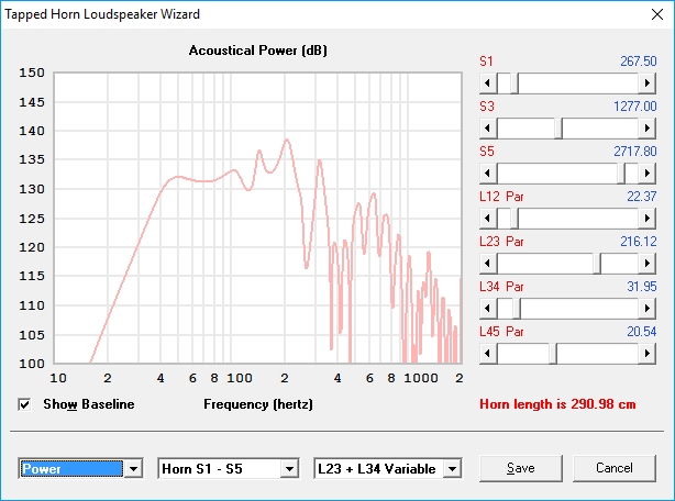

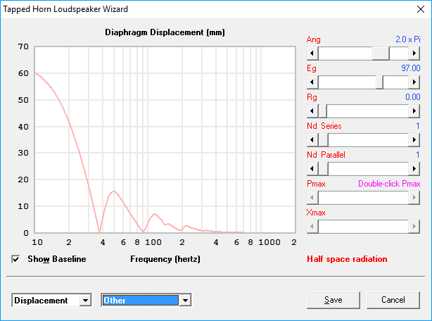

That's curious - I sim'd the 18HP1060 in the TH 18 and the results don't seem to indicate a driver/cabinet mismatch. And HornResp suggests that it will take almost 1.2kW to drive the driver to linear Xmax. See sim'd results attached. And a 30Hz 24dB/oct. filter should be enough to keep excursion below the TH's resonance frequency in check.
Of course real results will trump sim'd ones any time, but if I was testing this build for problems, I'd start at limiting the power input to 300W and slowly adjusting it upwards while pulsing it with 50 Hz 6-cycle tones (in-band maximum excursion occurs at that point). I'll bet that the build should start to give problems somewhere north of 1.2kW (the driver is going non-linear at this point of course, but should not be driven to Xmech). If however it starts to show problems well below that, then it's time to take a closer look at the build itself IMO.

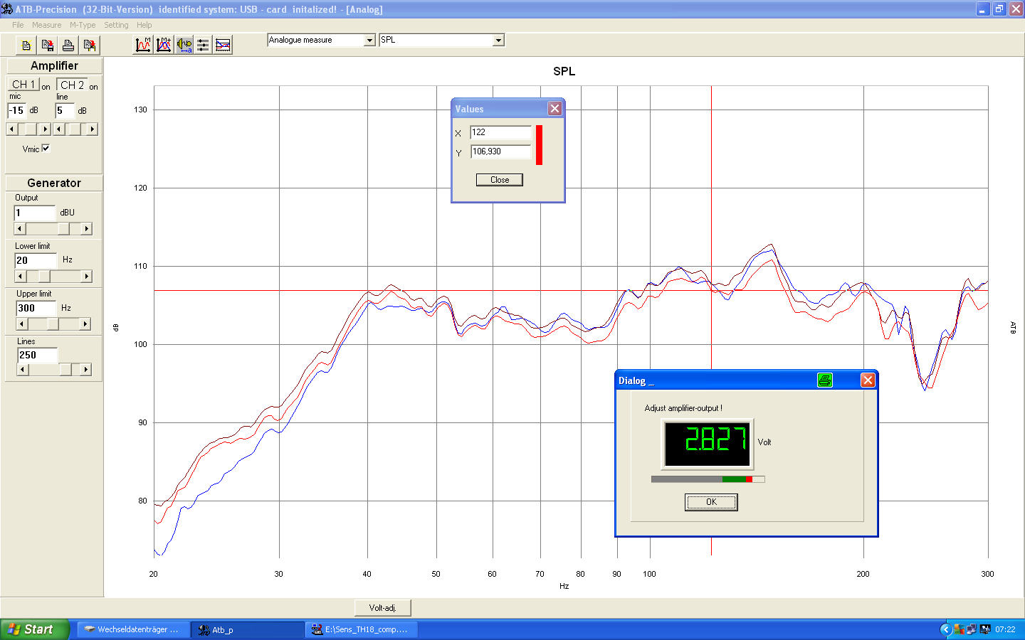

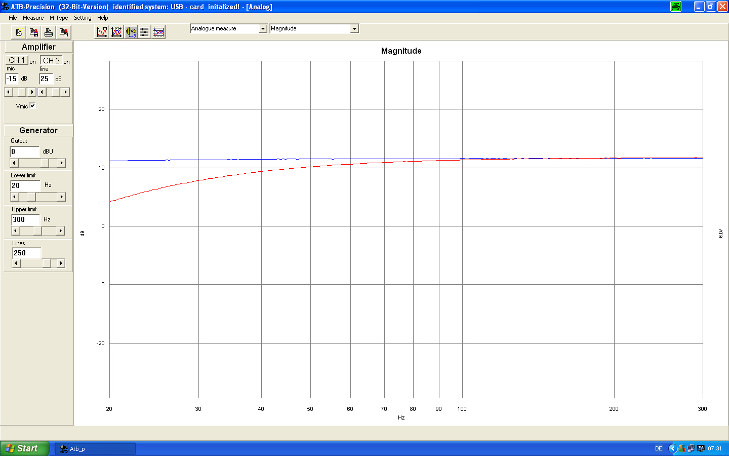

Hi
yesterday i did some sensitivity measurements with my TH18s. I borrowed a mesuring equipment from a hifi workshop which is very easy to use. its a closed hardware based system from a german developer called Kirchner ATP. The system can calibrate the amplifier voltage directly for sensitivity measurings. Impedance measurings, TS parameters and many other can be done directly.
It's an older system running on XP and it's made for hifi applications. it can't handle heavy PA levels above 130dB so i have to check splmax separatley.
The 1W1m measuring was made indoors and looks good (driver = Faital 18HP1060)

Looks good BertlSound! Is that 18HP1060 4 or 8ohms? Mine are loaded with the B&C 18SW115 4ohm with cone compensation so I'd imagine mine would be about 104dB as well. 2 of them next to each other being 110dB 1w is very nice efficiency!

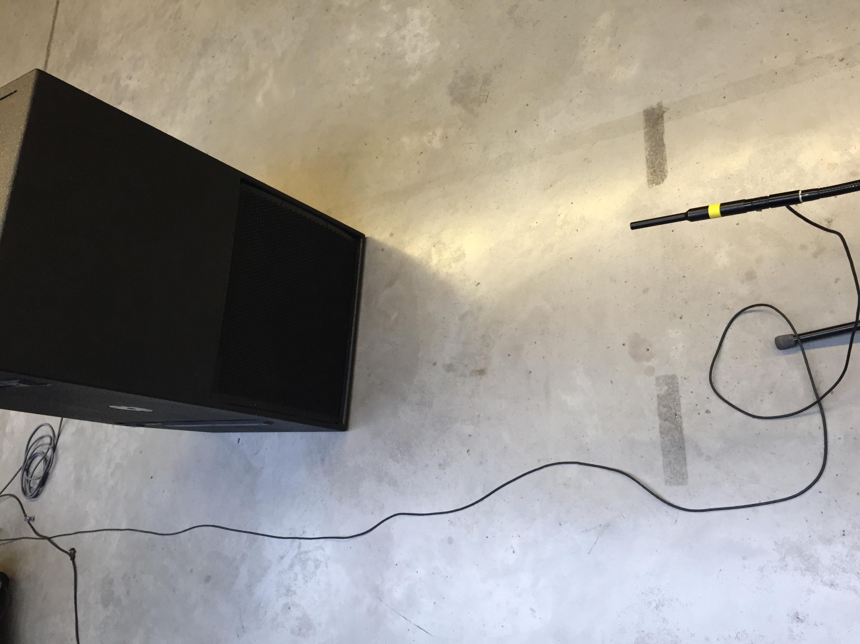

Hy Bertl,
thank you. Did you compensate for groundplane in your graph??
Regards
Hi Sabbelbacke

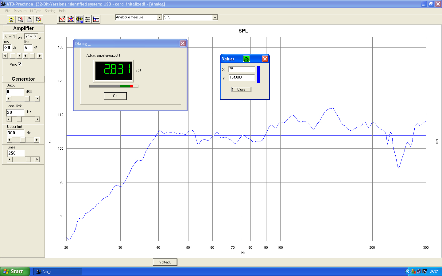

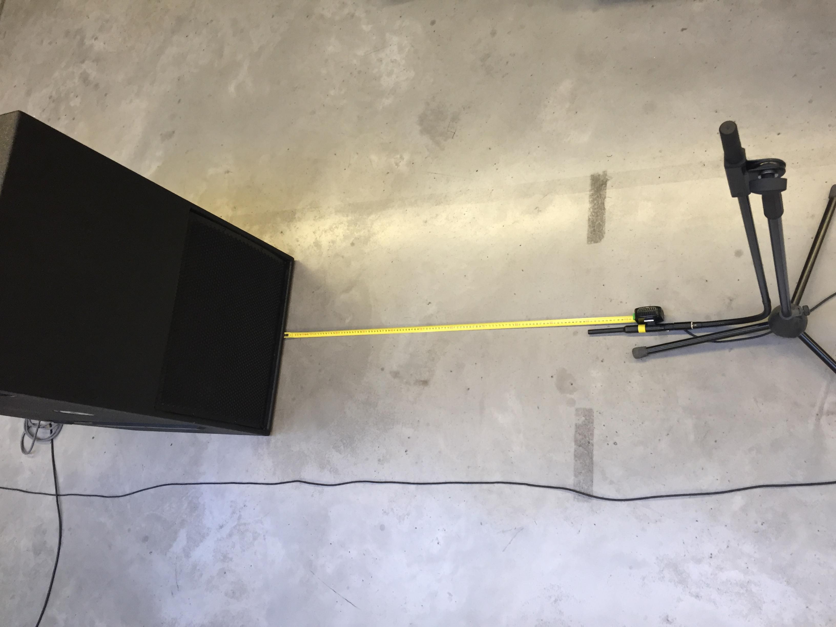

i was a bit confused about the steep roll-off in the mesuring. i also thougt about your advice for the groundplane compensation. your are right in that point, i didn't any compensation.
so i repeadtet the measuring yesterday with same conditions and spend some time playing around with the ATB PRecision. doing so found out a curious thing:
as i said i was wondering about the steep roll off, because i had already done measurings with other systems like Arta, Carma4 and with my Neutrik Analizer before. All that measuring didn't show such a steep roll off. so i checked the ATB in it's self by measuring power-amp out to ATB input. Than i got a little surprise.The ATB PRecision System came with an preamp and a power Amplifier (Mackie m1300i). a magnaditude measuring showed the the shitty preamp causes a roll-off by 6dB starting at 200Hz!! have a look at the graph attached. unbelievable. the flat line is ATB connected directly to the mackie amp. measured with adjusted 2,83V at CH1 out.
then i checked mic sensitivity. this was adjusted (8mV/Pa) correctly. after that i made new measurement outgoing from the first graph.
blue: first measuring, 1W1m, with shitty preamp, mic on the floor, indoors
brown: new measuring, 1w1m without preamp, mic oin the floor, indoors
red: new measuring, 1W1m, without preamp, mic 0.5m obove the floor, indoors
didn't think it would be tricky like that measuring sensitivity but at the end - i hope, now it's done - the result is ok. thank you for your helpful input. please tell me again if there is something wrong with my approach.
