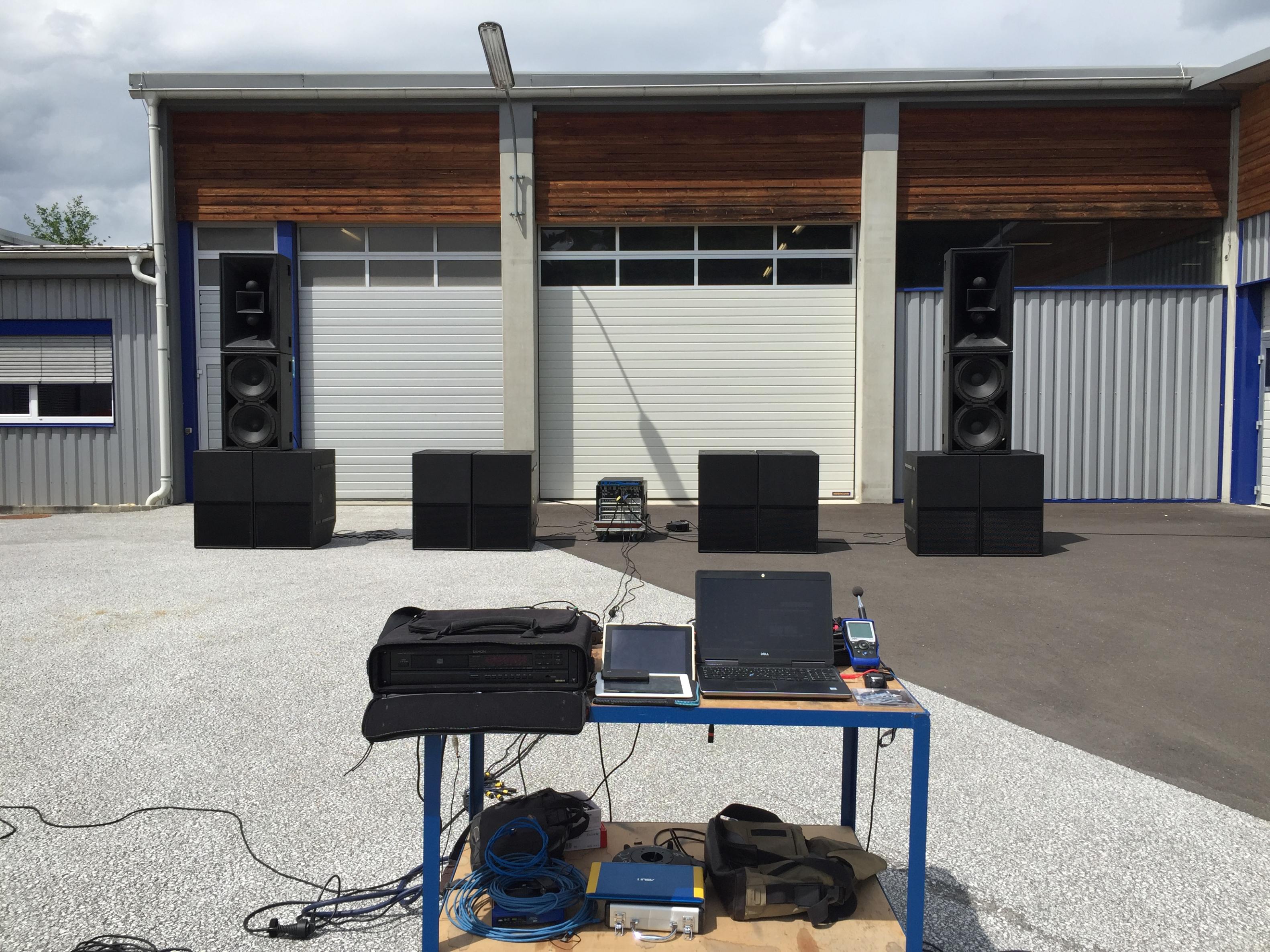

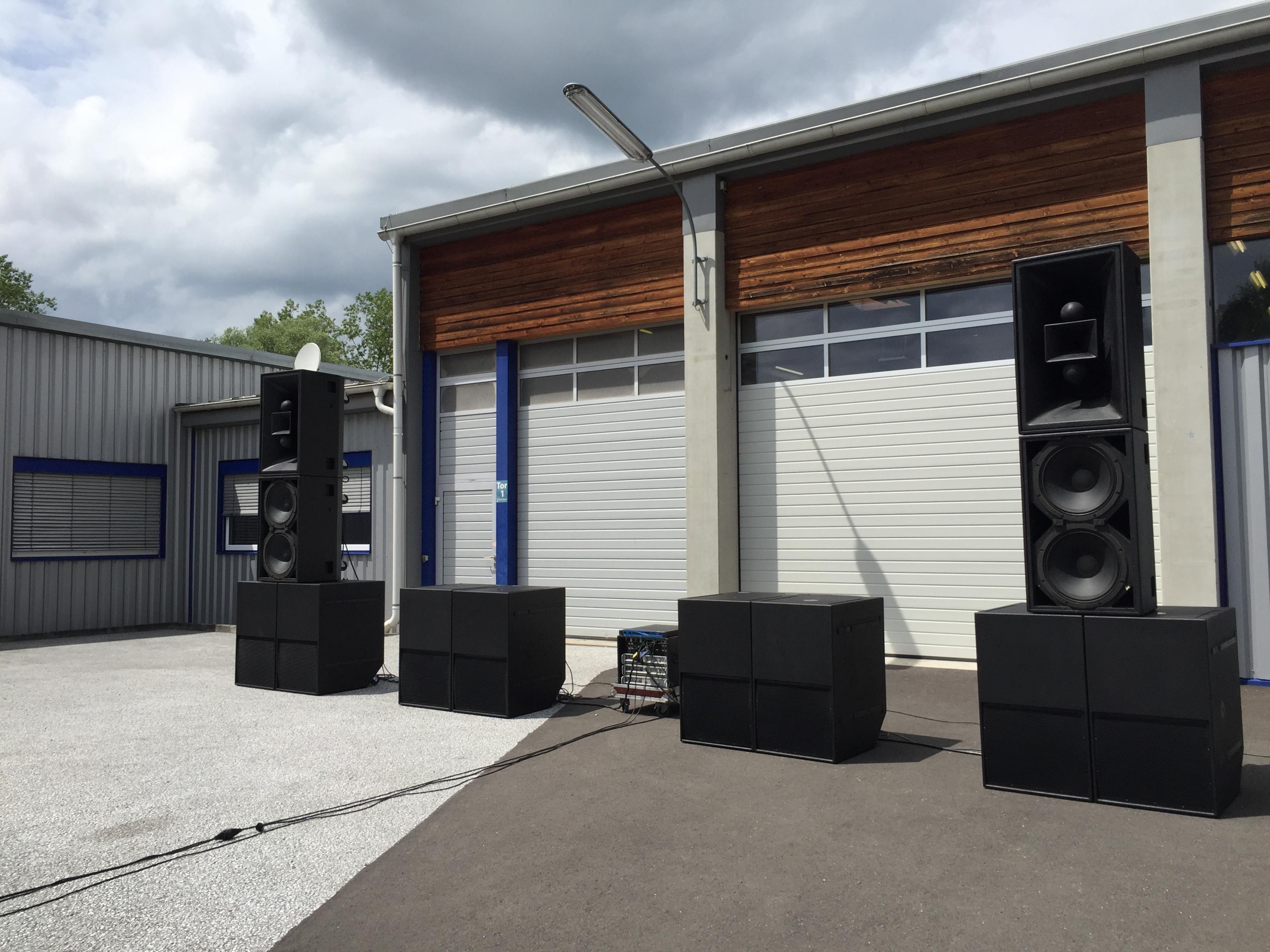

some photos from our testing today. next step in setting up our big system. today we made rhe time alignments. we have 6pcs of these tops, 12 pcs of the double-18s (used as long-throw low-mid extension) and 16pcs TH18 available at the moment. fist dance event we provide on june 30. yeah...

wow lovely build . how powerful does it sound??
