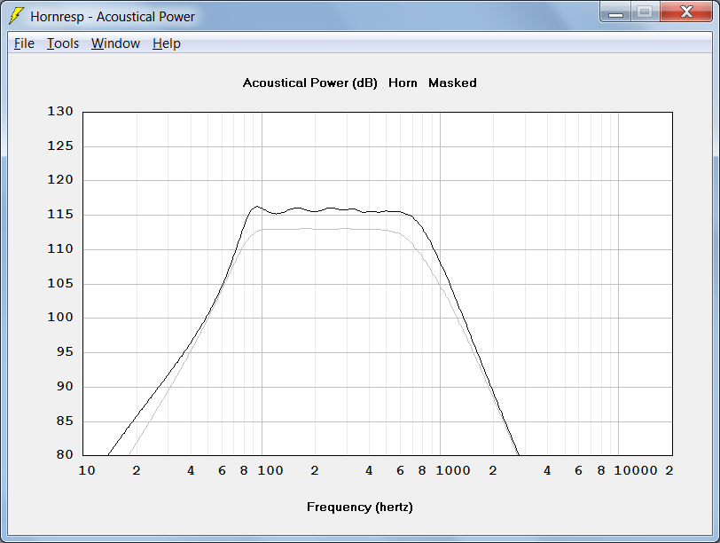

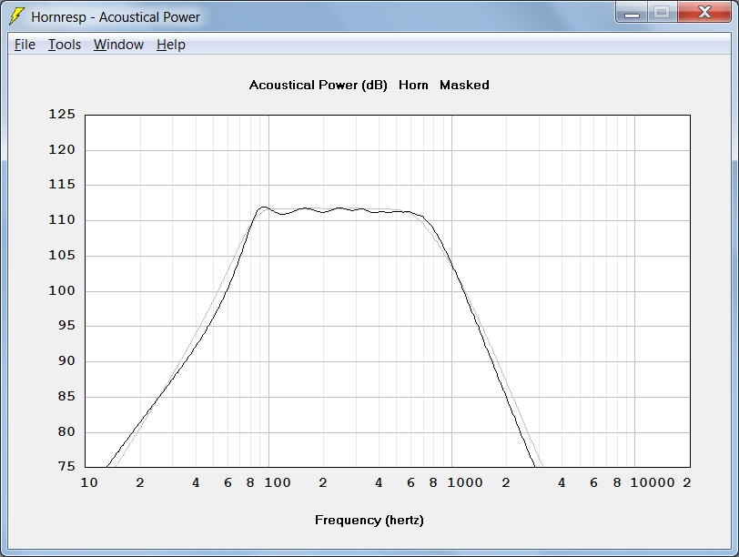

If I understand correctly, all that just a guy is suggesting is to normalise the input voltage Eg to compensate for different driver Re values, so that power response chart absolute levels will not be offset, making comparisons easier.
To illustrate the process:
Attachment 1 shows the standard Hornresp default record (grey trace) compared to the same record with Re changed from 6 ohms to 3 ohms (black trace). Eg = 2.83 volts in each case.
Attachment 2 shows the Hornresp default record with Eg = 2.45 volts (1 watt into Re of 6 ohms) (grey trace) compared to the same record with Re changed from 6 ohms to 3 ohms and Eg = 1.73 volts (1 watt into Re of 3 ohms) (black trace).
I don't see any particular problem in doing this if you can live with having different input voltages for different speakers. As far as the actual sensitivity and efficiency values for each speaker are concerned, they do not change as they are independent of Eg.
Sensitivity is output sound pressure for a given input voltage.
Efficiency is output sound power for a given electrical input power.

- TH 15" flat response to 35Hz (-3dB) - By LORDSANSUI
