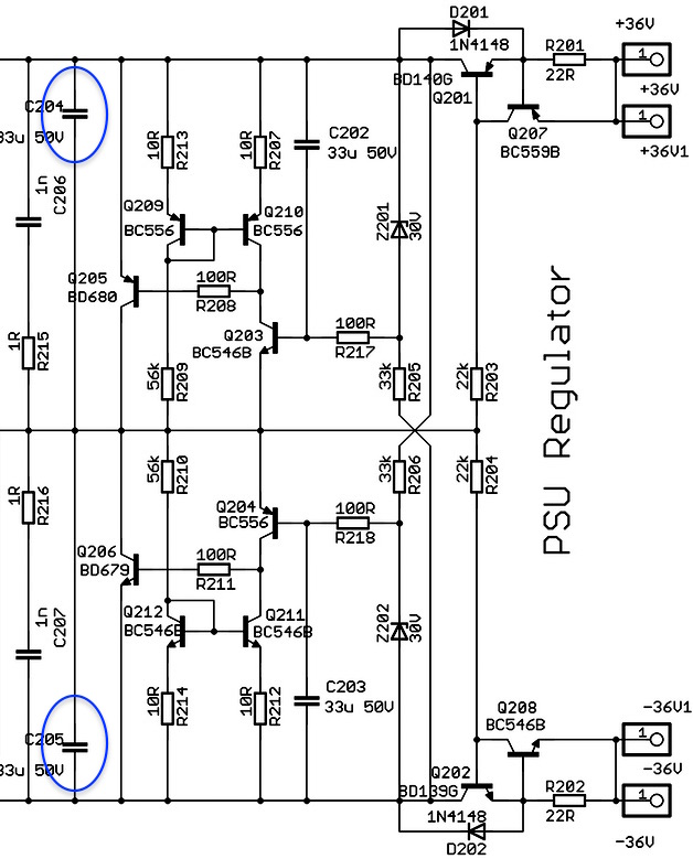

We don't need these caps at all do we ? - they will have a higher Z than the shunt it'self and the shunt doesn't need them for stability. A waste if you ask me. So I shall eliminate them.

At high frequencies the error amplifier's gain begins to roll off, and so the voltage regulator's output impedance begins to rise. A capacitor across the output has an impedance which falls when frequency rises, which is a pleasant cancellation.
I think your calculator will agree with mine: at 10 kHz, a 1.0uF capacitor's impedance (magnitude) is 15.9 ohms. Use that to scale to your target impedance at target frequency. Maybe the answer is, you want 0.0004 picofarads(?) at the regulator output. Hammer upon the keypad and find out.
I've been thinking about it, the shunt regulator holds the rails still, with very low Zout over a very wide frequency range - any signal current flowing through the rails is gobbled up by the shunt regulator. The regulator is an 'active capacitor' as good or better than anything I can fit on the board except at frequencies well beyond the audio range. At 100kHz, the Zout of the regulator is still very low. At r.f. we have an R+C across the rails, a kind of zobel.

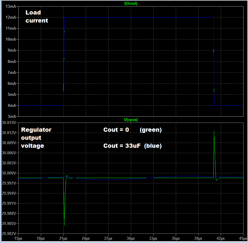

Connect an LTSPICE current source to the shunt regulator's output and have it draw a square wave of current from the regulator. Something like Ilow=5mA, Ihigh=12mA, risetime=2ns, falltime=2ns, hightime=1us, period=2us. Then plot the current which flows in the 33uF capacitor across the regulator output. The capacitor current is the amount of stress removed from the regulator. Every milliamp that flows in the capacitor is a milliamp that doesn't flow in the regulator. The capacitor's action is similar to a bulletproof vest; it absorbs and spreads out much of the impact force of the bullet, so the resulting wound is survivable rather than lethal.
I can't run a sim today. But I can imagine that the current will be shared between the shunt and cap in proportion to their impedance. The lower impedance will dominate and over a large range this is the shunt. Why do I care about some stress on the shunt, it's simply doing the job it was designed for ??
Joined 2011
If you do run a simulation with and without the 33uF capacitor across the output, you might see results that resemble the attached image. It comes from a different shunt regulator, not yours, which uses a different error amplifier and a different voltage reference scheme than yours. But the simulation results might be similar anyway.

I can see the blue is smoother. It says that the shunt regulator is unable to keep up with the current step demand (but it gives up very very little change in actual voltage). But if this has a rise time of ns ? the it's asking for response from the shunt regulator at extreme frequency. I can include a small rail decoupling capacitor, small enough to use something that would work well at high frequency. But isn't this academic ? where will such high frequency signals be generated ? the input to the phono amp has limited bandwidth. Why do I want to engineer the power supply to have low impedance at r.f. ?? - I know I'm being stubborn :)

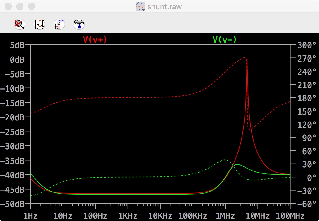

I don't mind if the shunt has to work for a living, take the stress. But I didn't like what I saw in terms of the output impedance (plotted on dB scale) peaking when the capacitance on the rail was to small. I ran a quick simulation with 1uF on the V+ rail and 10uF on the V- rail. There was obvious peaking on the V+ rail. A transient simulation with fast pulse current source produced some awkward moments. The designer has opted to keep rail caps in place :innocent:
