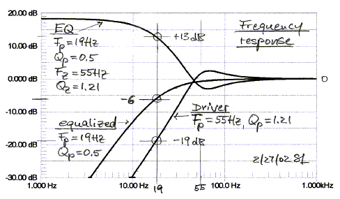

I'm thinking more about Board#3 now - the idea here is to foster some experiments with active cross-overs. I could go out and buy a DSP based thingy but I'd miss the traditional learning possibility with a simpler discrete approach. I do DIY speakers, full range single driver and I'd like to extend that to a full range with supporting woofer with an XO around 300Hz (say). This doesn't need a fancy XO because the drivers I will work with can be chosen to have well behaved responses. A sealed box woofer would benefit from bass-boost.
I also have some commercial speakers, two-way and 2.5-way floorstanders that might be interesting to experiment with using an active XO in the range 2kHz to 3kHz. This is less interesting to me than the first option though.
I don't have very much pcb space available so it should be simple. I am wondering if I can realize a simple set-up, a) low-pass with optional bass boost, b) high-pass.

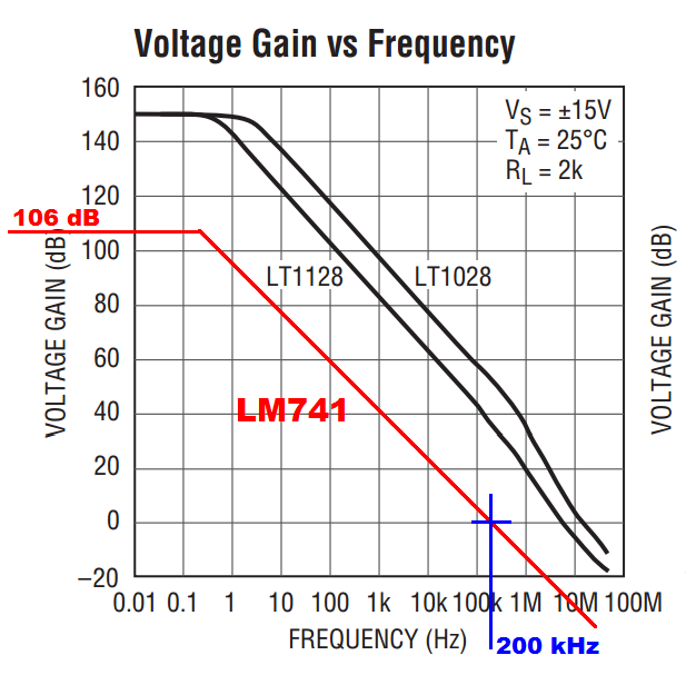

Indeed, and I was thinking of re-using the simple Diamond buffer for that. It could be fairly simple, in the spirit of the Nelson Pass B4. However, to do a nice job of bass EQ for sealed woofers - I have not yet seen an implementation of a biquad that didn't involve an op-amp for gain ?
Mind you, it is my chance to use an op-amp, which I've never done before and for bass EQ, even a 741 has enough slew rate

Thrust me you do not want to add a fixed boost bass circuit. I take it that is the schematic on Elliot Sound Products deigned years ago by Linkwitz. If you have a 10 watt amp driving the majority of your speakers and you have a 20 dB gain at the low frequencies, the bass amp must be capable of a 100x that i.e. 1000 watt????

My interest in the bass-boost (yes, the biquad such as that shown on Elliot's site) is for bi-amping. The whole of Board#3 is an active XO for bi-amping experiments. I have more amplifiers than I have speakers. I'm not looking to have the capability of 20dB gain for the bass but there will still be a much higher power requirement for a sealed woofer bass-extension than the mid-treble drivers. There's not much music down at 30Hz so I don't think I need a 1kW amp for the occasional peak although it would be the right idea on-paper. In reality I don't think I need it. It's worth reviewing the numbers though, if I can get good results with 100W to 150W on the bass driver that would be good.Gareth,
Thrust me you do not want to add a fixed boost bass circuit. I take it that is the schematic on Elliot Sound Products. If you have a 10 watt amp driving the majority of your speakers and you have a 20 dB gain at the low frequencies, the bass amp must be capable of a 100x that i.e. 1000 watt????
a) Electronic low frequency boost - What is the X.max of the bass driver unit you intend to use. Vance Dickerson quotes the case of an example by Marshall Leach who used a driver with 7mm max whereas the box driver combination (Qts 0.707 F3 35Hz) would require near enough to 19 mm for 20 Watts power input to boost the level by 8dB at 24Hz.
Looking at some speakers in the Dayton range increases in X.max go with increase with cone size. Only the very largest ones have 19mm capacity excursion. You could rule using these out on grounds of box size needed to house them.
Needless to say running a smaller driver hard will increase the heat dissipation and operation outside the linear range will result in distortion.
From your projected graph I think it advisable to further consider the prospects of success with this approach.

Actually, I don't take credit for this graph, it's a graph by Linkwitz who invented this biquad approach - I thought it was so famous that his graph would be recognized! I would have to arrange for some switchable gain/fc options for my implementation of the circuit.
At this point I don't have an active speaker project that would use this circuit, I'm just thinking ahead as I've been interested in the idea of bi-amping - a) because I have lots of amps! b) because it might produce a better result. I was originally thinking of using Board#3 to make an optical compressor - they seem like interesting things. But as I don't know if it would ever be used the active XO seemed like a better plan for something to include.
There is a thread that has inspired some of my interest in a woofer + full-range bi-amped speaker project which does suggest a driver choice but there are a number of other options: http://www.diyaudio.com/forums/full-range/273524-10f-8424-rs225-8-fast-ref-monitor.html
