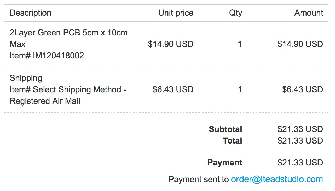

The first board is now officially ordered and Gerber files were uploaded.
This is the slowest I've ever been at getting a design out the door !:yell:

pcb's ? The tracking number shows the package arrived in Canada some time ago. I have found packages from overseas can get stuck in Canada customs for weeks - staff at Canada Post warned me the last time a letter from the UK took a day to cross the Atlantic and weeks to reach my house. Anyhow, we have a big country here, a small postal service with what must be a teeny tiny customs inspection team. I may have to re-order the pcb's but I'll wait a bit longer.
