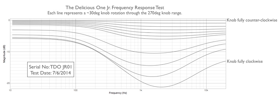

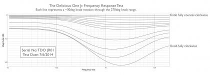

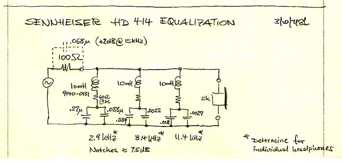

Looking at the plot from Linkwitz I see something similar to mine. He ascribed the curve to the performance of his headphone, but I'm not wondering if that's true. In my case I used headphones with built-in DSP so they will be fairly flat and just using built-in iMac speakers reproduced similar results. I've attached the plot from his website, hopefully not breaking copyright but letting it fall under 'editorial' use.
Also attached is the tone-control curves for the 'Delicious One' .
LF pole, two midband zeroes, HF pole.
Maybe you could prototype it with 3 opamps and 3 potentiometers for independent, non-interacting control of the break frequencies. Find the setting(s) that your own subjective listening deems to be the most preferable.
Ahhh, science.
Now you know exactly what you are trying to design. Implement it with all-passives, opamps, discrete devices, however you see fit.

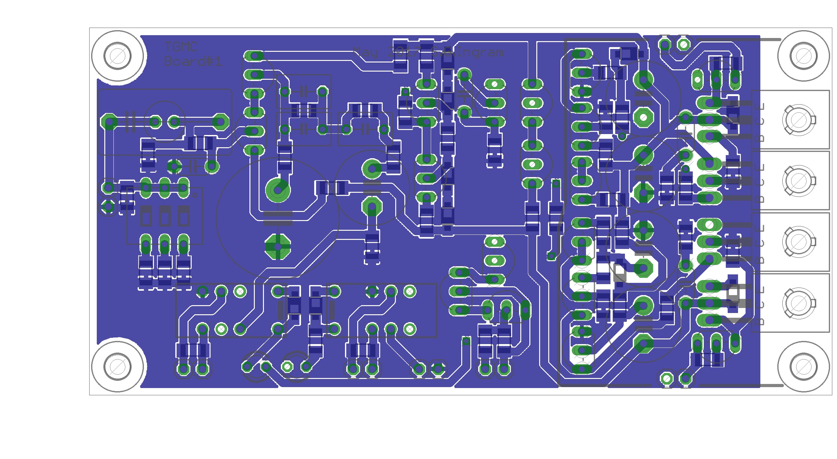

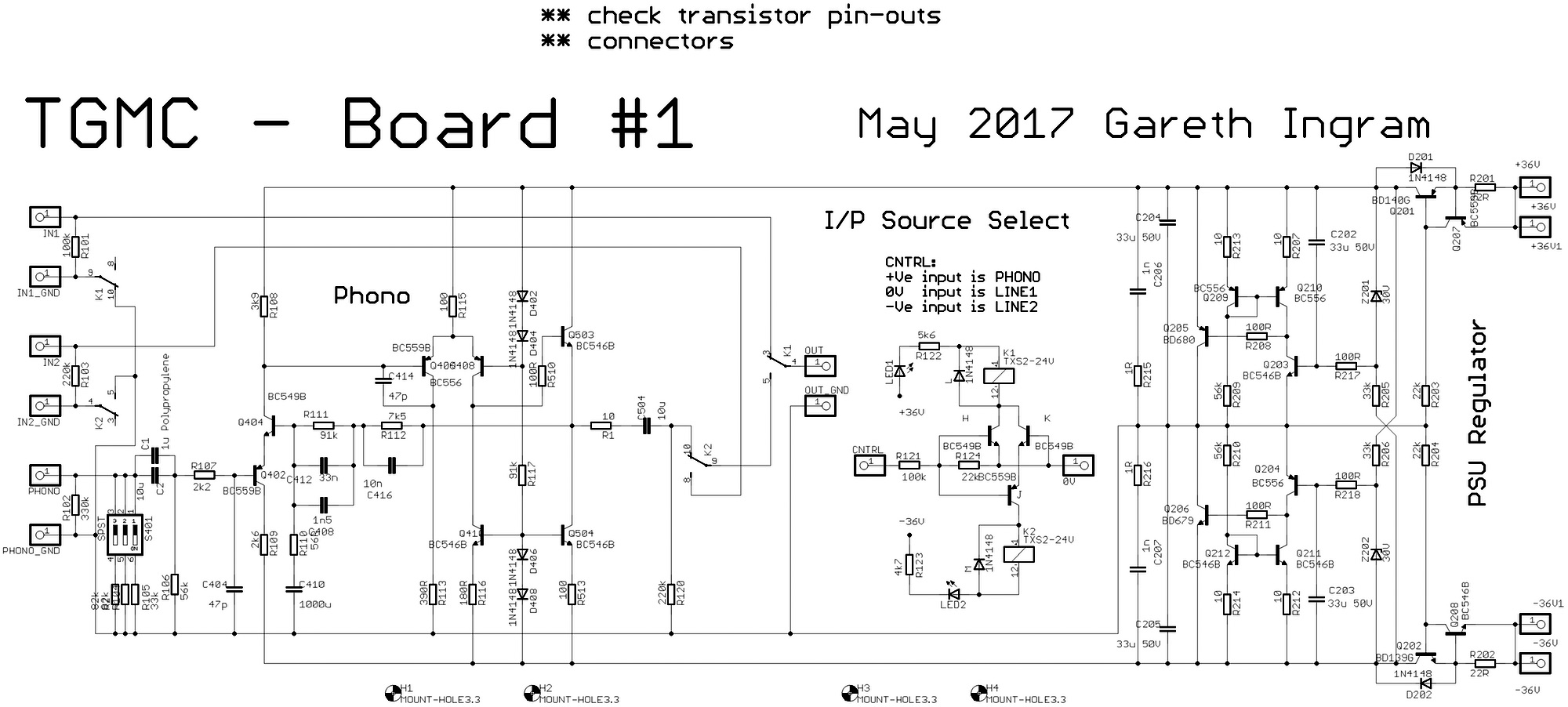

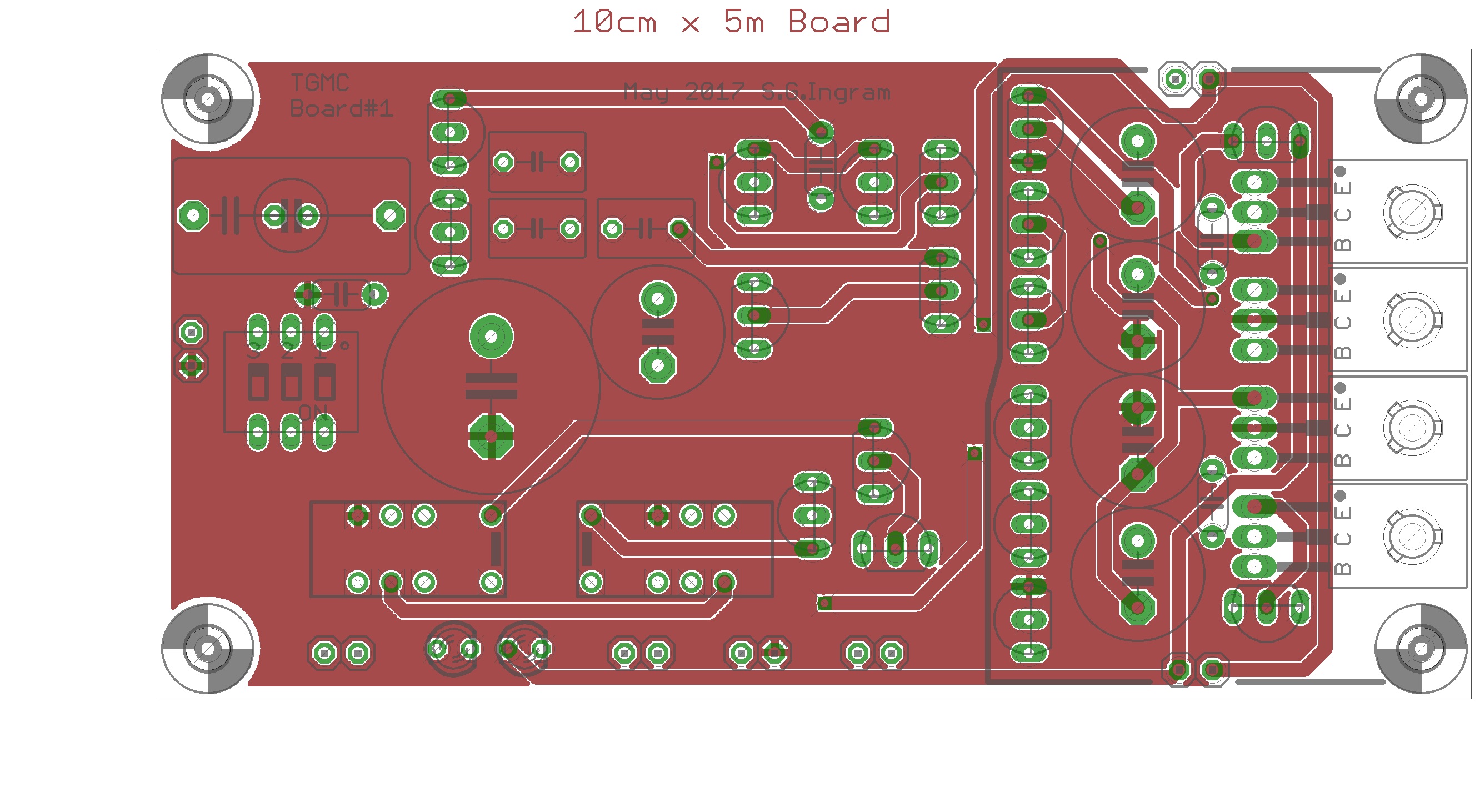

Board#1 Layout
I had a bash at a layout for the first board. It contains the phono amplifier and the source select relays. I used all over ground plane because it looks nice
It's kind of hard to see though, maybe there's a better way to show the layout than this ?
Surface mount parts on the underside, through-hole parts on the top-side. Keeps assembly simple.
This version of the phono is the combo, NAD 3020 topology is the starting point but I grafted on the output stage from the NAIM line-amp and used the better drive to reduce the impedance of the feedback network (NAD 3080 did this too).
Phono inputs on left-hand edge, isolated from everything else. Input and output signals at bottom edge. The shunt regulator supply is at the right hand side bottom edge and duplicated at the top edge for convenience.
I think I'll let this one sit for pondering.
