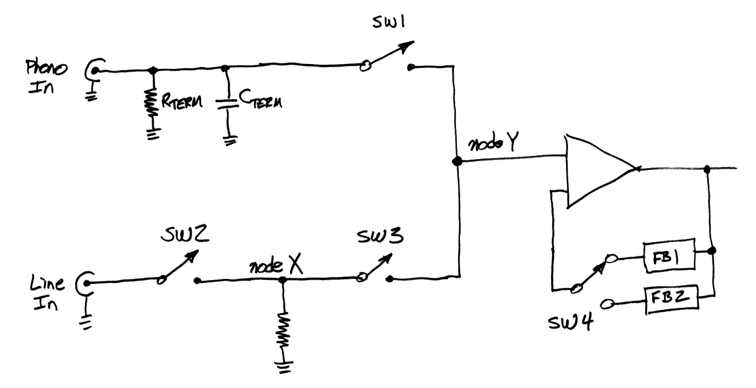

One concern about the input switch is: it requires you to route 2000 mV signals immediately adjacent to 2 mV signals. There can be "crosstalk" (signal injection) from the big strong LineIn, to the weak and tiny PhonoIn. And it's 60 dB worse (1000X) than other crosstalk situations, thanks to the disparity in signal levels.
An obvious brute force solution is: implement the switch with relays, and connect two relays in series where necessary. Then put a lot of distance between the two series relays. Shown below.
SW1-4 are the contacts of relays. To select Phono, SW1 is closed while SW2 and SW3 are both open. SW4 selects the Phono feedback network (RIAA). To select LineIn, SW1 is open while SW2 and SW3 are both closed. SW4 selects the LineIn feedback network.
The key is that SW2 (and the LineIn node) is a long loooooong way away from nodeY. When Phono is selected, there is no signal injection from LineIn to node Y. NodeX, the signal which is very close to nodeY, is quiet.

Series relays - that makes good sense. However, my hair-brained all-in-one amp that looked interesting on paper will probably become a headache later so I'm going to look at a couple more options from pcb layout space perspectives. If I can put all this on the first board I'll have more options later as to what goes on other boards.

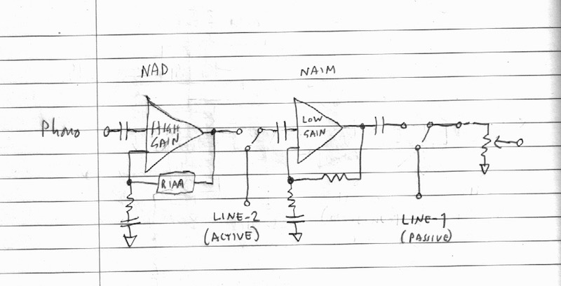

Attached scheme (phono amp based on NAD as before, cascaded into the NAIM amp) - it avoids any relay switch contacts in the phono input, the phono ground or the phono RIAA feedback path. All of which is probably much less risky.
I envisage buying or making a digital source (I'm currently without, having sold off my YBA CD player last year) and said source may become my main listening source for the CD's I ripped onto my HD and for internet streaming services that I read are becoming the most likely face of music in the future. Digital source likely won't need any gaining up but it may need a volume control so it will pipe in to 'Line-1' which also doubles as the 'passive preamp' input.
I have an FM tuner, which I like to use. The output is lower than a CD player, it'll benefit from a bit of gain and so it will pipe in to 'Line-2' the 'active' input for some modest signal gain.
And that leaves my TT along with 3 LPs (a couple of them might be double discs but one is unopened since Christmas) which is where I'll use my phono input.
Looking at this scheme I get nervous about so many capacitors, but I don't see how else to avoid nasty switching spikes if dc-levels aren't well controlled.

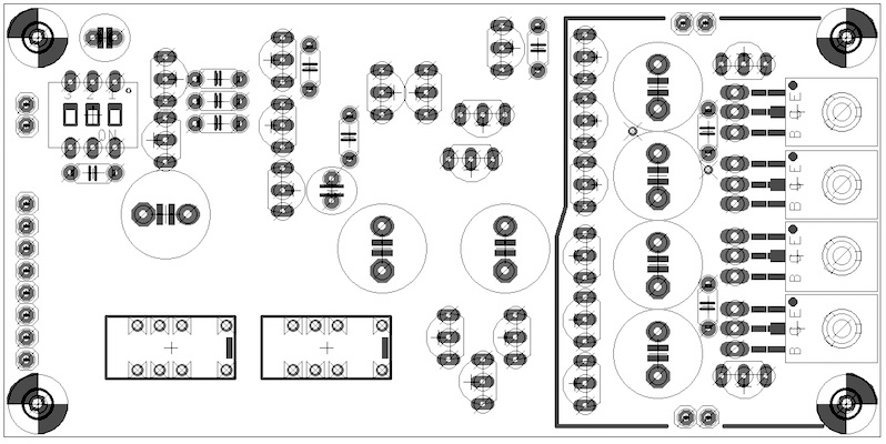

Board#1 Layout

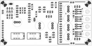

Well I do think I can squeeze the phono and gain stage on the first board. All the inputs will come to this board.
The regulator is 'partitioned off' on the right hand side. It's tight in there based on an initial go at routing this circuit. In general, impedances are kept low throughout the regulator which I think will make it less sensitive to parasitics. I'm wonder if it would be a good idea to use a top and bottom ground-plane pour. Outside of the regulator circuitry the board will contain the active signal circuitry.
To the top left are the phono inputs, clear from anything else. The phono amp occupies the left half of the board, followed by the gain stage on the right half. The main signal 'flow' is from left to right, just as you might draw the schematic. However, the output will be wrapped back over to the left hand edge of the board and kept away from the sensitive inputs.
The relays which switch the inputs and their grounds plus associated control circuitry sit at the lower edge of the board. They'll use current to/from the upstream regulator to avoid any pollution of the shunt-regulated rails and signal ground.
I'm going to put the SMD resistors on the 'underside' and the larger through-hole parts on the 'topside'.
OK - t's a bit early, I need to see if I can retain good signal integrity. And the circuit design ain't exactly stable yet. I've not sat back to think about dc-levels and switching 'thumps'; I may need another capacitor in there somewhere.
